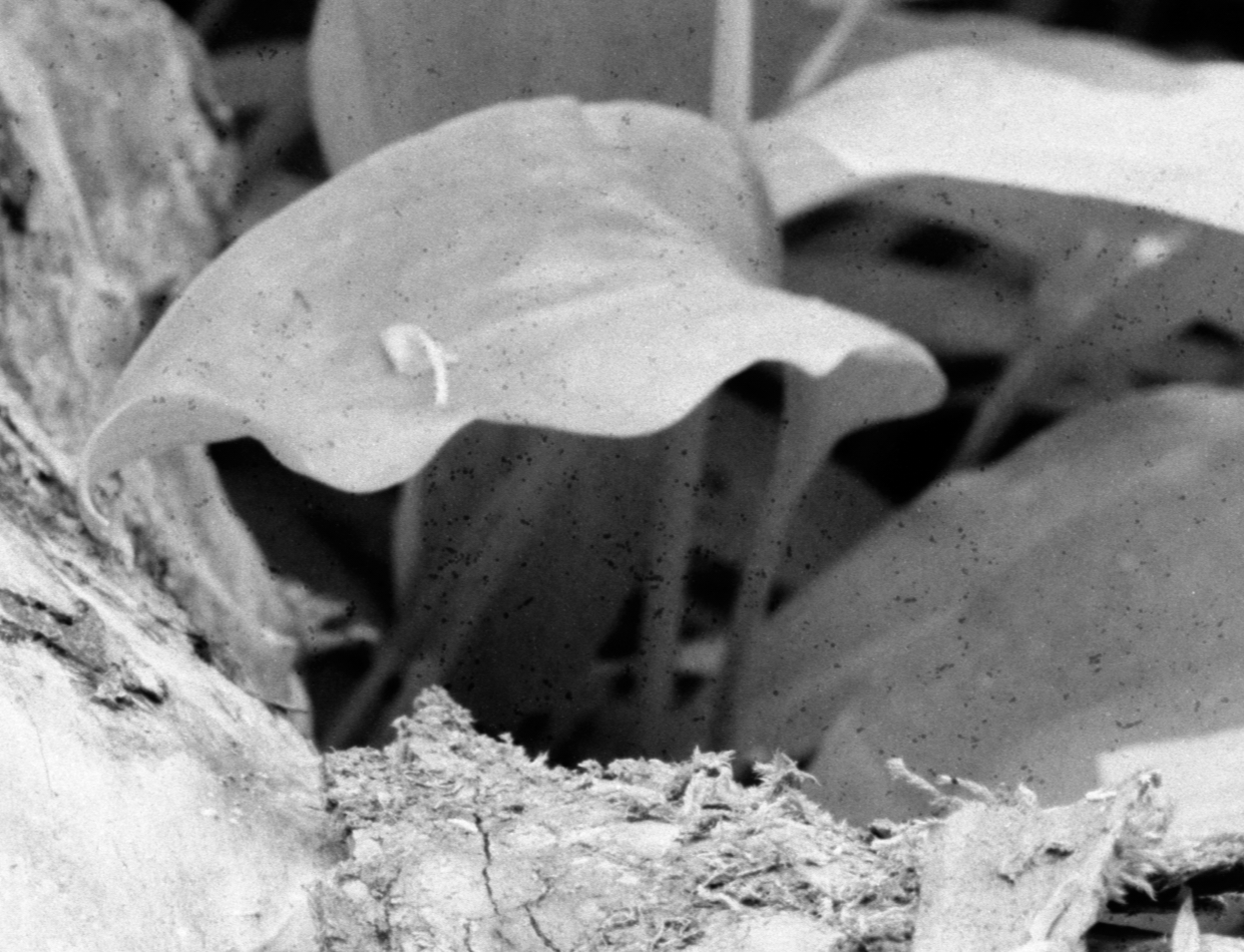

An update this morning I made a 50cm x 50cm print of a 6x6 "not-RPX25" Ortho 25 Plus negative, and discovered there is more of an issue here than a confectioning error. Emulsion defects appear, see the image I've attached taken from a film scan of the negative. It looks as though the emulsion hasn't been properly applied. These defects also occur on the first film I tried, mentioned above.

Emulsion missing would yield max. density in positive.
Coating defects would look differently.

I'm not sure how storage and processing problems would relate to what I've found with the 'Rollei Ortho 25 Plus' film, but then that may not be produced by Agfa, who knows...
