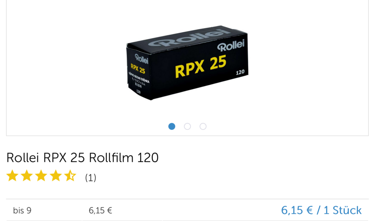

To be clear Macro are not pricing the film as a "budget" product: https://www.macodirect.de/en/film/black-white-films/1859/rollei-rpx-25-roll-film-120. - €6.15 vs €3.75 for Fomapan 100 '120'.
That is also my best point concerning any issues of quality!

looking at the todays pricing for "original" RPX25 Tom Kershaw ordered :
I am getting dizzy:sick:!
