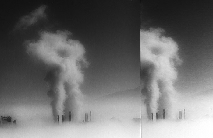

Les, Peter is not having a problem with Ilford, I am. Peter is having a problem with Oriental. The problem that I am having looks exactly like the images that Peter posted. I have never seen anything like it, but it affects 6 different emulsions. I have 3 shows to print for, the soonest to be delivered in less than a month. As of right now I have no workable paper. I have thrice emailed the us-techsupprt@ilford.com, they have yet to reply. Is this the wrong email?

Here is an example of the problem I am having. These are just crude test prints so please no comments about the technicals. The main difference between the 2 images is that one sheet of paper was turned 90 degrees and the pattern turned with the paper, showing that it is the paper that is the source of the problem.

Les, I didn't post this as a "knock Ilford" post. Believe me when I say I have wanted Ilford to do well. I have standardized all of my printing for use of Ilford paper and now that I am obligated to hang several shows I find that Ilford has left me out to dry. Did you look at the image I posted? I sincerely appreciate your help with this, but I have to admit feeling seriously screwed right now and I'm pretty pissed at Ilford for putting me in this position.

More testing today, add another emulsion # to the list of defective Ilford Multigrade IV FB glossy papers, this paper purchased from Calumet.
03a70?c08 (11x14) the question mark is because the numbers are rubbed off and hard to read. Add that to these emulsions:
11x14; 05b701c93, 02c702c42, 92c701c09
16x20; 80a701c09
20x24; 03d702c83, 84b701c19
That makes 7 different Ilford emulsions that are defective, purchased from 2 different sources.

Gainer, I know there are a lot of posts here to read but if you look at my posts you'll see that I also did the testing with the optical system nulled and made purely into a source of grade 5 light with the same outcome.
The methods that I use to print are identical to what I have done for several years, split printing, high contrast grades, same lenses and enlarger, same water, same chemicals, same safelights. I was able to print at grade 4 and 5 perfectly a year ago using Ilford paper. Now I can't. When I use ilford at grade 3 or less, the problem does not appear. I just did a test with Oriental fixed grade 4 and it is perfect. Same test with Bergger VC grade 5 is not perfect but much better than ilfords. I just wonder if a change occurred while ilford was in receivership.
