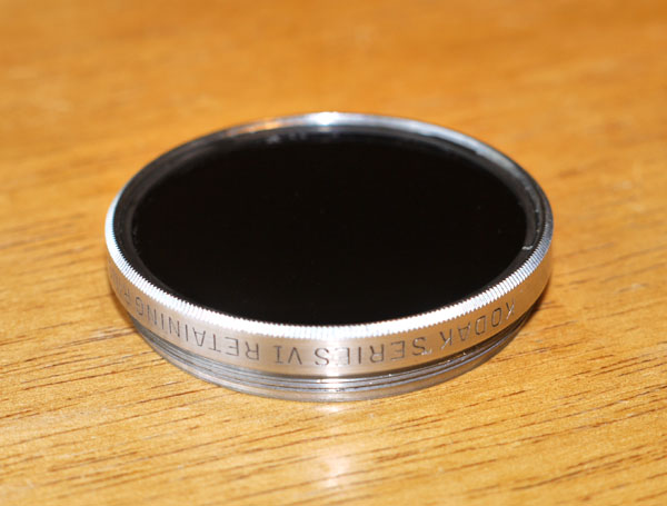

Although I heard that such Series IR filters might have been made, after searching a long time I never did fine one. Consequently, I can't say for sure whether there really are or aren't any out there. But in the mean time I came up with what I think is a really nifty DIY solution; something you might consider yourself. To make a long story short, have a look at this "Series-VI" IR filter, which I put together myself:

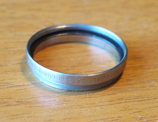

If you look closely, you can see that the body of the filter is actually just a Series VI retaining ring - the double-threaded type to be exact, i.e., one of these:

What I discovered is that the glass element in the 46mm screw-in Hoya filter is just a little bit smaller than the size of its threads (like most are, I suspect), something like 43mm if I remember correctly. And that size turns out to be just right to nest inside the internally-threaded portion of a Series VI retaining ring! You can remove the glass from the Hoya ring easily by just carefully prying out the snap-ring; the glass simply pops right out, nothing else holding it in. In my case since I had a couple extra Series VI retaining rings, it was an easy choice to turn one of them into a dedicated Series-VI IR filter by just adding the Hoya glass. Now all you have to do is place the glass in the retaining ring, and then find a way to hold it in place. For this it occured to me to try the snap-ring from the Hoya assembly, and it turns out that it actually does fit pretty nicely in the threads of the retaining ring. Unfortunately, the glass is tall enough that the snap ring doesn't get quite enough "bite" on the threads of the retainer so it is not really very secure (it can pop off too easily) So what I did was to seat the snap ring as best I could and then stake it in place with some super glue. So far this seems to be holding nicely, and now I have a good modern IR filter in "Series-VI" mount, which I can use on any of my Series-compatible cameras. :smile:

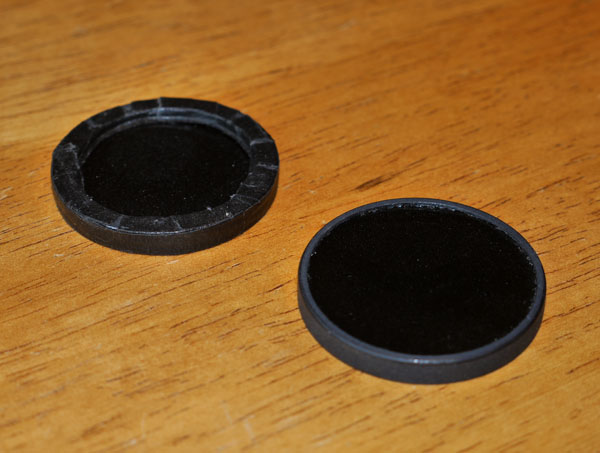

- Before getting an honest-to-goodness R72 filter, I also played around with making IR filters out of E6 slide film, and made a couple of these into Series-VI filters. Here is a picture showing two attempts at that to give you some other ideas. The first attempt (on the left) is in a cardboard or plastic mount (I forget which), while for the newer version (right) I was able to mount the film directly into the metal ring of an actual Series-VI filter from which I had removed the broken glass:

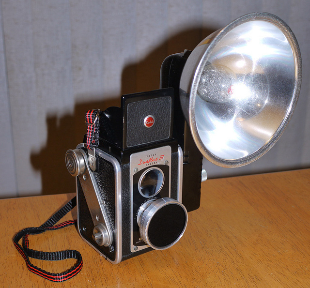

By the way, I find that a lot of older cameras look really cool with an IR filter attached - almost like a person wearing sunglasses. :cool: Here is my Duaflex III for example:
(Actually, Series-V is probably the more appropriate size for this camera, but as I said I am already invested in Series-VI so I used a V-to-VI step-up adapter).
