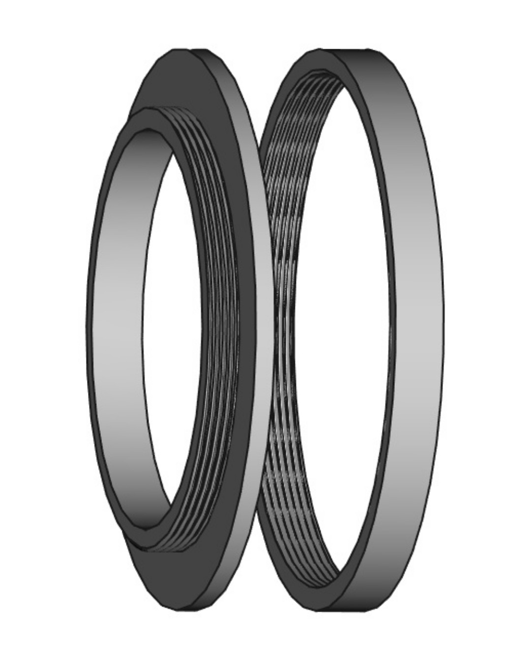

The attached file contains the 2 gcodes to print an adapter that fits 52mm filters on your Speed Graphic or other camera accepting the series 6 filter size. These are gcodes only, which I sliced in Cura for Ender 3, altough they will likely work on other printers, as these 2 items are placed in the center of the platen. ABS ONLY. 90% infill. I discovered that PLA and ABS required a modification of the thread sizes, due to shrinkage, etc. And taking your camera out in the hot summer sun with a PLA adapter would mean certain warping. The items print separately. When gluing the ring to the adapter, glue the print bed side down. Never try to screw a filter into a ring on the print bed edge, as the first layers "squish out". I would have liked to include my original Freecad and stl files, but this site has a meager 2 meg limit per post.
Edi: IMPORTANT. Use .2mm nozzle. The .4mm fhat comes stock on printers will likely not work.
