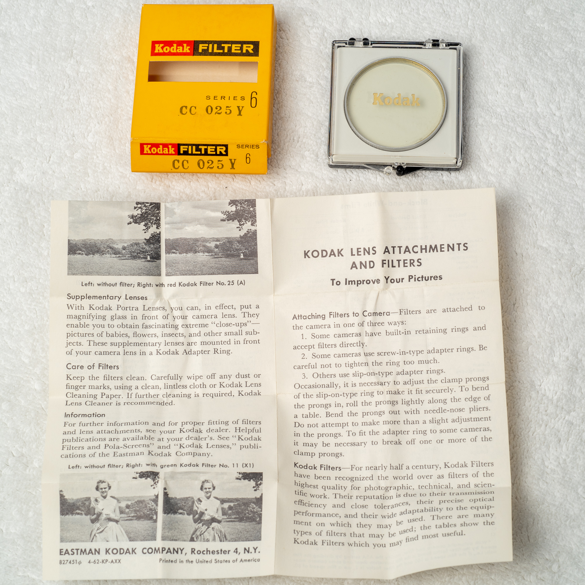

Does anyone recognize this filter?
Does anyone still shoot with the equipment that uses these?
I stumbled on a box of them at an antique dealer (i'm using that expression generously).
Series filters are still used in older cameras which were built before threaded filters and quite common for large format lenses.

Interesting. Thanks. Well, I dragged home a box of them, brand new in their little boxes. I might have about 60 - 75 of them. Some of the adapters you mentioned. Both B&W and Color...
I'll have to make a spreadsheet with the types, quantity, etc... I'll post'm up in the classified once I get them all catalogued.
