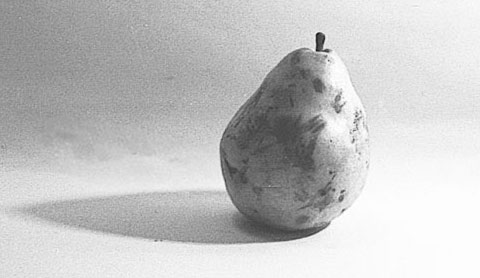

This is a scan from a 1940s Isopan F neg I mentioned earlier. Exposed then developed the next day. Developed in D76. To give you a very rough idea of grain etc. Leica Summitar with "Pleasant Auto Up" aux close up lens.
