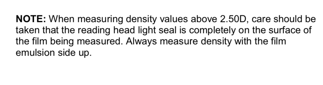

Emulsion side up.
Jan 7, 2005
2,699
Los Angeles
And another question that I don’t find answer in Xrite 331 densitometer. Emulsion down or up?
thank you
