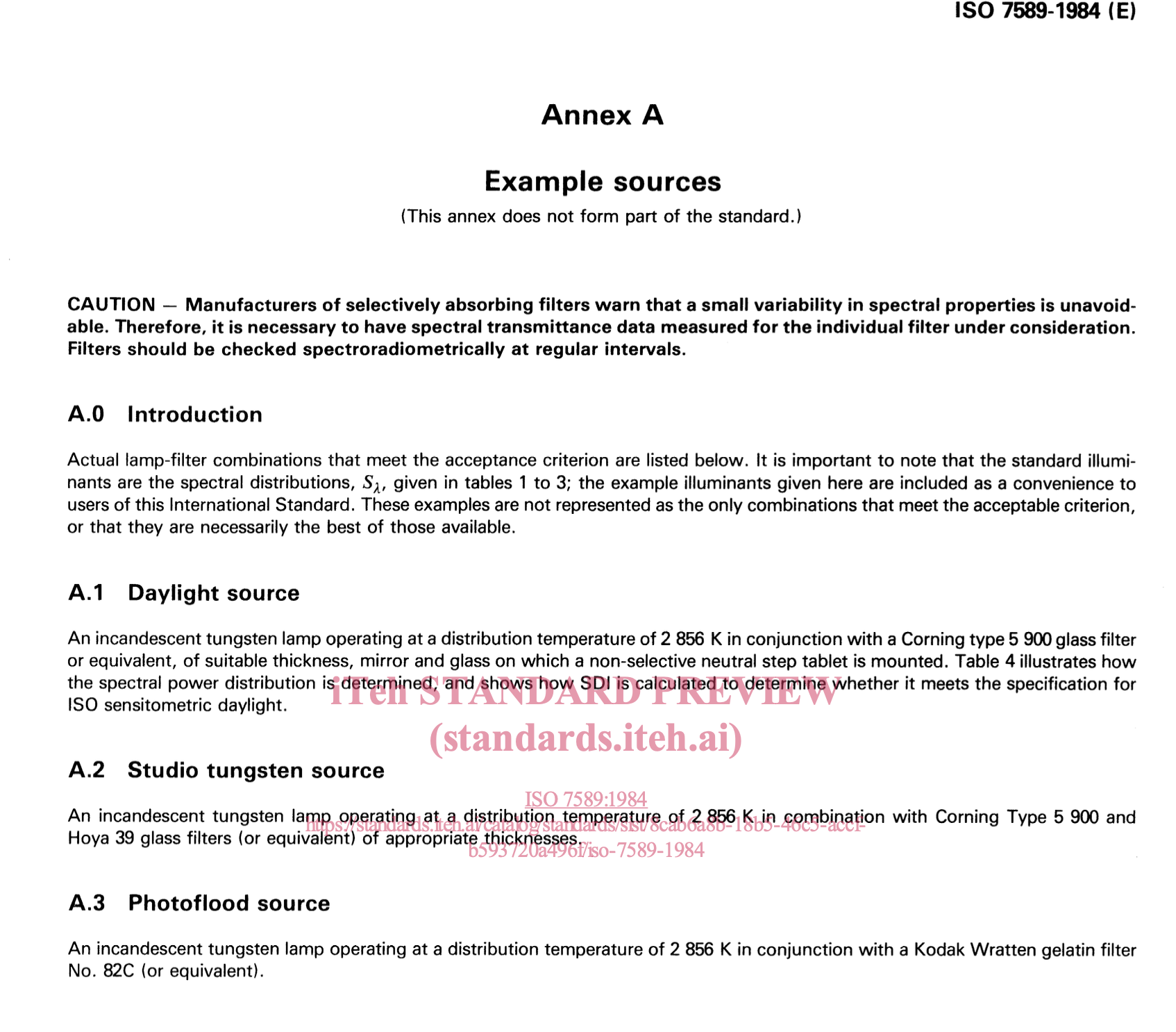

could you go into a bit more detail on how to create an ISO sensitometric daylight source? Is it a simple process? For B&W, I am sure it's not too critical, is it?
A xenon flash is probably the best bet for a homemade sensitometer. Otherwise, with a tungsten filament, a shutter may be required, like the Wejex sensitometer uses.
There are multiple choices for light source, all with advantages and disadvantages. Personally I'd just get a sensitometer off ebay for a few dollars. (which I have done and tested against standards like the EG&G and Wejex.)

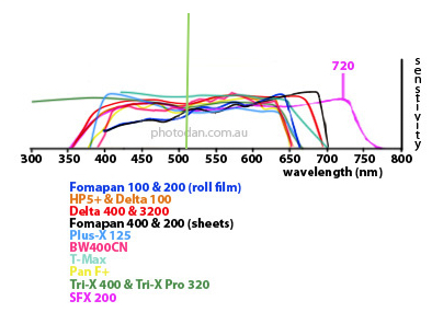

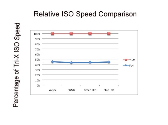

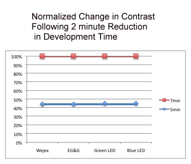

BLUE/GREEN senstiometers work just fine for comparing conventional photography film in a conventional darkroom. Green sensitometer peak indicated by the green line.
film-spectral-sensitivity-copy-jpg.274146
speed-results-jpg.263236
results2-jpg.263237
results2-jpg.263237
Dear Ic,
I saw this in the other threads and this is fine when comparing. But it should be an issue when doing speed tests, no?

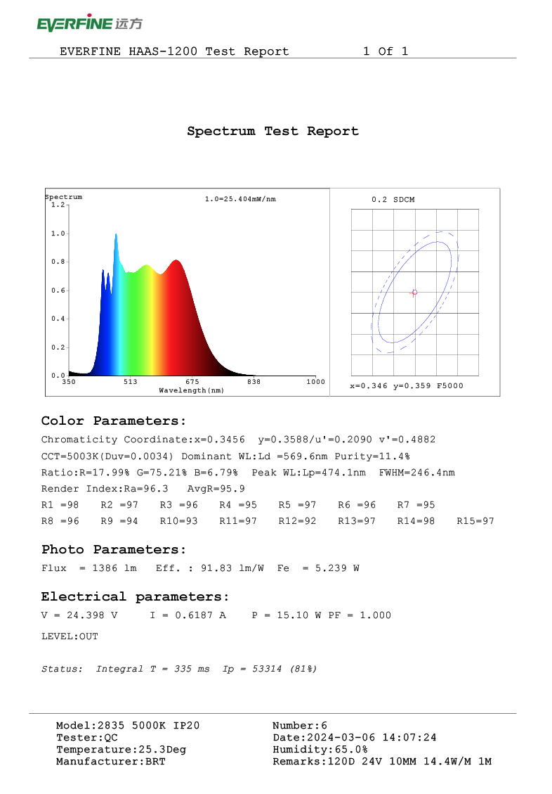

These LEDs I found seem very promising. Do you by any chance know if the CIE 50 or 65 norm is in any way similar or comparable to the standard light source for sensitometry?
Attached is a picture of spectral data from the before mentioned LED.
I am, no expert and half as smart as most people on this forum, my question stems from a lack of knowledge. I would just like to know if I can build a decent sensitometer with a modern white light LED source.
I'd be grateful for an answer from you Derek since I value your opinion on this! All the best! René
