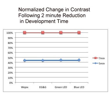

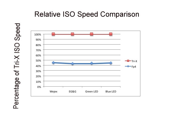

I looked on eBay and only see sensitometers designed for blue and/or green sensitive x-ray film. That doesn't seem useful for pan-chromatic film? Can you point me to any example device that has a daylight balanced light source?
ic-racer
ic-racer
Feb 25, 2007
16,542
USA

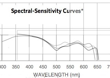

Color of light source does not change the film's ability to respond to changes in development. Most panchromatic films for which spectral sensitivity is reported have similar same sensitivity to green, blue or red. You can see in the composite below.

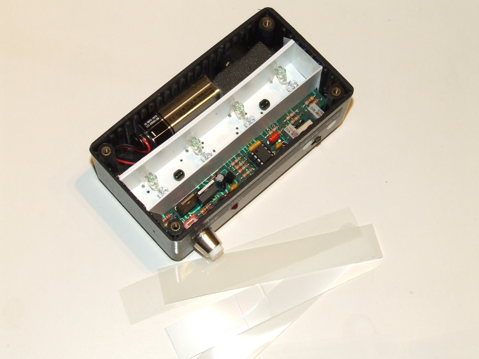

Having reported that, I don't see why the LEDS in a Green or Blue sensitometer could not be swapped for white if it would make one sleep better. It may be an interesting project (though maybe not needed if only comparing films of similar spectral sensitivity)
