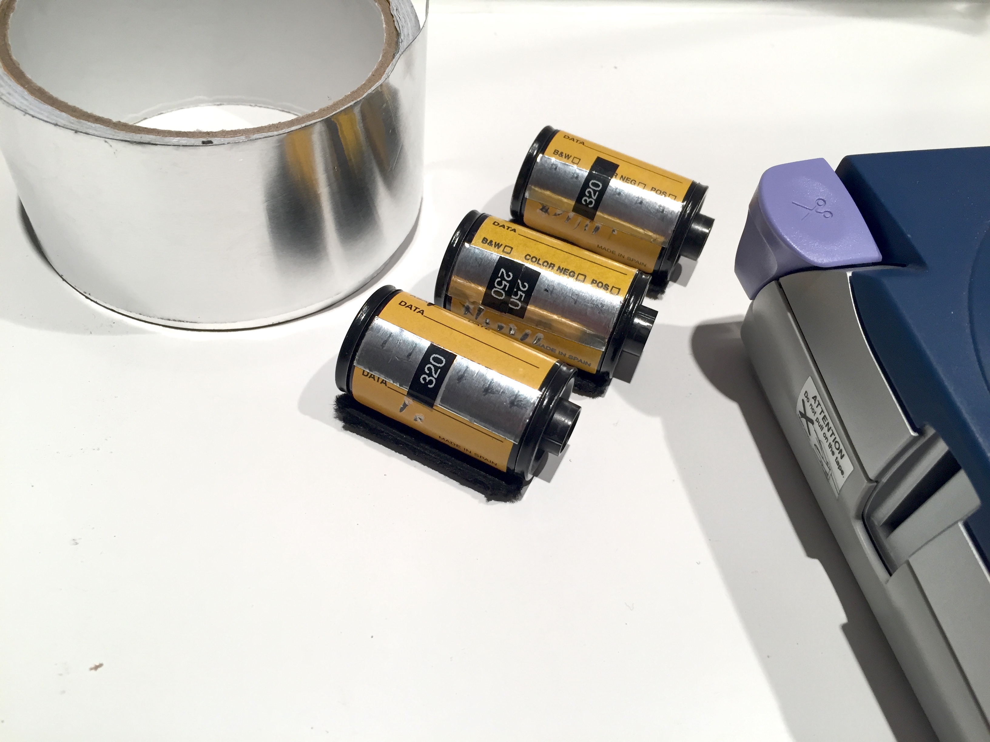

So, to test the Matrix cameras in Matrix mode (F100, F6, N80, N75, N55) which are not expecting all the zones to be equally illuminated with a test source, I made up some DX cassettes of varying exposure index and just took pictures (about 200ft HP5 over a couple years).
Indeed the 250 negatives look a little too dense to my eye with HP5 on these cameras in Matrix mode.
It is not hard to imagine what happend next, I just started using 400 on all cameras, irrespective of metering mode, even though for 40 years I NEVER exposed ISO 400 film with a 400 EI.
It's so funny that you went the opposite way from me but arrived at the same point. I was so disappointed with thin negatives at 400 in the ES-II and OM-4 that I got into all this sensitometry and put the cameras at 250 based on the convoluted stories we've told each other.
And it's not just that ZS is 2/3 stop less than ISO.
I set the camera to 250 for intentionally denser average negatives, insurance so to speak.
