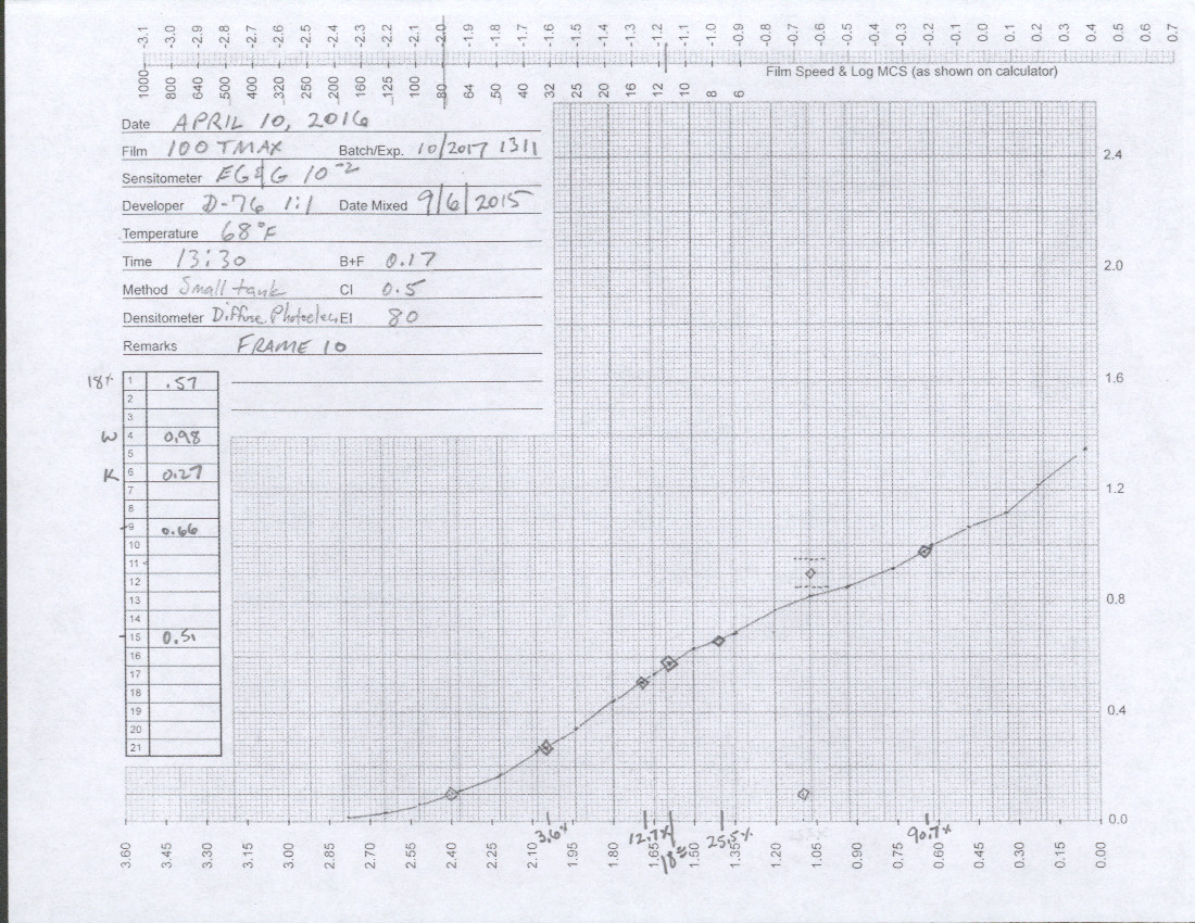

I made some modifications to my film H&D curve analyzing spreadsheet. The idea is to find out how the set the ISO/ASA dial on the camera. Isn't that the question we all want to know?
In the camera, a series of exposures at Zone I are made with various exposure index settings of the camera's ISO/ASA dial. For example 400, 320, 250, 200, etc.
There are hundreds of ways to do this. In this test I metered at EV9 on a calibrated light source and exposed at the EV5 setting on the light source.
This data was then graphically superimposed over the density readings from a sensitometer exposure on the same strip of film. The in-camera data is represented by the GREEN circles.
The "Estimated Sensitometer Millilux-sec Output" is tweaked until the two curves are aligned.

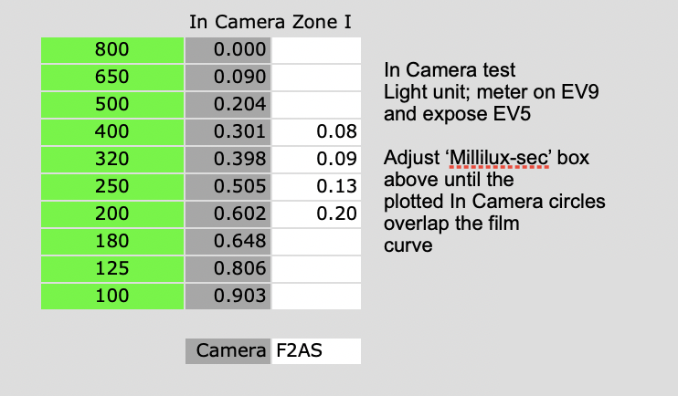

I added these extra cells to the spread sheet. The green column of Exposure Indexes (800, 650, etc) are converted to millilux seconds for plotting with the H&D curve (gray column).
The white column contains the log density readings from the processed film.

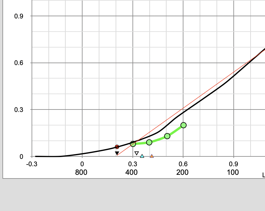

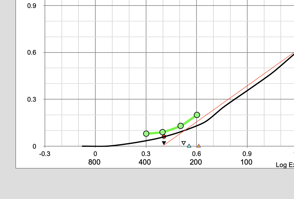

The green, in-camera data, does not align with the sensitometer data. The "Estimated Millilux-sec" output of the sensitometer is not matching the film camera's meter/shutter/diaphragm response. The sensitometer's H&D curve needs to be shifted to the left. Simple addition and subtraction due to the fact the millilux-sec scale is a log scale.
ic-racer
ic-racer
Feb 25, 2007
16,693
USA

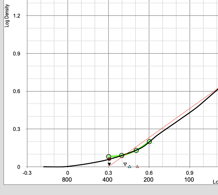

Again, here the data are not aligned. The H&D curve needs to be shifted to the right. Again, in my spreadsheet I'm altering my "Estimated Millilux-sec" sensitometer output value to do this.

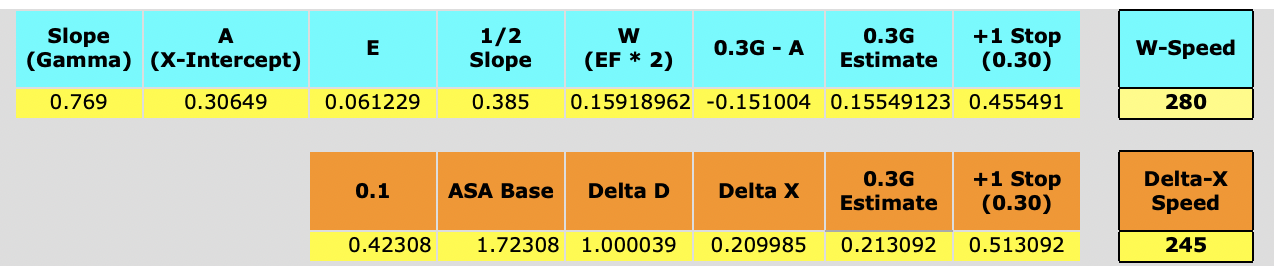

Now the two curves (black and green) are overlapping. In this case I can read off the calculated exposure index from the spreadsheet for my HP5 sample:
X-intercept based speed (W-Speed) = 280
Fixed Density based speed (Delta-X) = 245

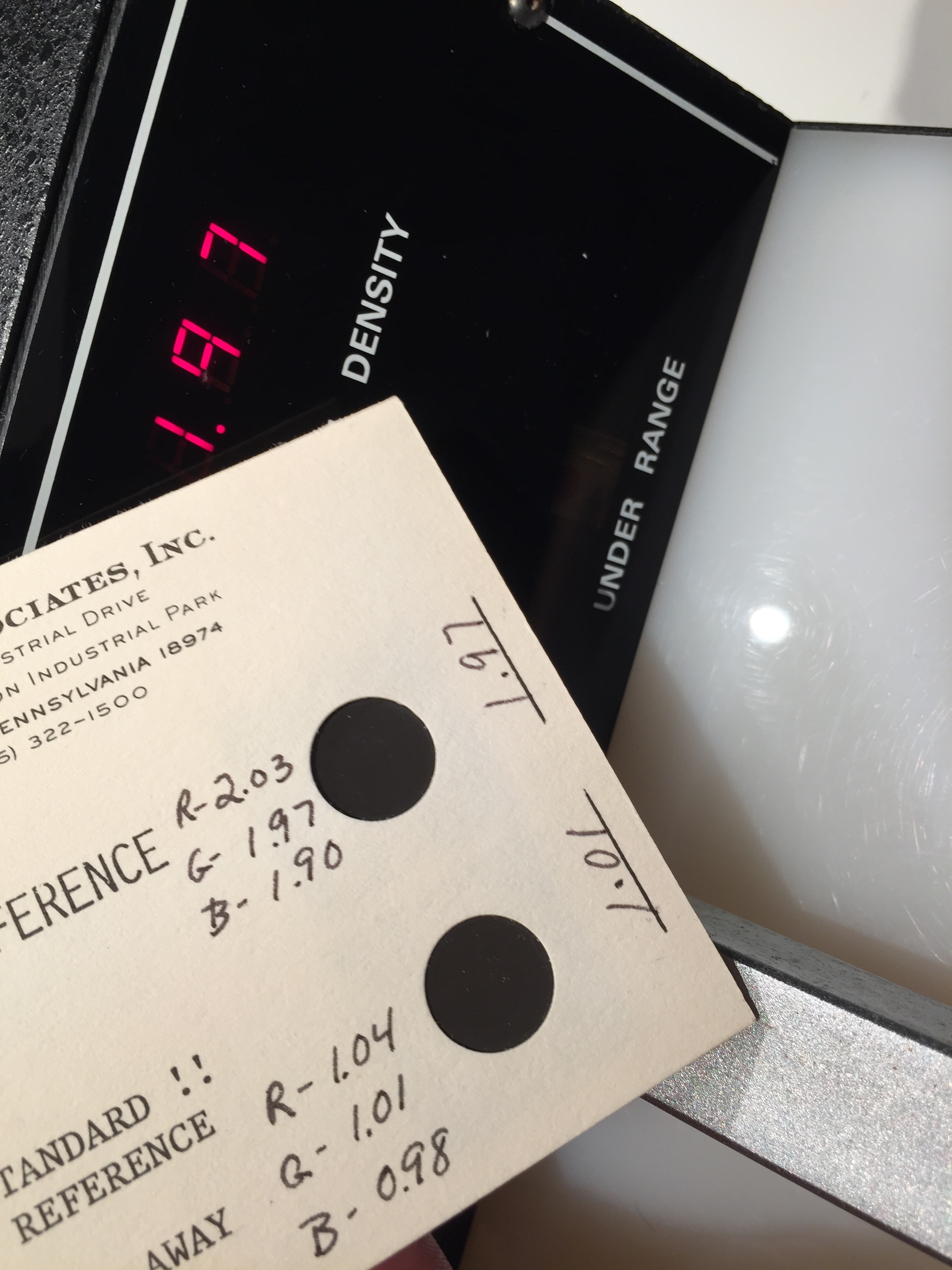

No variability that I can detect in my densitometer. Redings are rock solid. That, and the step wedges are probably the most stable components of the system.
Light meter test comforms to ISO 2720. Though rather an use the Ammonium cobalt sulphate hexhydrate and coper sulphate pentahydrate filter, I'm using off the shelf 80A filters.

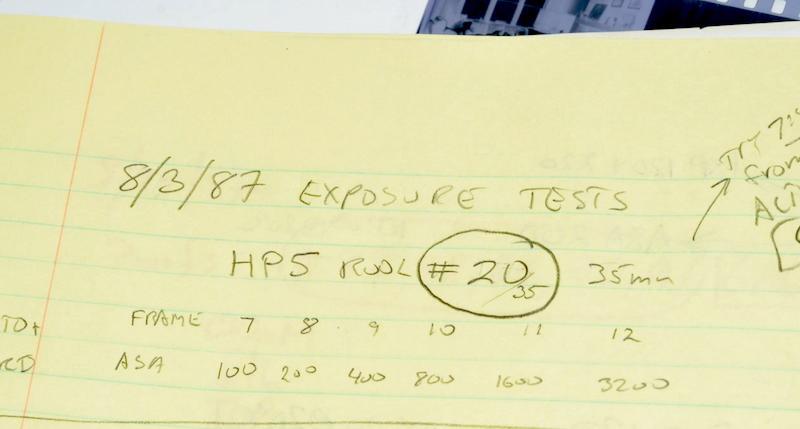

What was the most direct connection between my well exposed negatives of 70s, 80s, 90s? It was using the zone I = 0.1 criteria. So I just tried shifting everything else around that.

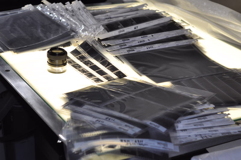

More of the back story: I'm way behind in printing. Looks like some time around 3-5 years ago negatives go thin. Probably same time I gave up on "New T-max" and shifted totally to HP5 exposing at 400.
