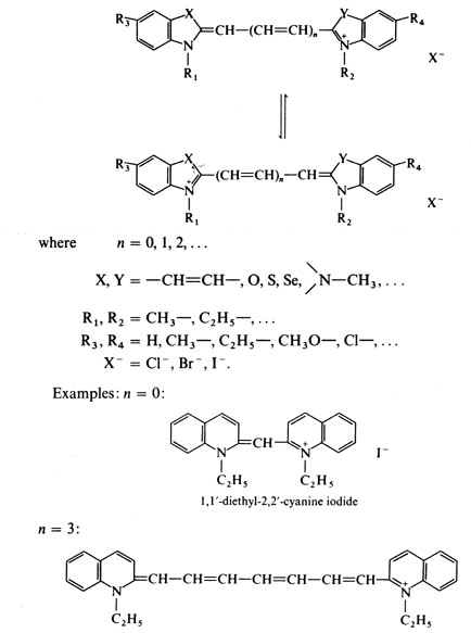

Hello,
I would be very interested in a complete description of how the sensitizing dyes work. Is there a specific mechanism that they all use?

Ben;
I have posted a list of sensitizing dyes sold by EK from years ago, elsewhere in this forum.
Here is the generic structure of one modern class and some results.
Genearlly, they adsorb to the surface or make an actual salt with Silver. Sometimes they can do both.
I hope that this is not too much organic chemistry for you. :smile:
PE

Ron;
I actually know quite a bit of organic, and I was looking looking for a more clear answer. If I had to guess, the resonance structure of those molecules absorbs some of the light outside the spectra of AgX sensitivity. Erythrosine is interesting because it has a nucleophillically substituted I, which probably affects the sensitivity range. It might be interesting to look at t e analogous molecule with an H instead.

Ben, the bottom line is that sensitizing dyes look very much like the dyes that sensitize human eyes to color, but they have an ionic tail end instead of a fatty tail end. The fatty tail end on human dyes help them adsorb on the receptor cells in the eye and the ionic tail ends help the sensizing dyes adsorb on the surface of the grain.
The dyes do indeed absorb light outside of silver halide sensitivity which is primarily UV-Blue. So a Green sensitizer is Magenta in color (Erythrosine is a vivid Red-Magenta), and all of these dyes have huge molar absorption values. But, there is more to it than that. There is redox potential of the dye. The dye must transfer energy so being colored and adsorbing is not enough! If no energy is transferred then the dye is useless.
