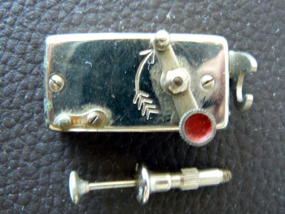

Hello guys. I'm new in analog photography, so I have a question about self-timer for camera. I don't have a timer on my Revue, but I have found one for 7 dollars, and I want to order it. Here's a photo of it. My question is, maybe silly, but are those pins that are screwed on camera button universal? Will it fit? Probably will, but I need to check with professionals :cool:
Camera is Revueflex SC2 (similar
as Chinon CM4)
Camera is Revueflex SC2 (similarView attachment 223852 as Chinon CM4)
The tapered thread in your photo is the most common. Exceptions are cameras in which a ring around the shutter button is unscrewed - and promptly lost! - and then a threaded "cup" with the cable release or such is attached so that the pin of the cable release or self timer depresses the shutter button. Leica is the best - worst! - example of this latter sort. Check your camera. If the shutter release has a threaded hole your timer should work.
The model you got to my understanding came on its own; it was made to be used together with a standard cable release. The thing you got as accessory is a cable release without cable, so to say. First time I see such... By this you can mount your model of self release directly on top of your camera.
That stubby cable release would be nice on my Rolleicord Vb...
Yeah, it looks like that... But I'm worried is it going to be too heavy for shutter button? Tbh, it looks better this way, without cable :smile:
If you are afraid of the load the self-release will put on the the release button of your camera, use instead a cable release inbetween. By this you can hang up the self release at the camera body or tripod by means of rubber band.
Do note that some add-on self timers allow adjustment of the stroke of the shutter plunger. Probably a good idea.

I use these mechanical timers on various old cameras including LF lenses, Leica IIIC and Bronica ETRSI.
The adjustable stroke is a must have feature.
Only more advance models have such, not the OP's one.
Actually, the one I linked to has that feature.

Yeah, I'm afraid of weight of the timer... It might activate shutter button with its weight. So I ordered timer and cable instead of that short plug. I think it's Autoknips timer. It was a shame not to get it for 7 dollars with cable ☺️ I will let you know guys if everything works when it arrives. Thank you all!
These self timers are very light in weight and will not actuate the shutter with their minuscule weight.
You did well.
