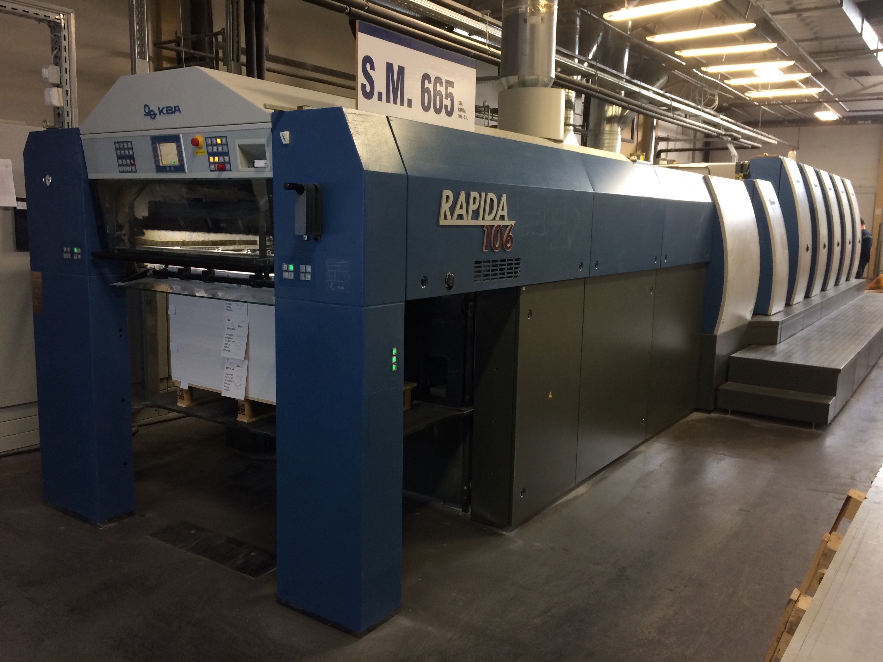

Have just spent a long day on press yesterday for a self published photobook I'm producing of a collaborative project involving 56 photographers from 14 countries. And a large collection of outdated and discarded photographic paper!
https://www.indiegogo.com/projects/obsolete-discontinued#/
it was a fascinating day learning what can be done on press with offset litho and a good print operator.
Currently crowdfunding before publication and an exhibition in London next month. Anyone know if it's OK to make a general post on Photrio to promote it or is that too much like self publicity?
It makes my Epson printer look a bit small!
