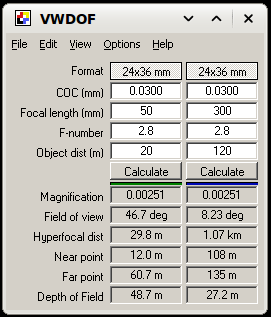

Doesn't hold. Here's a 50mm and 100mm comparison, both at 25mm aperture diameter (f:2 and f:4 respectively), both at 0.0101 magnification and same CoC on 35mm film. Same formulae and results as DoFMaster. DoF doesn't match between images.
That's a different comparison. We both maintain same framing with different focal lengths, but I vary film size and keep subject distance the same, whereas you keep film size constant and change subject distance. In your case the COC has to stay the same for same DOF, whereas in my case COC must scale with frame size. In your case aperture number determines DOF (i.e. a 50mm lens at F/2.8 will have same DOF as a 300mm lens at F/2.8). In my case you must keep aperture diameter the same to maintain DOF (50mm F/1.4 on 35mm film has same DOF as 110mm F/2.8 on 6x7 film).
To add further to your confusion: in your case (constant film size) the 50/2.8 will have the same DOF as a 300/2.8, but far distance points will blur much more with the 300/2.8. It all boils down to the old saying: a COC is a bunch of photographers discussing about DOF :D

Below is an example of the first case you've given above. Claiming that a 300 f:2.8 has the same DoF as a 50 f:2.8 at the same magnification. It doesn't.
Your take often appears close enough to be valid at close distances, but doesn't hold at further distances. Read the Ctein article I linked to and run some examples.
