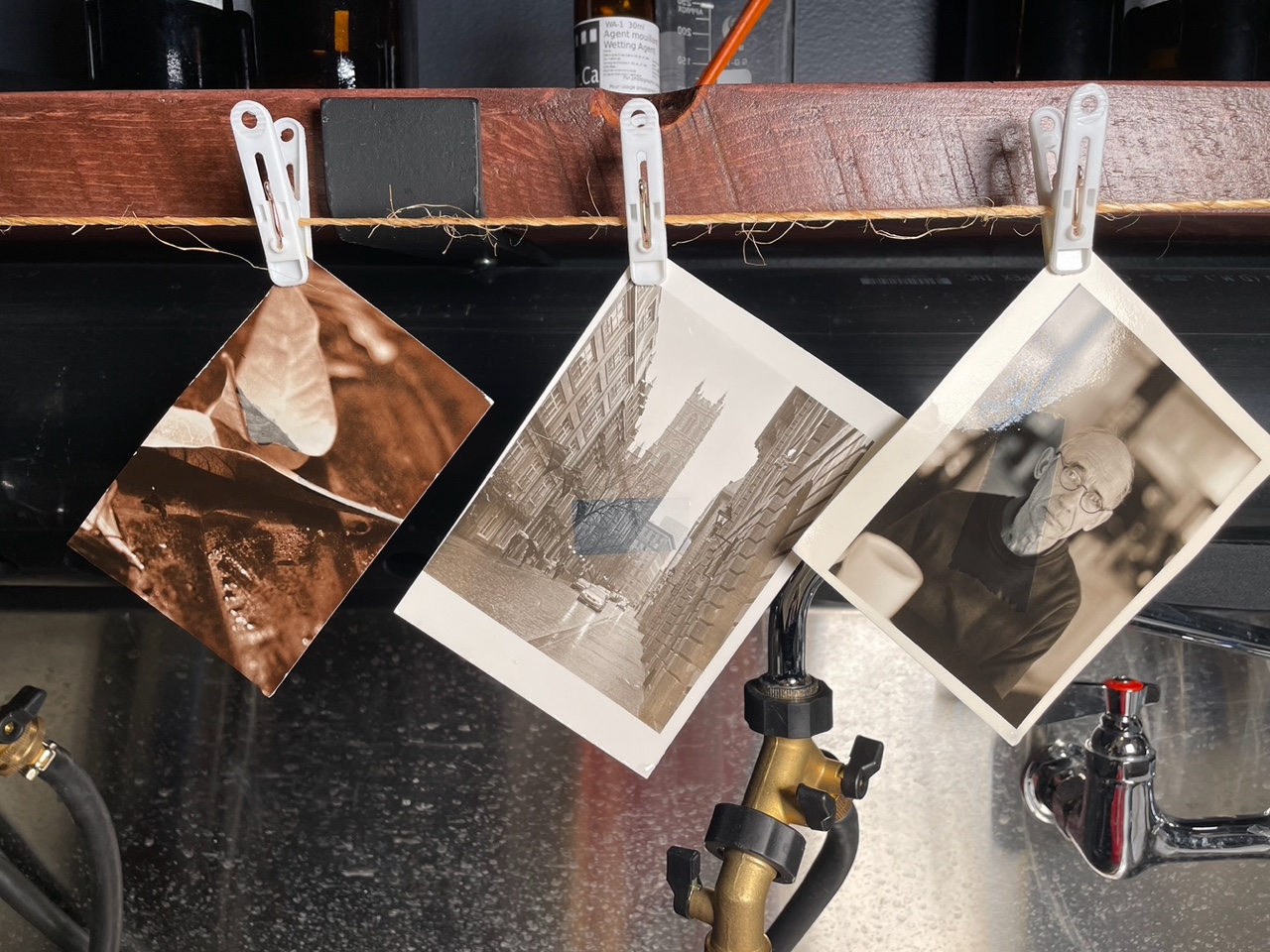

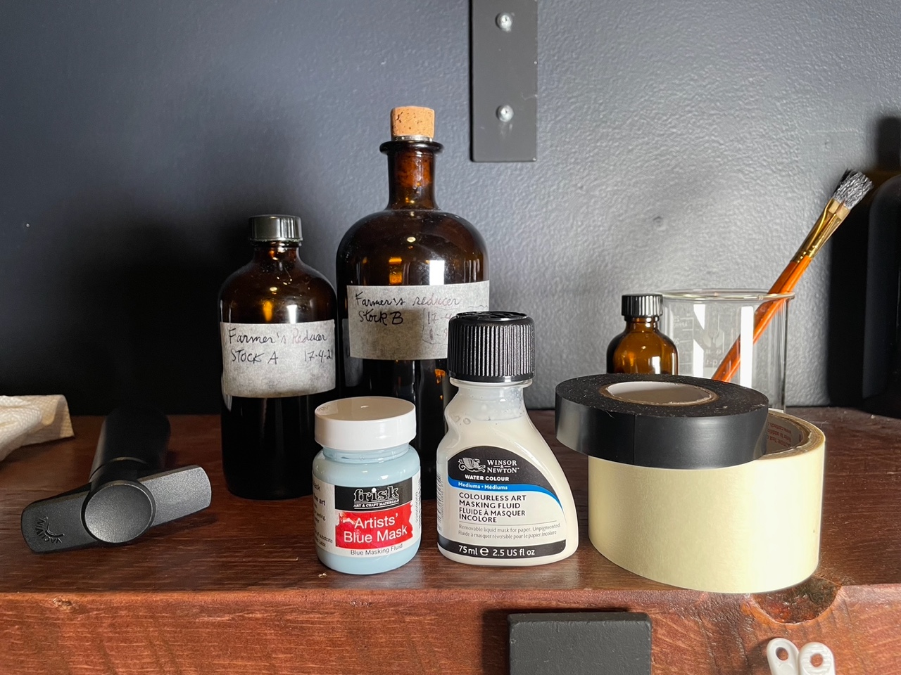

@pentaxuser Here is a picture of the products, as well as the stained prints. The products are almost new. I usually selectively bleach or tone with a brush but yes it is my first attempt at selective masking for a bleach. The bleach I usually use is Farmer's reducer (recipe from Anchell's Cookbook) but sometimes I just trow a teaspoon of ferricyanide in a liter of water and that is what I did in this instance. I applied the masking fluid, waited for it to dry (took maybe 5 minutes) and then bleached for a couple minutes.
@koraks I was very hopeful after reading your reply and I tried it first thing this morning. Unfortunately it didn't work. The picture below was taken after the attempt at the sodium carbonate. I had an oldish 500ml bottle of 10% sodium carbonate lying around. When I saw it wasn't working I added 4 teaspoon of sodium carbonate but to no avail.
From left to right: colourless masking fluid, electric tape, and masking tape.

I know koraks said that, but ferricynide will not make Prussian blue on its own even in acidic medium without the Fe(II) counter-ion. With the carbonate treatment - at 10%, it should have disappeared instantly if it was cyanotype-like residue.
Looking at your pictures, it looks to me that the prints are also sepia-toned. Is this before you are bleaching or after. The zones where you applied the masks seem more neutral to me than Prussian blue. If you are using straight ferricynide, you also have to fix the print afterwards to remove the silver ferrocynide formed as a result (Farmer's reducer contains thiosulfate to do the job.)

Here's something of a longshot by way of a solution. When I googled masking fluid all I could find was masking fluid for painting so is there any chance that your masking fluid is not as impermeable as it needs to be for bleaching?
I recall seeing a video by an Ilford Master Printer called Dave Butcher in which he describes his latex fluid as completely impermeable when dry and he uses it for selective bleaching and toning. It's called Fotospeed MK50 Masking Fluid. It requires that you use Fotospeed MKS Brush Cleaner for the brush which indicates its nature If you can clean your brush with ordinary water this may indicated that the masking fluid isn't right for selective bleaching

In answer to your queries, the leftmost print is Fomatone 131 toned in Selenium 1+3 for 2 minutes. That paper gives a purplish brown with a strong selenium dip, mostly brown at some point. The middle print is Ilford Cooltone and I think I didn't tone it but I am not sure anymore as it does look warm (maybe the developer). The print to the right is Adox semi-matt and that one I am sure was not toned. I fixed it for a minute and took another picture that I attached here. If you compare to the one above you clearly see there is no difference in tone anymore, it's just darker where it was masked. So you obviously nailed it with that comment:
"If you are using straight ferricyanide, you also have to fix the print afterwards to remove the silver ferrocyanide formed as a result"
I guess I have been a bit sloppy this time around. I should have remembered that it was not a good idea to bleach locally after toning. As for fixing, I am usually more methodical but these were test that were to end in the trash bin anyway so I didn't fix after the bleach and I didn't know it could have that consequence (formation of silver ferrocyanide). You were also right that the masked parts were not blue after all but neutral bluish. The contrast with the brown of the rest of the picture gave me that wrong impression. Also the first time I tried I used the blue masking liquid so it was easy to jump to the conclusion that there was a blue stain from it and then the idea of the blue patch stuck with me.

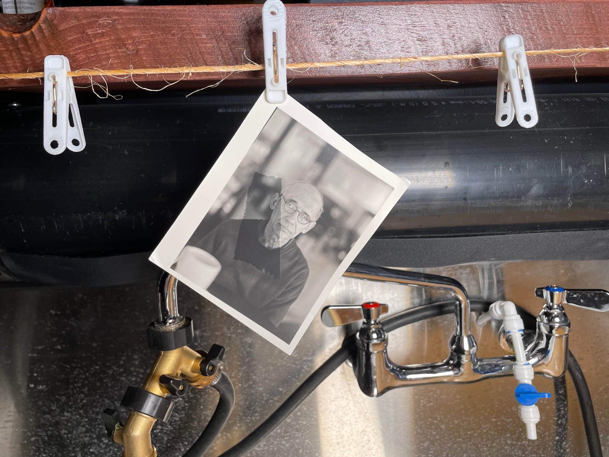

As a side note, the bleach has an interesting cooling effect on the very warm Fomatone paper. Much more so the raw ferricyanide bleach than Farmer's reducer. It doesn't make it as neutral as Ilford Classic as there is a cream paper base anyway but much more neutral than without the bleach.

The problem was not exactly what it seemed to be. The masked part gave the impression it was blue stained but it was in fact neutral-bluish. I bleached in a plain ferricyanide bath and I removed the mask after a quick dip in the fixer. Proper fixing after the bleach (with the mask removed) eliminates the silver ferricyanide that was formed and the bluish tint of the previously masked part.
It really did solve the problem but one thing still seems a bit odd to me. You would think that if the bleach has this effect on the masked part it would also partly bleach the masked part and also that is the bleach reaches the masked part (through the paper?) the fix also would and that the problem would not have occurred in the first place. So problem solved in practical terms but I am left with some interrogations.
