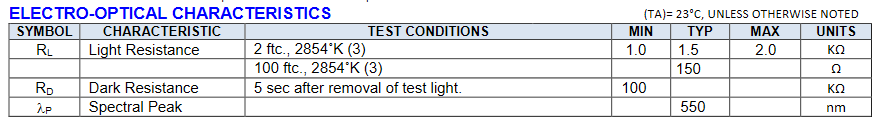

Finding the proper replacement is virtually impossible. While CdS cells have a linear current-voltage relation (at a fixed illumination), the other relation, current versus illumination at constant voltage, is non-linear; generally, doubling the illumination causes less than doubling the current. That is beneficial for lightmeter design, because the dynamic range of light values is compressed and made more manageable. But that extra parameter --the degree of non-linearity-- makes it virtually impossible to find a cell matched to the lightmeter design and scales. As an example, see the datasheet from one of the cells shown in the ink provided by N.Lindan:
You can see that, going from 2ftc to 100ftc illumination, 50 times more, the resistance drops from 1500ohms to 150ohms, just a factor of 10.

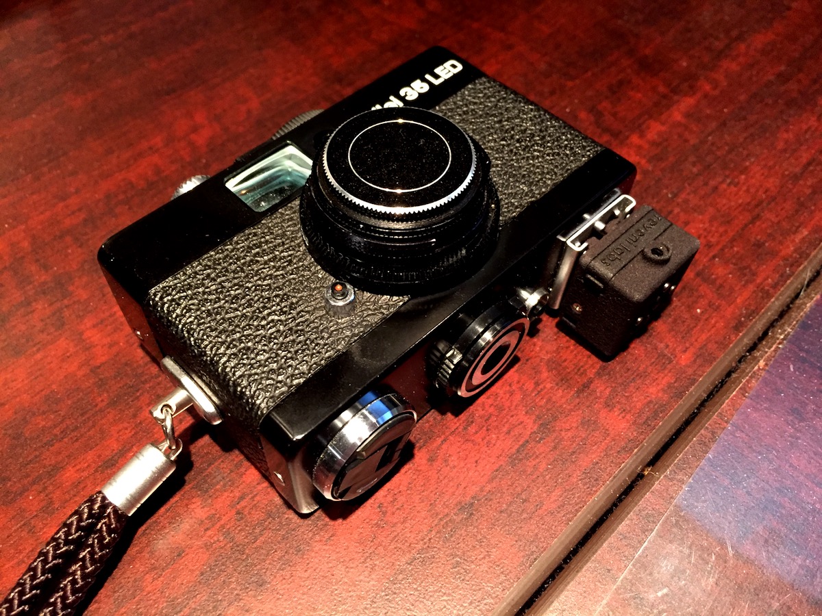

I have the schematic for this Rollie 35 LED camera, and have traced the voltages in the circuit. The CDS cell is faulty. You can see my solution that I recommend highly.
