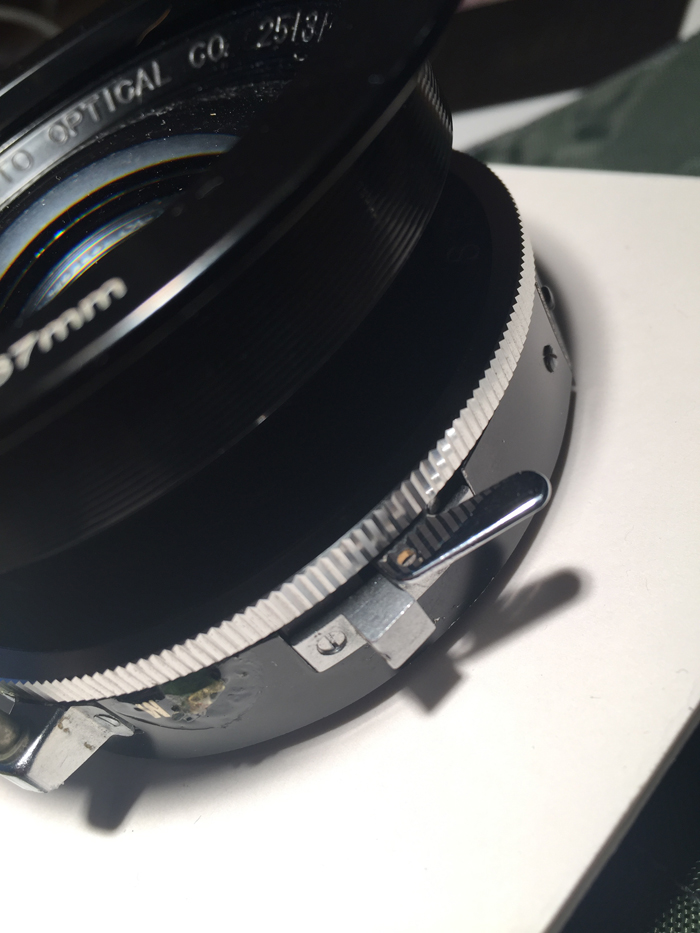

I've discovered that my Fujinon 250 WS 6.7 is unable to be used with a shutter release cable because a small part of the shutter release mechanism has gone missing. The piece which the end of the release cable pushes against and which is attached to the shutter release. It seems to have just decided to drop off somewhere. I'm trying to figure out how to rig up something so I can use the shutter release. Very annoying. Any ideas? I can even recall what the piece would have looked like?
Anyone out there have an old junker shutter of this type who might be willing to sell me this little piece?

Yep, you're probably right John. Hoping that someone might have an old junker for parts. There is a hole in the shutter release lever, where the missing part would be connected to.

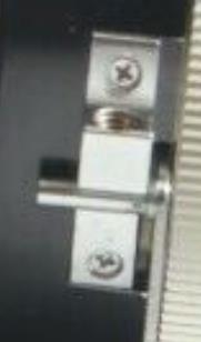

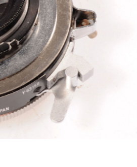

Thanks Shutterfinger. I think this might be from a newer version of this shutter. The one I have has a hole in the shutter lever. The newer version looks to be all one piece.
David
shutterfinger
Feb 25, 2013
5,020
San Jose, Ca.
Then get a length of brass rod that will just fit into the hole or turn a piece down until it will just press in and secure with JB Weld if the inside of the hole is smooth, thread the replacement if the hole is threaded.
