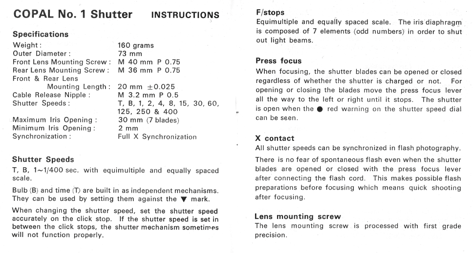

If you have a caliper you can check the mounting screw thread diameters. I have a NIB Copal #1 here's a scan of the specs.
Rimset Compur #1, Ibsor (late versions), Prontor,#1 shutters are all compatible. What that scan doesn't include is the retaining ring is M 39 mm P 0.75. There are Seiko #1 M 46mm P o.75 retaining rings.
If the 80mm cells are not compatible, check with a seller as there may be some variation in Seiko shutter, some #1 were compatible with Compur/Copal.

For reference here are the measurements for a Seiko LF shutter that looks like a #1, versus the standard Copal. This is from the Seiko on my Fujinon 210/5.6, which may not be the same as the Seiko on the GX lens, so measure to be sure. The columns will get messed up when I post this, but the Fuji-Seiko numbers are first and the Copal are second.
I believe the Seikosha shutters on Mamiya Press and TLR lenses are closer to the standard size and you should not expect them to transfer over.
dimension (Fuji)Seiko Copal #1
front thread M42-0.75 M40-0.75
back thread M42-0.75 M36-0.75
thickness ~21.8 mm 20 mm
front to shutter blades ~12.2 mm 10.75 mm
mount thread M46-0.75 M39-0.75
lensboard hole ~48 mm 41.6 mm
iris diam 30 mm 30 mm
body diameter 73 mm 73 mm

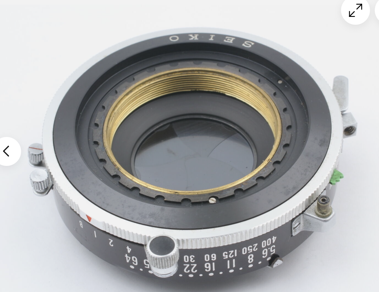

I looked at the Seiko shutters on my Mamiya Press lenses (the later black ones) and on a few Mamiya RB67 lenses (earlier ones) and none of those match. I am not sure about older chrome Mamiya Press or Mamiya C2/3,22/33,220/330 types. I think the kind of Seiko LF shutters that would work would be like this one.

Seiko #0, Seikosha #0 and Copal/Compur #0 shutters are compatible with each other, meaning the lens cells can be mounted freely among these shutters.
Seiko #1 shutters have larger lens cell and flange mounting threads than Copal/Compur #1 shutters. Lens cells from Seiko #1 shutters cannot be mounted in Copal/Compur #1 shutters.
Seiko #1 shutters were mostly used for Fujinon 210mm f/5.6 (single-coated, inside writing) and 250mm f/6.7 lenses. Mamiya RB, Fuji GX680 and Bronica SQ lenses can all be re-mounted in Seiko #1 shutters.
