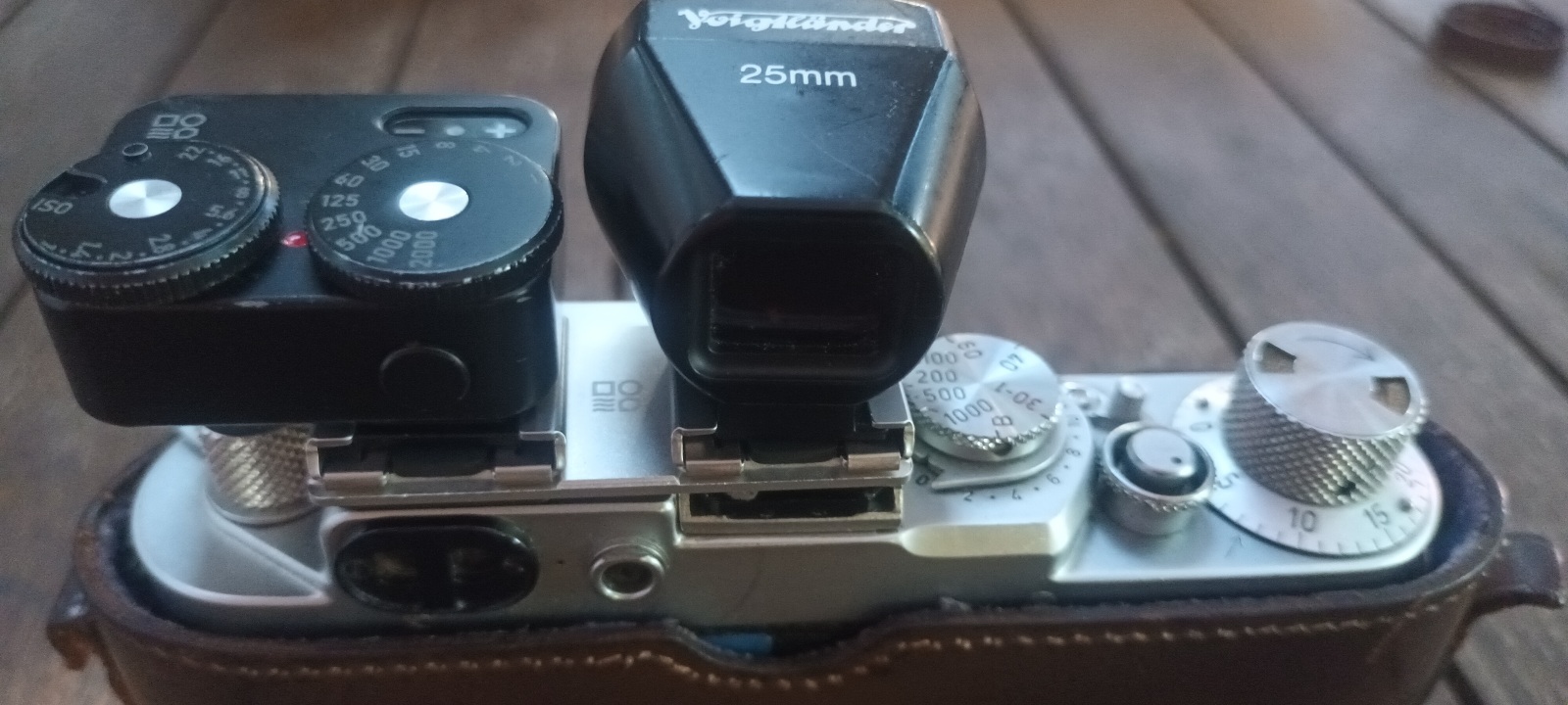

Recently my Leica IIIf was successfully CLA'ed and am feeling I would like to use it more for my traveling and holidays. I have a 35mm Summaron LTM which I like but I have to use an external viewfinder to frame properly. Doing so I have to surrender the cold shoe normally reserved for Voitglander VC meter. I guess I can carry an external light meter while traveling but also want to find out if there others are using a different technique such as using the Barnack cameras with wider focal length than 50mm. Suggestions?

There is that double-cold shoe adapter one could use, I suppose, but they're hard to find these days.
There's not much choice but use a shoe-mounted viewfinder when you have a 35mm lens. The view through the camera is just not adequate. If you have a Leitz universal viewfinder, you could put your meter on top of that ... might start to look a little ridiculous, but it would work.

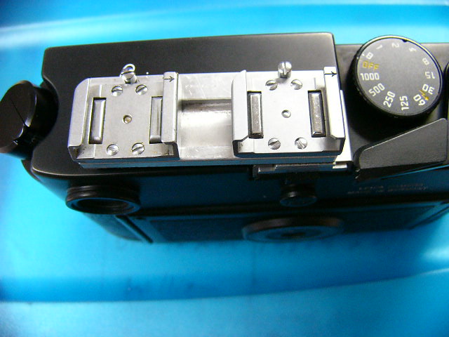

There are/were double shoe adapters on the market at one time. They occasionally show up here or on ebay.
Finder needs to be mounted on camera directly or it will not show correct view.
I use the small unobtrusive Voitlander 35/28 meter on my ltm Leicas. This combo makes a compact easy-to-carry package compared with usual Leitz or Zeiss 35mm finders sitting much higher on camera. When shooting with 50mm lens, the Leitz 50mm finder gives a comfortable view. This finder is not much larger than the 35/28 finder.

This does not look like Leitz original part, more like two Leitz cold shoes mounted on top of thick aluminium plate. Not sure how one adjusts finder's coverage being raised above design level quite a bit. Minor issue at infinity, but progressively worse the closer the subject.

I’ve designed a double cold shoe adapter than can be 3D printed for my IIIf. I’m happy to send you the files for it if you have a 3D printer. If not, PM me and I can send you one for the cost of shipping.

I just received a Doomo double decker for $40 USD, fits the M3 and other assorted cameras.
Should be good for wides.
