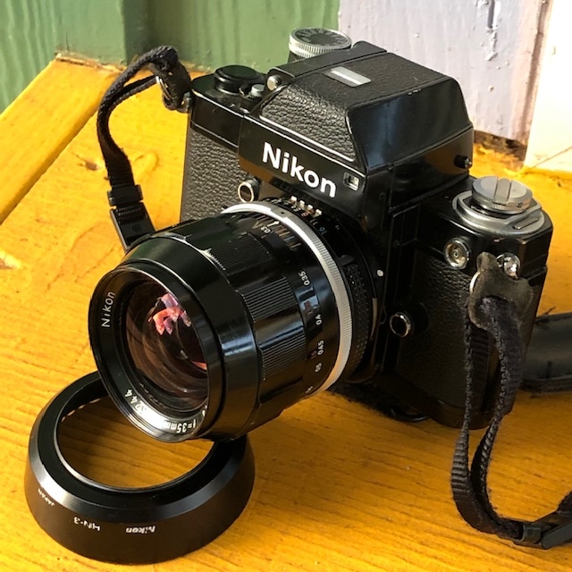

The Nikkor 35mm f/1.4 N or N.C.
Fantastic image and build quality, easily able to keep clean and lubed for a lifetime of use. My "first" one went to my former wife, who still uses it weekly in her wedding photography, and that is after I used it in the same capacity 15 years ago. When I visit I make sure to bring along a set of proper drivers and some real Nikon grease, and I give it a clean and check and sometimes a clean and re-lube. A lovely lens that only looks better with wear from use. The image quality is stellar on black and white film as well as modern digital, and since I am partial to the Radioactive Version (N and N.C) I chose to leave one of my own copies un-cleared, leaving a lovely warm gold look to color. Another copy I have I made the extra effort to clear with UV lights, but I am less fond of that one and tend to choose to shoot the uncleared lens, even though it seems about a 1/4 stop slower wide open.
My uncleared version, with the later printed HN-3 hood. In a fit of Leica-Rage I changed the Feet markings from the Nikon Yellow Chromate to Leica Red, mounted on an F2 of course.
