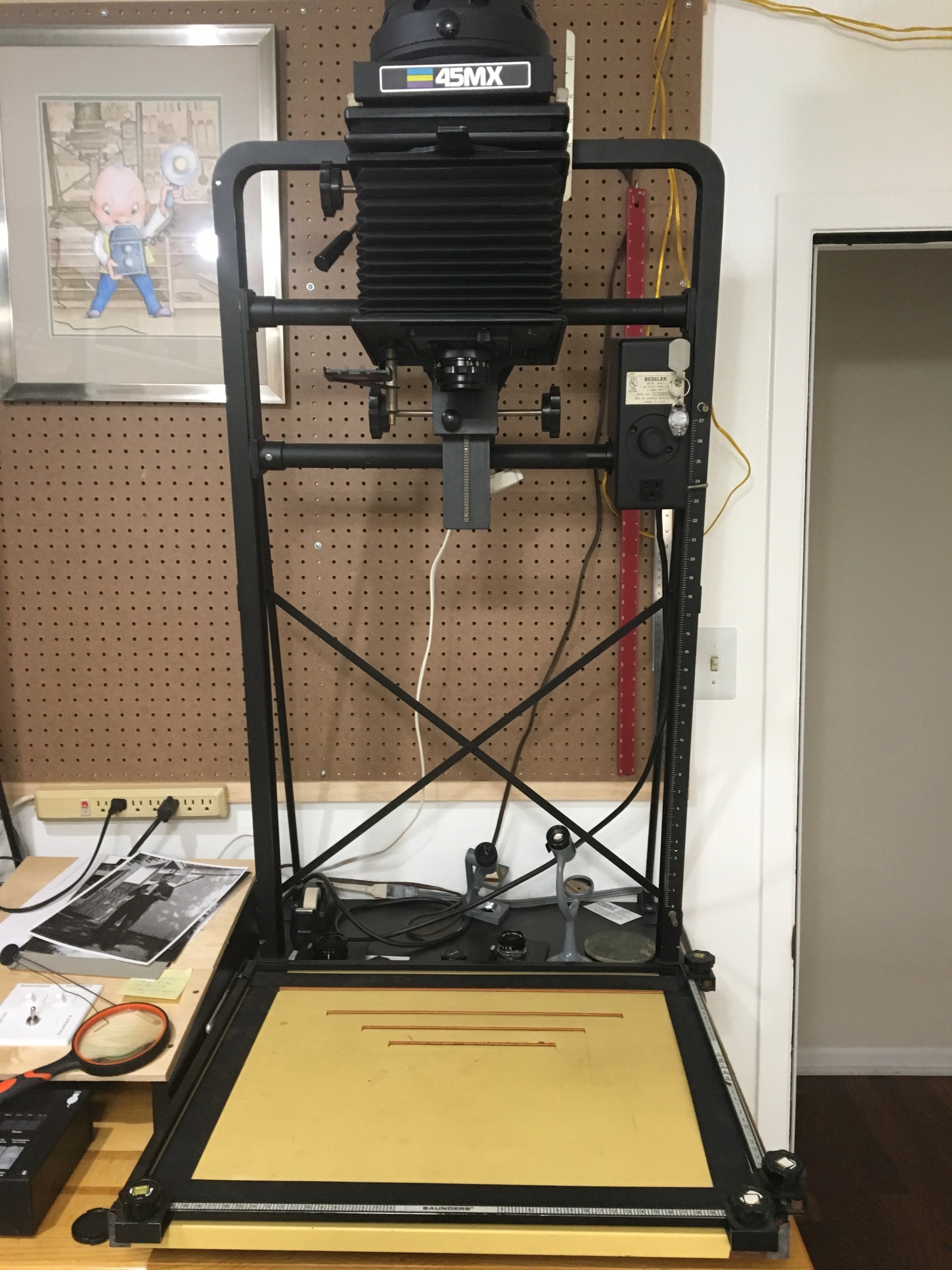

I can't help on finding an easel. Patience is a virtue. Do you have one of the older Beselers where the struts are in front? If that is so, then a 16x20 4 blade is probably not going to fit. Here's mine:

My Omega 4x5 enlargers are high-end, but still the baseboard is smaller than the available 4-blade 16x20 easels. It just has to overhang around the edges. At least with the Omega, the column is slanted back where it attaches at the base, so the easel does not hit the column. Not all enlargers are like that.
