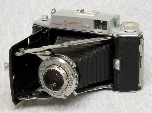

Mamiya 6, the 50s version with fixed 75mm lens, I have one, lens is very sharp, rangefinder is accurate, folds up and fit into a very large coat pocket. My other light weight is a Kodak Tourist, 6X9 scale focus, well made, as I use it for landscapes I'm usually at infinity so scale focus is big deal. It takes 620 film, I respool either Tmax 100 or ultrafine 400. It was made with both a 3 element and 4 element lens with a simple shutter with 3 speeds, I have a model with the 4 element lens and better shutter with top speed of 1/400 of a second. Kodak also made a model with a shutter with top speed of 1/800 of a second.
