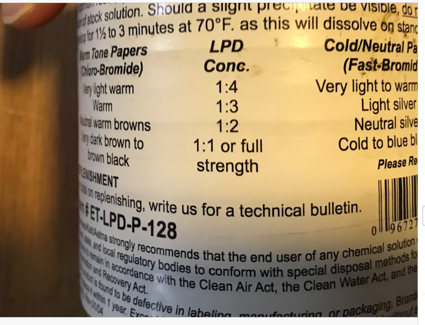

Both LPD and Ansco 130 are neutral tone developers.
From the old LPD cans:
