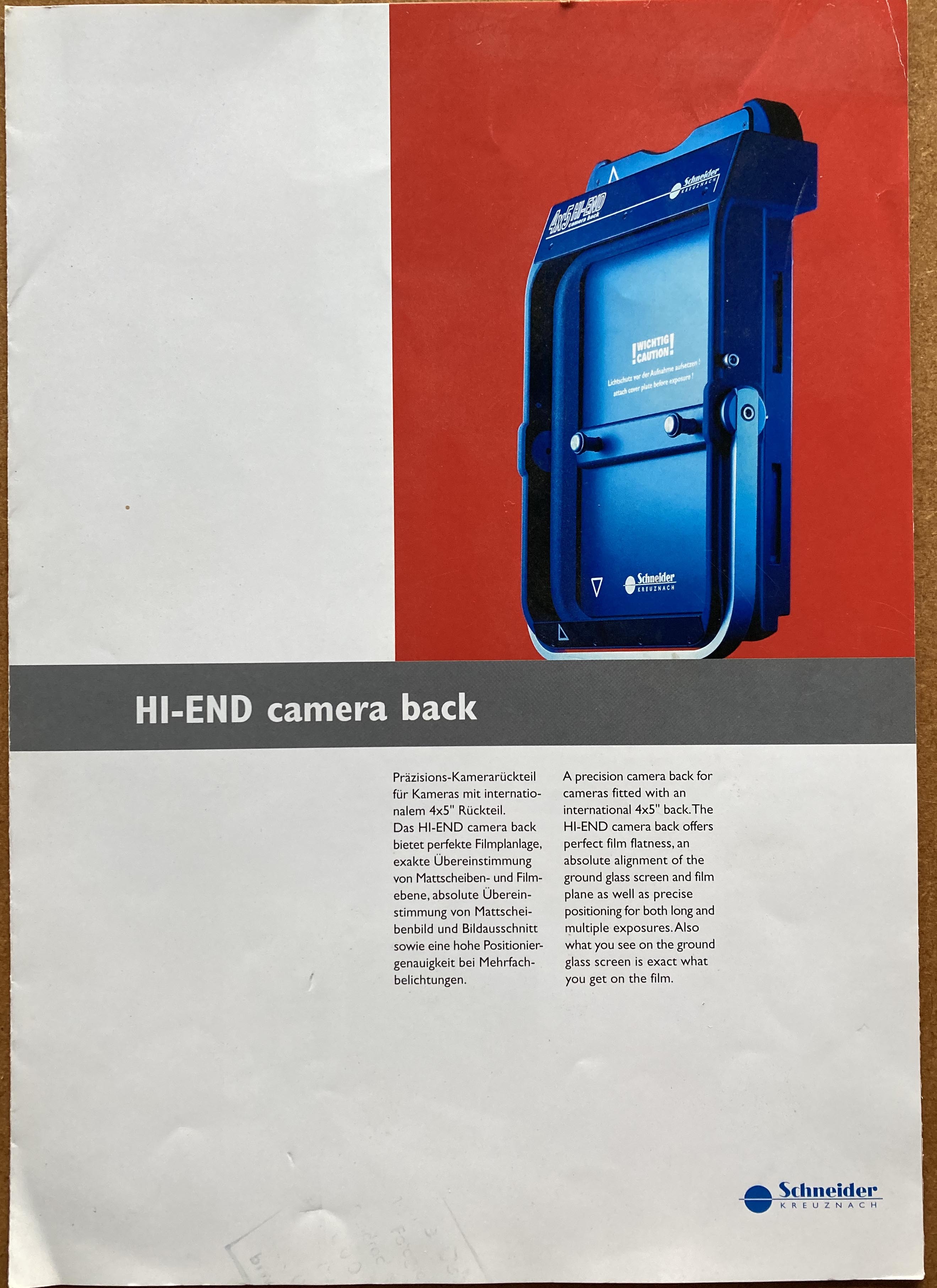

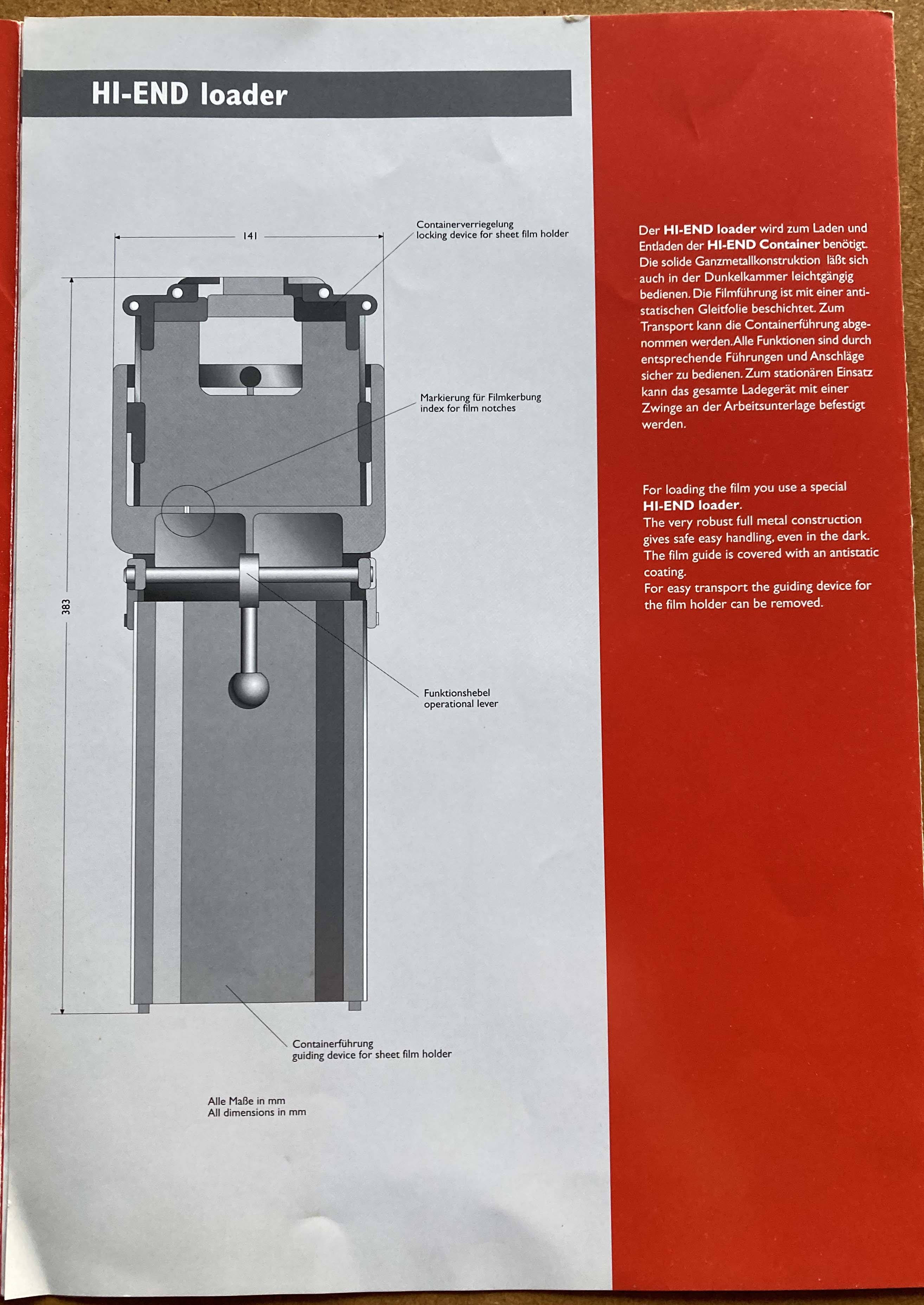

Sheet film was/is not always as flat as you hope it to be, Schneider had the answer (as always):

Phippe Georges - Sinar came out with their own precision sheet film holders. I've made my own precision 8x10 holders - both vacuum and adhesive styles. They make a difference. But most shooters would rather spend another thousand dollars for a very slightly superior lens, and get no improvement at all, rather than deal with the more serious issues first.
Or I see people spending ridiculous amounts of money on this or that camera and lens, and then bringing along a flimsy tripod, or not using a glass negative carrier in the enlarger, or a not knowing how to align an enlarger properly. Just wasted money. A chain is only as good as its weakest link.
This is absolutely correct, devices like Schneider's HI-END is somewhat overkill, for more 'common' use although, I would fully understand it for laboratory applications...
And yes, investing in a good focussing loupe, a decent matte glass, perhaps a finer lens and a sturdy tripod would be wiser; even simply adjusting and calibrating the focussing component of the camera/lens, might even be better and certainly cheaper than that HI-END thing...
To my more simple-hearted opinion, well looking after and understanding the camera system can improve surprisingly more than you might suspect, and by this I don't only think about (carefully-) cleaning the lens and reading the manual (the latter should not be ignored).
