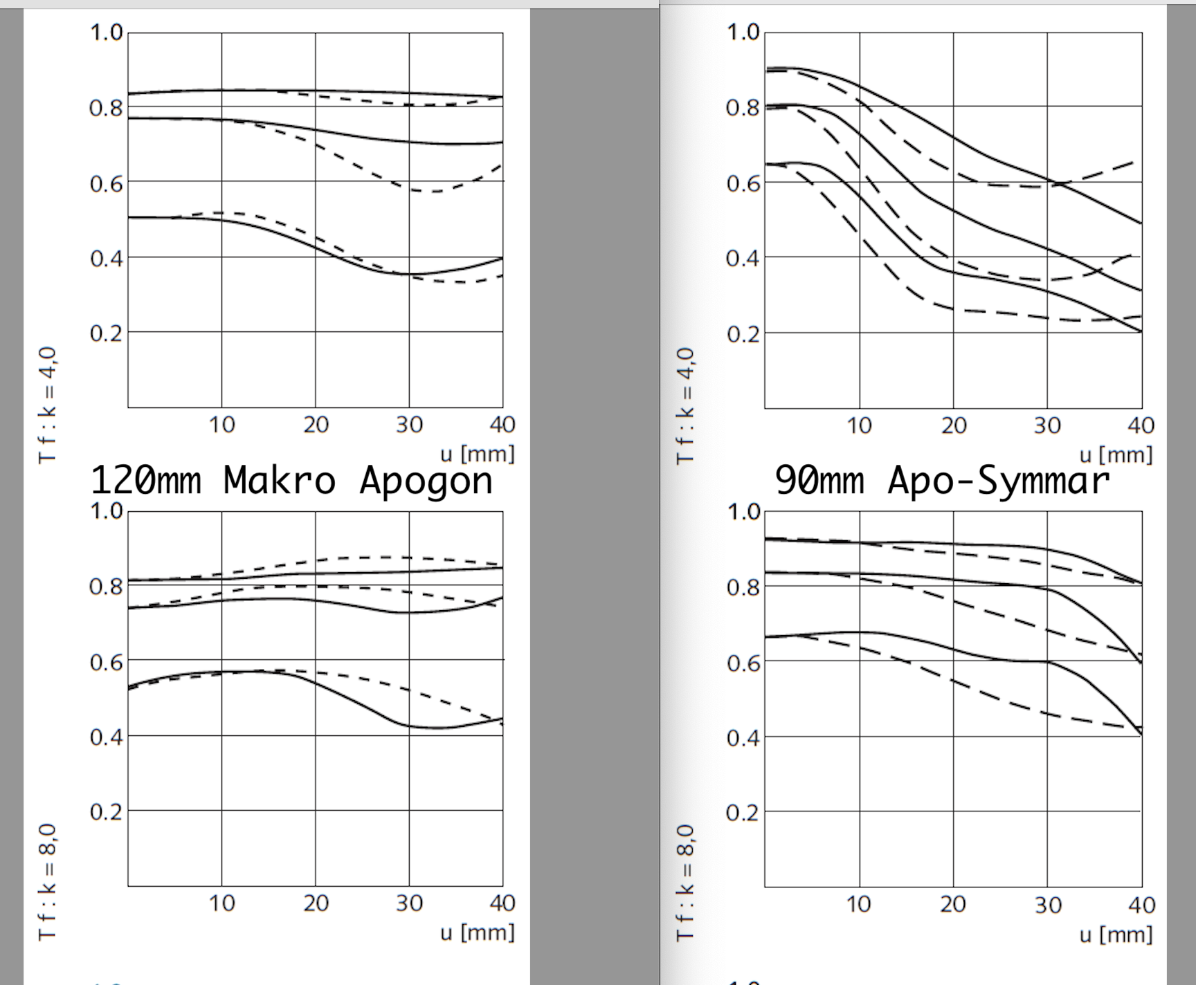

In term of sharpness only, what system (or individual lens) comes after the Mamiya 7?
As far as personal experience goes, I will cite the Rollei Apo-Symmar 90mm Makro.
Where did you find the MTF or test results on the Mamiya 7 lens?
Sure the 90mm is very sharp in the center, but if one were to want the corners sharp, the 120 Makro Apogon might be better.

Looking at the MTF posted above in #7 (thank you!) the 80mm looks good. But of course, they are all going to work fine.

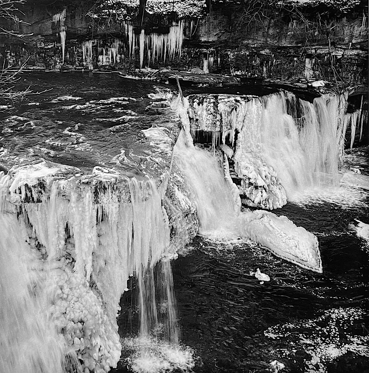

I have eight lenses of the Rolleiflex 6008 system (not the 90, however) but I had my Rolleicord with it's Xenar and a tripod the other day to take this:
