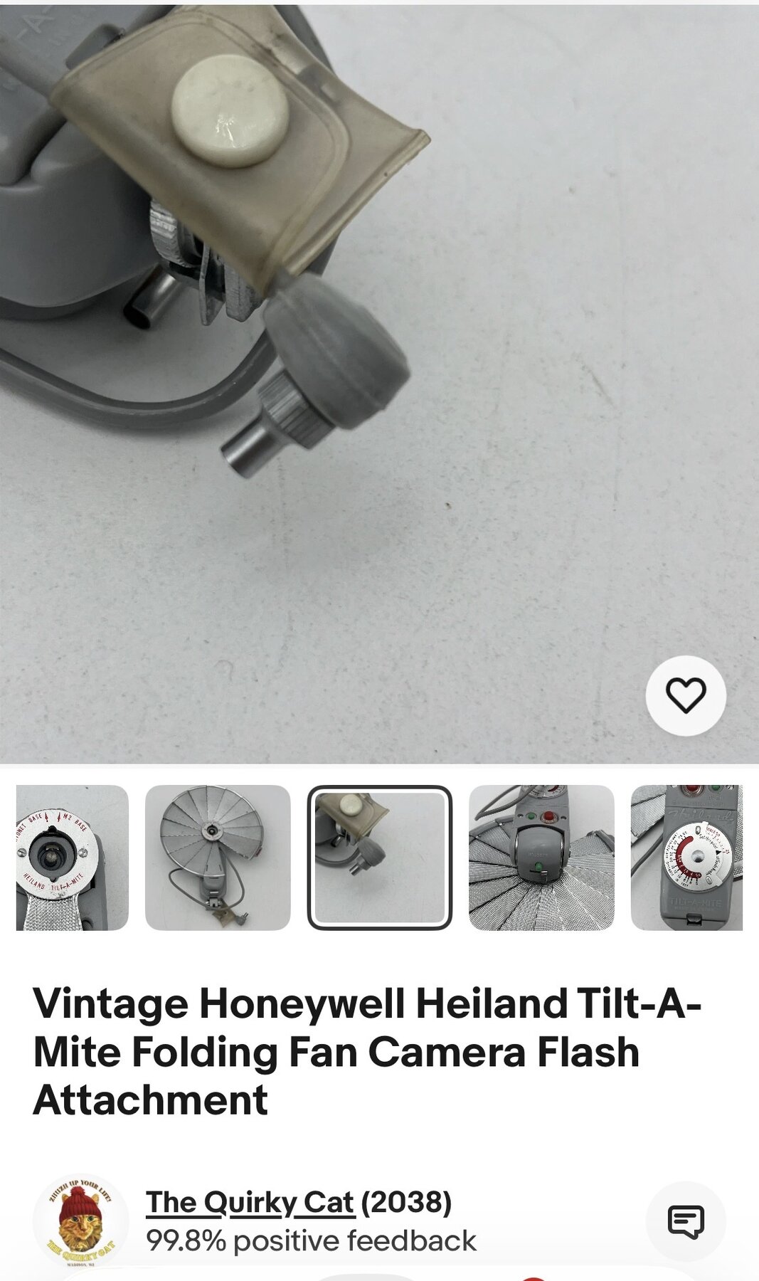

Look for Honeywell flash units on eBay.
They are wired with a replaceable tip.
The ASA adapter is green (Leica red and PC black).
Almost all I see today are PC, the ratio used to be higher.
They usually have a tiny pouch with spare tips.
This looks like what you want. You will need to do some soldering but you get a good length of wire to hack with.

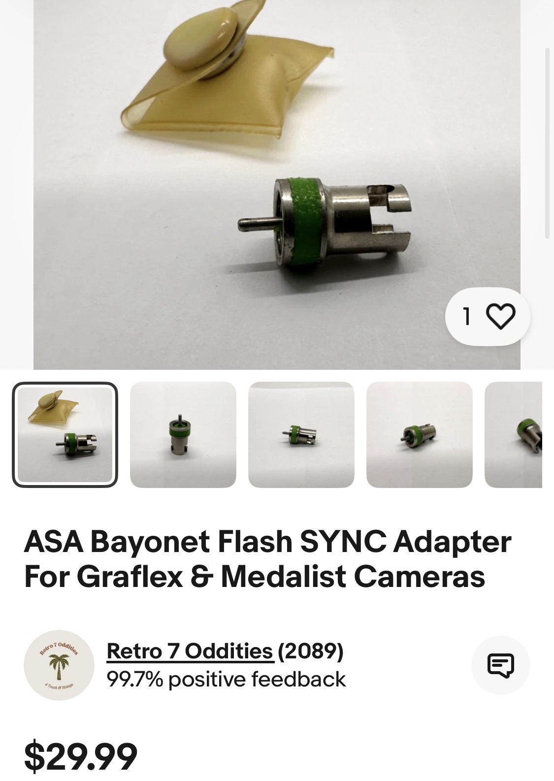

This is the actual tip. Kind of pricey. You would need a Honeywell flash to get the wire. Those average nine bucks.
