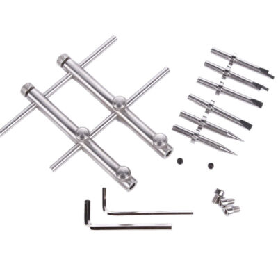

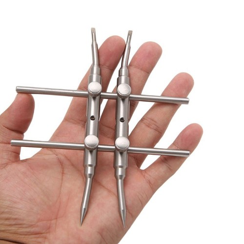

@forest bagger works with a special lever tool for gently screwing on optical units.
Nothing very special, only two lens keys with eight different shaped bits from China.
Sometimes the ring that holds a lens has no notches or holes to insert the lens key - so you have to drill two holes, or to file or saw two notches in that ring.
But what can you do if the ring is much too thin for holes or notches?
Andreas Thaler
Nov 19, 2017
4,863
Vienna/Austria

No, I mean the tool with a rubber insert that has two handles and is used to loosen screw-on lenses. You showed it in the DigicamClub.

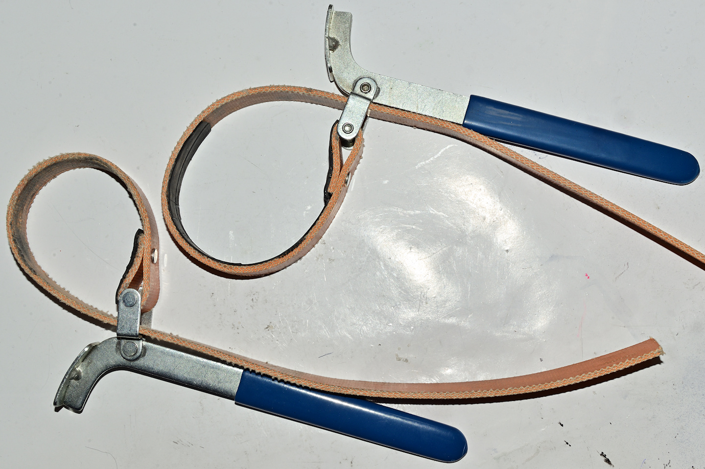

I don't have something like that.
I have these spanner keys an a set of rubber cones, but no rubber cones with handles!
Or are you remembering my two oil filter keys?
These are not useful for small rings!
