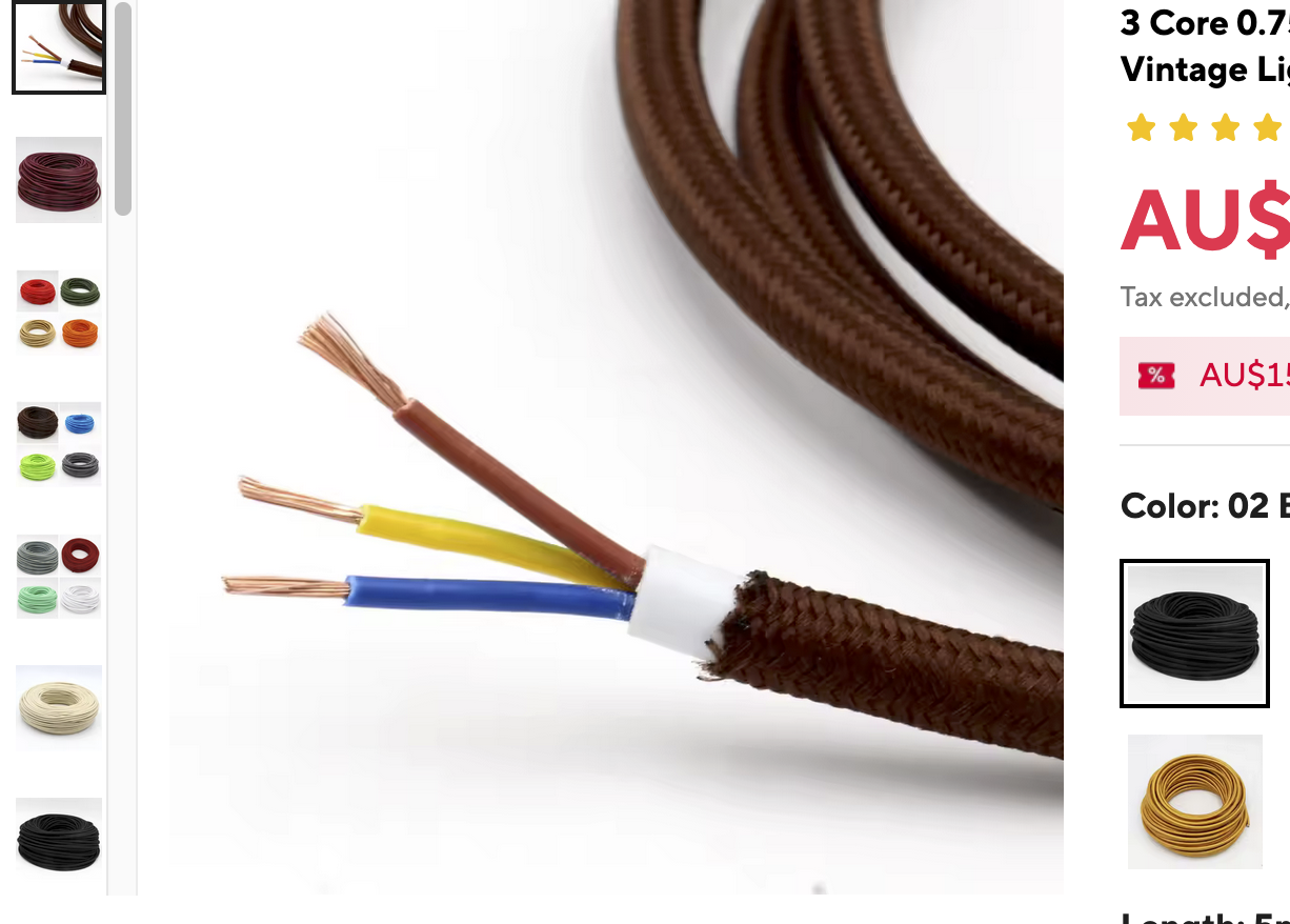

"Fabric Covered" "Fabric Braided" "Cotton Covered" ... there's various names to describe it.
Now-a-days it has a plastic insulator under the fabric for safety.
Here is a screenshot ...

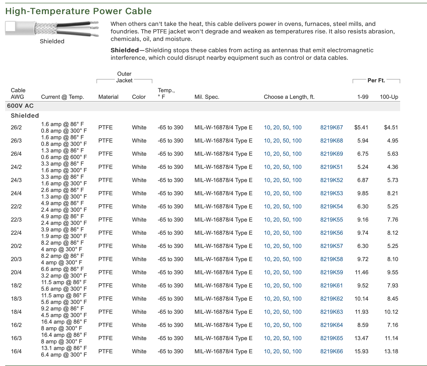

I'd use high temp wire:
Those are too little, are there any 14 or 12 g listed? I would just go to Home Depot and find a replacement cord 14 g 3 wires, black, white and green, plug already on one end. If you want the nice, flexible cloth covered wire I would try a fix-it shop that does lamp repairs etc.
Hold on! That's mostly for aesthetics. I would not recommend it in this application, since the plastic insulator is not high-temp resistant.
