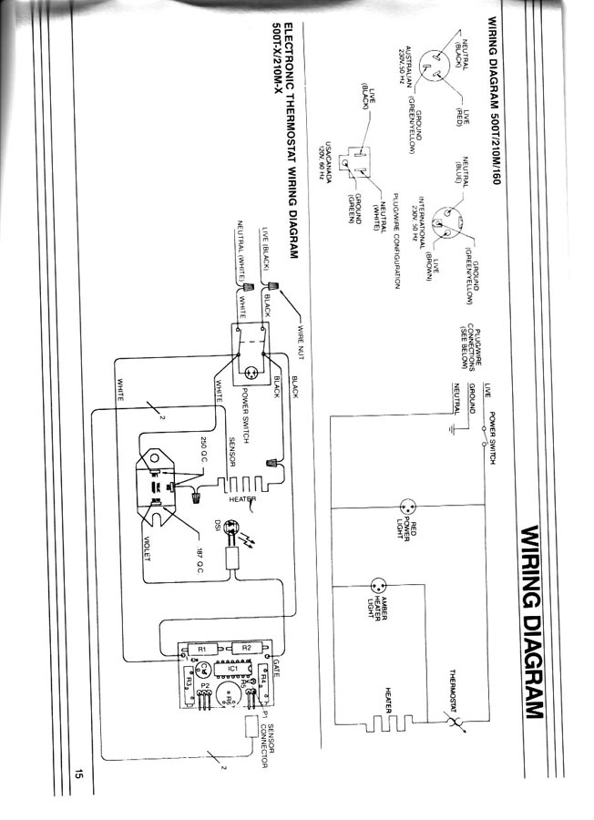

I just sold my Seal 210 here on APUG and it arrived damaged--just one day with UPS!
So far we know that the cord has been cut or torn apart (kind of a puzzle) and the bolt that forms part of the pressure adjustment knob has snapped. There maybe be other damage internally--we cannot check yet due to the power cord issue.
Is there a source for parts? I could not find a Seal website--any pointers?
--Darin

Part #' you probably need:
Pressure Adjustment Kit 6299032
Power cord can be bought from your local Ace Hardware - look for replacement A/C cords... important to get wire rated for at least 1350 watts. Wiring diagram attached.
