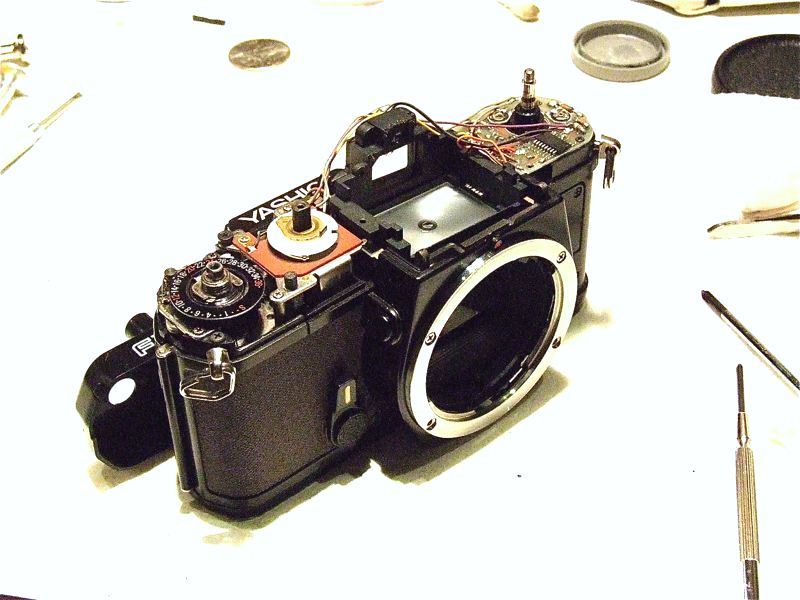

Here's a picture of tools you might need.

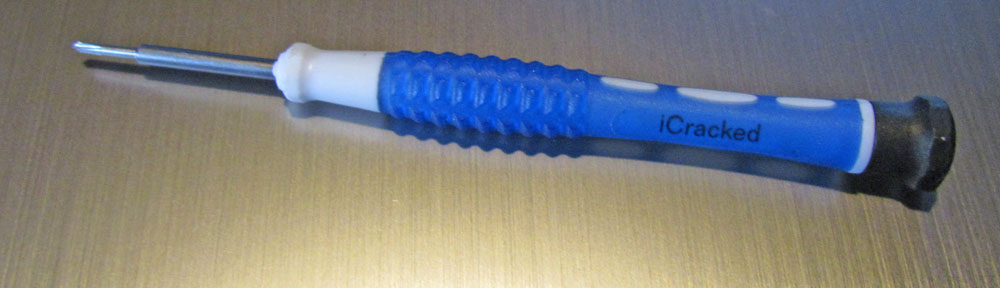

I've found I had a screwdriver that works perfectly for 35mm cameras. It is a screwdriver to fix iphones, called iCracked 1.5mm x 30mm. You have to file down the center pin a little, but after that it has worked on many different cameras. It fits most JIS screws but not the tiniest ones.
