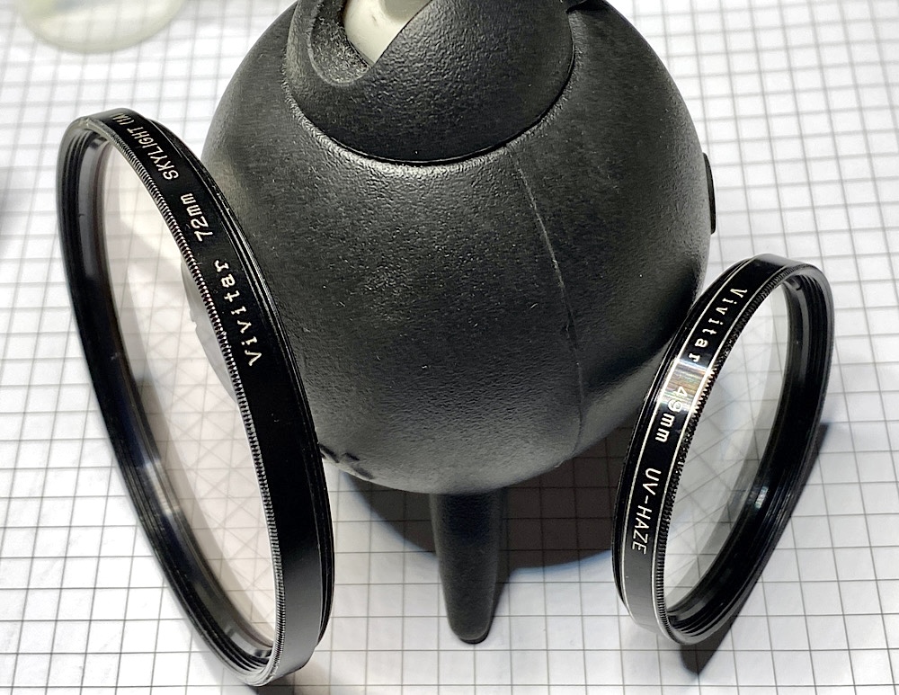

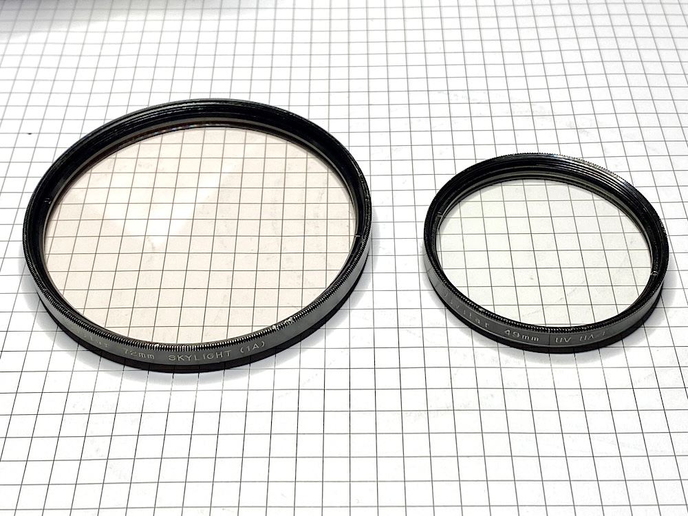

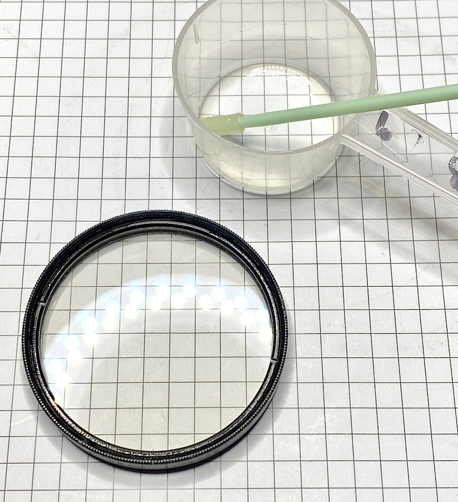

There are two filters from Vivitar here.
On the left a 77 mm Skylight filter 1A and on the right a 49 mm UV filter:

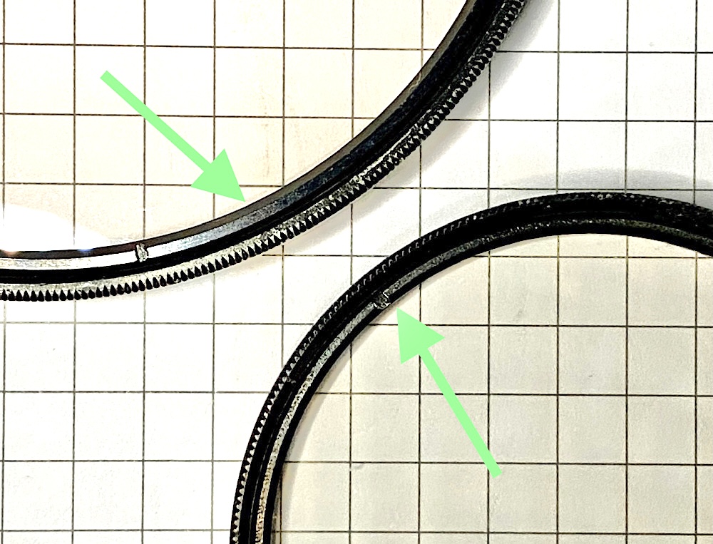

In both filters, the glass is fixed by a retaining ring in the filter ring for screwing into a thread.
There are two grooves in each of the retaining rings into which the spanner wrench can be inserted for unscrewing.
The arrows point to the retaining rings with the grooves:

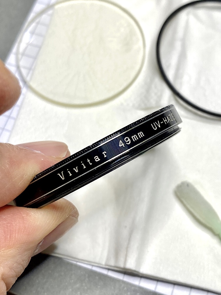

Manufacturer's name and filter data are engraved.
The material should be aluminum or an alloy.
Valuable and heavy quality.
In order to be able to completely clean ...
... I dismantle both filters.

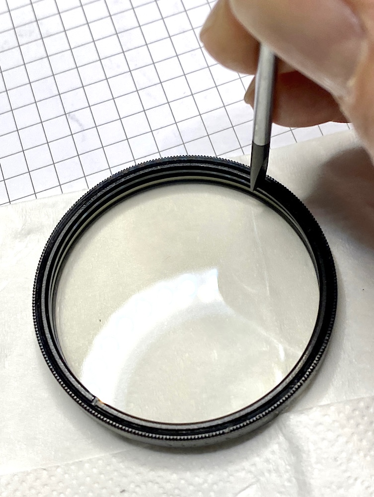

To make it easier to unscrew the retaining ring with the adjusting wrench, I apply some WD-40 oil along the retaining ring.
If any of it gets on the glass, it will be included in the cleaning afterwards:

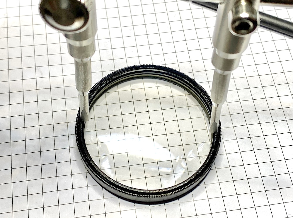

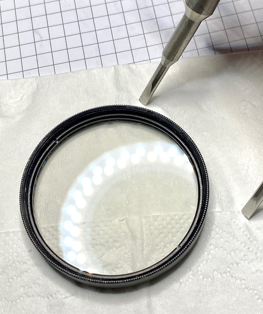

The spanner wrench clicks into both grooves on the retaining ring:
Now it is important to press the spanner wrench vertically downwards with feeling and then not to move it anymore.
The filter ring is carefully unscrewed and the retaining ring remains in position.
This prevents the adjusting key from slipping, which often leaves scratches.

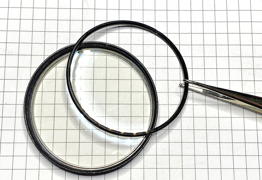

Since the thread is shallow, it takes a few rounds before the retaining ring can be removed.
Done:
The WD-40 has done its job perfectly and now needs to be removed so that it doesn't smear the glass after installation.

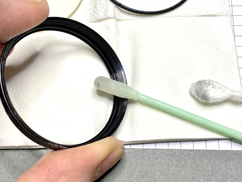

I clean the two rings with isopropyl alcohol.
This also causes dirt and grains of sand to come loose from the thread, which could make it more difficult or even prevent the retaining ring from being screwed in during assembly:

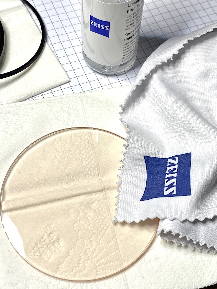

The glass can now be completely cleaned, including the edge where the retaining ring would otherwise lie:

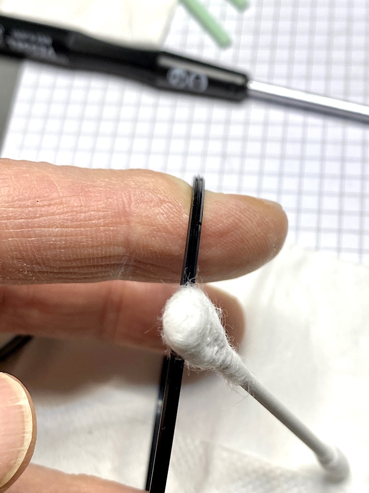

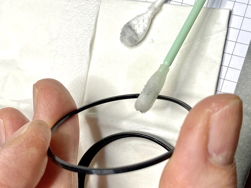

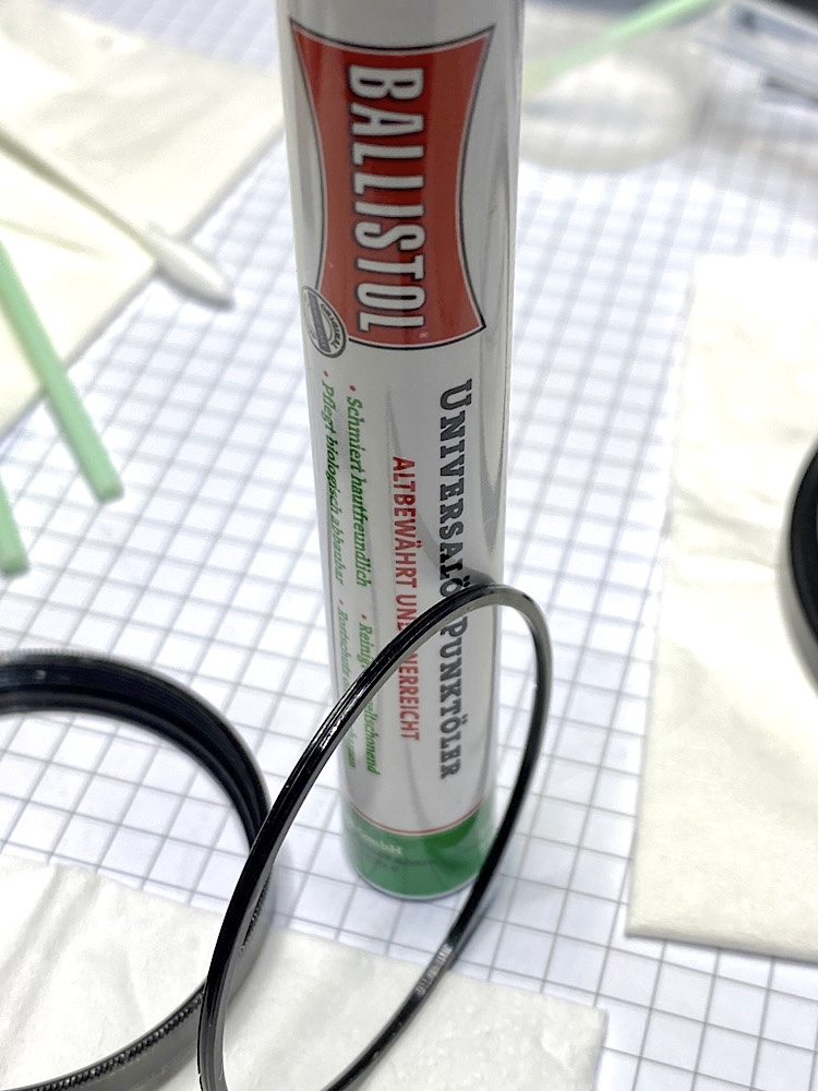

So that the retaining ring slides easily when screwing in, I apply some Ballistol universal oil:
I use a cotton swab to ensure that only a thin film remains on the ring.
Ballistol, like WD-40, creeps and the glass should not be oiled:
