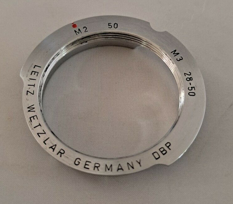

Hi,
I would like to use a 35mm screw mount Summicron on an M2. There are so many versions of this adapter and I’m confused.
Some say 28-50mm in the description but the photo shows M2 50 M3 28-50mm
28-50 doesn't make sense. The framelines are 28/90, 35/135, 50/75. So you want a 35/135 adapter. I've bought some adapters from urth.co, they show the various combinations.
In the end, whatever you get the only difference is that the framelines will be wrong, the lens will mount just fine and the photos will come out fine.
Look for one marked 35/135. This will bring up the 35mm frame lines in your M2 and the 135mm lines in the M3. Spend a little more and get a good adapter, it really does make a difference.
28-50 doesn't make sense....
it does make sense for the M3 but not for any subsequent M (ie. M2, M4, M5, M6, etc...) because the M3 had frame lines for 50mm, 90mm and 135mm.

Leice LTM-M mount adapters serve two functions: 1. physically adapt the screw mount to the M bayonet mount and 2. tell the camera to bring up a particular set of frame lines. SO, if you want to use the M2 with it's built in 35mm frame lines, you'll need a mount adapter that brings up those frame lines. If however, you're going to use an external, add-on accessory viewfinder then it does not matter - any LTM-M adapter will perform the first function, allow the lens to be mounted on the M camera body.
The one you mention (highlighted in bold) brings up the 50mm frame lines on the M2. Since the M3 only has frame lines for 50mm, 90mm and 135mm, an accessory view finder would be used with the 35mm lens on an M3 body - so, it really does not matter what frame lines the lens adapter brings up on the M3 (I think it brings up the 50mm frame there as well but am not sure).

The correct original Leitz adapter, code ISOOZ, may be labelled 'M2 21-35 M3 135mm' or simply '13.5.cm'. The latter engraving is presumably from the early M3 era, when neither the M2 nor 35mm framelines existed, but the adapters are functionally equivalent - i.e., you'll get 35mm framelines on an M2, 135mm framelines on an M3, or both 35mm and 135mm framelines on cameras that display both together, like the M4 and later.
https://www.l-camera-forum.com/leica-wiki.en/index.php/ISOOZ
https://www.worthpoint.com/worthopedia/leica-leitz-13-5cm-135mm-ltm-adapter-1787044151
The one you mention, code IRZOO, is different, and will bring up 50mm framelines on either the M2 or M3. On cameras like the M6 you'll also see the 75mm frameline, which is paired with the 50mm.
https://www.l-camera-forum.com/leica-wiki.en/index.php/IRZOO
There's also a third adapter, ISBOO, that will bring up the 90mm frameline on either the M2 or M3. On cameras like the M6 you'll also see the 28mm frameline, which is paired with the 90mm.
https://www.l-camera-forum.com/leica-wiki.en/index.php/ISBOO

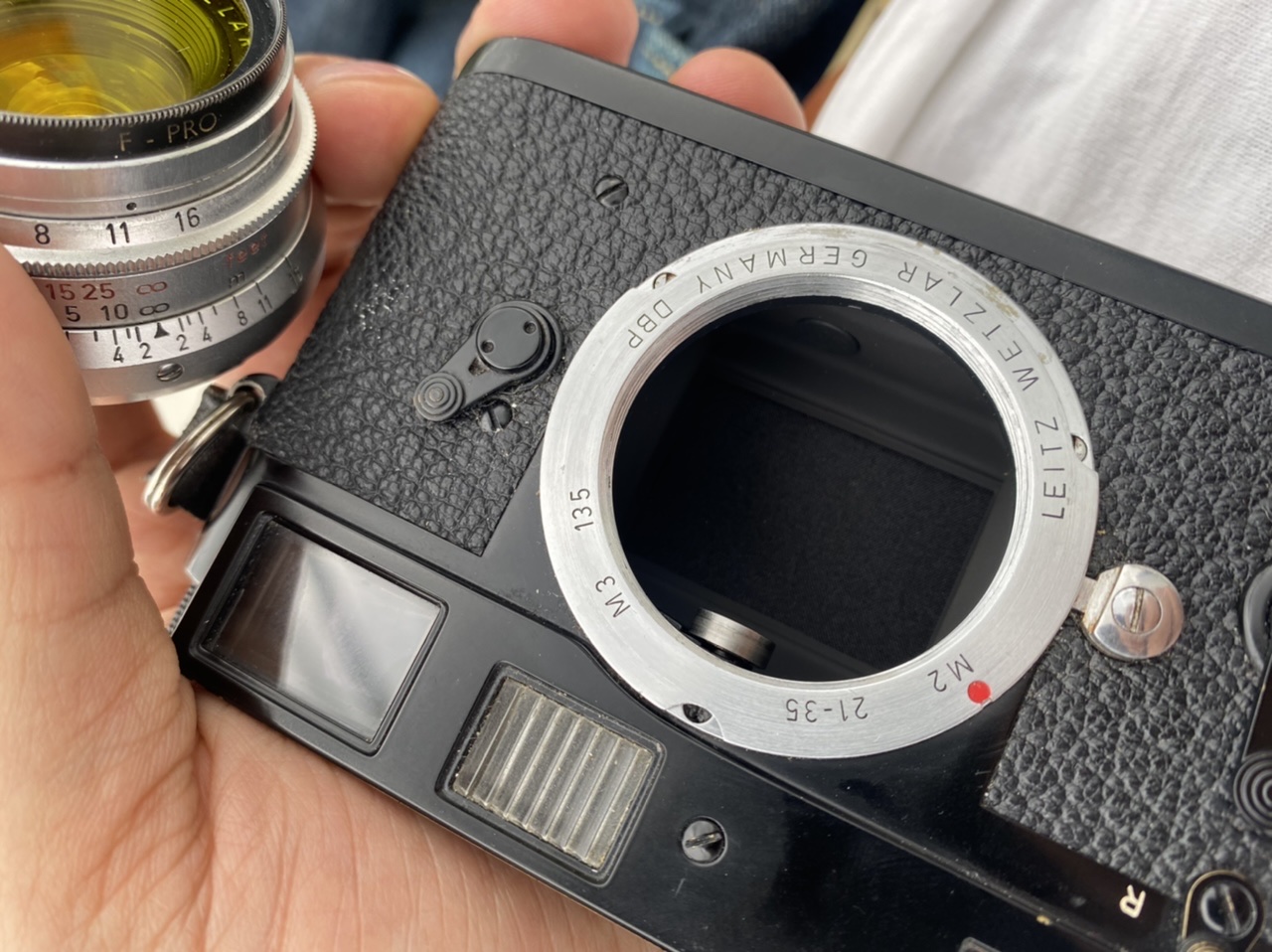

I found a Leitz 21-35 and Rayqual at a local camera store here. Rayqual was half the price and looked like it was good quality.
Kanto camera who will overhaul my lens recommended me getting the original one if I can find it. I bought the Leitz.
so far so good. Focusing works and the correct frame lines come up. Will need to develop the roll to see if it really focuses.

Get a $20 Fotodiox adapter as well. Just to compare. You'll find zero difference. Then you'll have a spare for any other lenses you may use.
I prefer to keep the adapter mounted to the lens, not the camera. So if you use a regular M mount lens, you don't have to struggle to remove the adapter that is on the camera.
