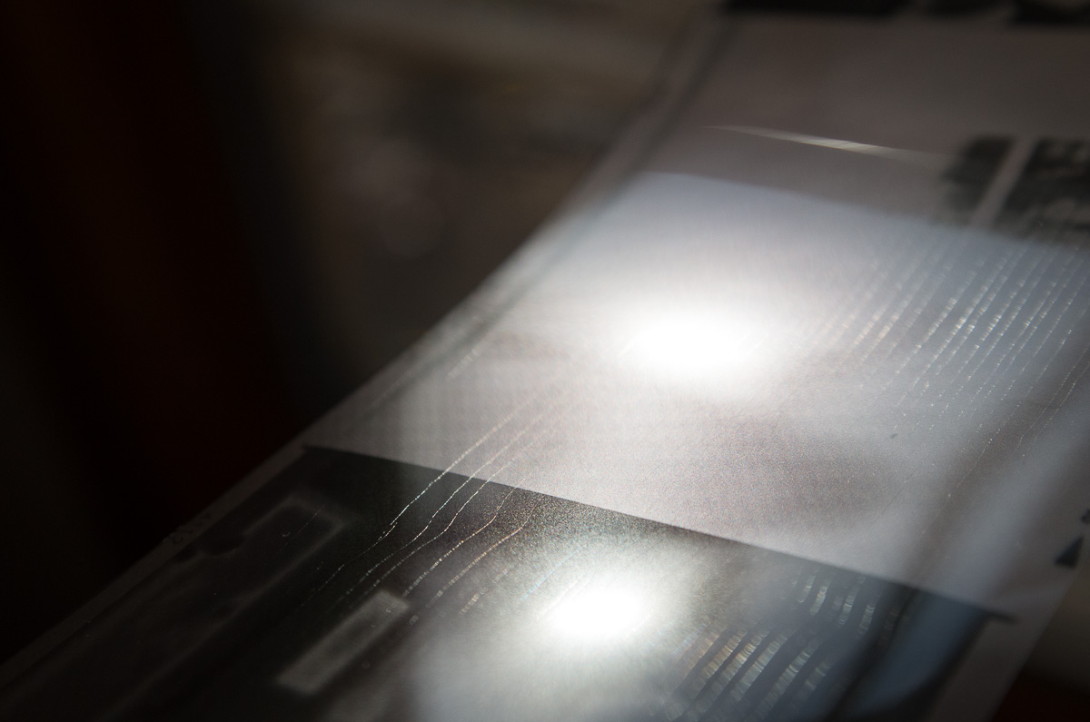

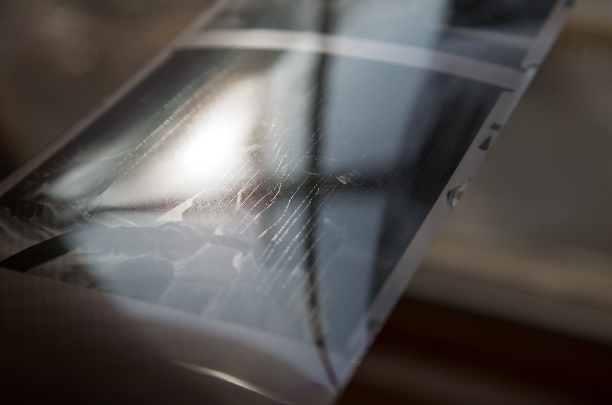

Hello, I have just developed for the first time two rolls of HP5 from a Bronica SQ and both came out looking like the attached photos.
Background:
- Developing was done on steel reels and in a SS tank.
- Both rolls were from different backs.
- After developing the first roll I noticed what I think are scratch marks. I had used my fingers (first wet in the on the roll to remove some of the liquid.
- On the second roll I did not touch the negatives but still got the same scratches (although less pronounced).
The problem is I just can not think of where the scratches would have come from. I doubt it is the backs as neither of them have done it before (lab processed) and it would be weird to have them both do it at the same time. The camera never touches the film so it can not be that. Since I did not touch the negatives during drying on the second go I do not think it is that. That leaves loading (possible) but I have loaded film before with other reels and never seen this. The major difference is washing. I used Ilford's 3 fill and dump technique, where as in the past (4 years ago) I would run water for 5 min. So I am wondering are these marks scratches or is there some residiual chemical drying on my film surface.
Thanks in advance for any advice you may have,
Try cleaning the base side w/a little Windex & a cotton ball to remove residue.
Thanks very much for the input. I will try it and see if it helps.
Dan
Are the scratches on the emulsion side or the back of the film? Are they scratches? Can you feel a texture difference when you touch them with your fingers?
I tried the windex and cotton ball but it did not really take any of it off.
I am not convinced they are scratches. The more I think about it the more I think it is something else, but I just do not know what. The lines are on the shiny side, so back of the film (I think). When I slide my fingers over it or try to catch something on my nail, I can't. In other words I can not feel any texture differences.
Thanks for considering the problem and any ideas you might have are very welcome. I have some more rolls I would like to develop and want to make sure I get this sorted before I continue.
Dan
Usually wet fingers work fine for wiping wet film, but not always. The one thing we can say for sure is that these are not camera scratches, which are usually linear. Beyond that, it's hard to tell. They could have come from grit that got into the camera winding area (but you probably would have noticed and fixed it) or during the handling while loading the developing reel, or from grit deposited on the film during washing (my most likely candidate), or from something that didn't come off your fingers when you wet them.
You can not clean your fingers sufficiently ever. #2 id there are small particles on the film, your fingers will grab it and make a long scratch. Precipitated silver from used fix is one source. It does not wash off film. Better to deal with one spot than a scratch.
The internet is full of bad advice and I suggest you refer to manufactures directions.
Commercial machines dry with air blast. We can only drip dry with wetting agent in a clean environment.
Thanks for all the advice. I did not touch the film I posted so those cannot be from my fingers wiping anything down them. I was worried about some sort of chemical residue so I re-fixed the film with fresh fixer to see if I could redissolve something but no dice. The lines are still there. I also got impatient and developed some Delta 100. I used a two fix procedure with the second batch being fresh. Although much fainter the lines are still present.
Something I forgot to mention but may be important is that the films were exposed and then frozen to wait for development. The oldest one had the most apparent lines. However I have had film frozen the same length of time and then sent off to a lab for development and not had this issue.
Our water is not hard so I do not think that is a problem but I might try a different source of water.
Thanks again to all those who have offered assistance
Dan

Are you sure these are scratches and not drying marks?

As to the poster, you are most welcome to send it to us to investigate the cause, and I ( we )cannot tell just from a scan but it looks like a set of non linear scratches and it is 'probably' done in camera, or more likely at loading onto the reel...but we can certainly check it. The confusing thing is that its
so pronounced its highly unlikely you would not have 'noticed' something happened if you were loading it, so it moves toward a camera issue, but it does not look like a 'standard' in camera scratch.....
You need to investigate with an electron microscope as then you can normally identify the cause pretty quickly.
Simon ILFORD Photo / HARMAN technology Limited :
I understand that you see defects on the suport side.
With your finger feel no bump on support.
When you look you see support is right (with reflected light ).
Without a scratch?
The suport might have fault from the emulsion side (of suport).
Sacrificed a piece of negative defects and insert in
a solution of ~ 20 g / l NaOH at 30-40 C.
After a few tens of minutes, should the emulsion
detach from the suport.
Dry the suport and see if it has scratches on any part.
Alternatively variante - mechanical pressure to give photographic effect film (silver).
Defects seems to be made not on a machine / camera.
Sounds like a defect caused by manipulation.
Without seeing the film are just suppositions.

Thanks so much for all the possible suggestions. I tried a quick scan of one of the images (not printed yet) and when the negatives are backlit you can not see the lines. Does this mean it is not scratches but something that dried onto the surface of the film? Or can scratches sometimes be so fine that they do not show up during scanning? If they are scratches they must be from loading because I do not think the camera could have caused it so I will have to keep that in mind when I go to develop more film. If it is residue what would be the best way to remove it? Someone suggested windex and cotton balls but that was not extremely effective.

To see if a defect is photocopied you looks negative in direct light.
You look the negative in a light bulb.
If you see damage in direct light they will come out in positive or scan.
If you do not see in direct light then just minor friction and will not photocopy.
If you do not see in direct light does not do anything to film.
It is possible to make them more harm.
I personally do not use cotton removal method than when the film does not have another chance to resolve.
Reaching emusiei or support with cotton wet / dry involve risks of
occurrence of friction or worse things.
George
Thanks for the information George. At this stage I think I will leave them since they do not appear when viewed in direct light, only when looking sideways at them. I will give all of my equipment a good clean and scrub and maybe tinker with washing a bit (time, complete water changes, running water and using DI water) and hope that one of those tricks will rid me of these lines.
Thanks
Dan
Once I had a similar thing happen with two rolls of Delta 400 (120 format) developed in Rodinal. On the surface it looks like the negatives could be ruined, but when I printed them in the enlarger they were just fine. No trace of the pattern I can see in reflected light appear in the prints.
It may be that you're seeing something that you don't have to worry about. If your process is normal and you're doing things the right way, then I would write it up as 'science fiction' and move on. Unless it happens again.
I'm having this exact issue with 120 HP5. The quality of my water sucks so i'm leaning towards that. Did you ever iron out the issue? Our well water used to be pristine but we're now having problems (sand, silt, iron). My 'scratches' actually show up under a grain focuser and in enlarged prints.
