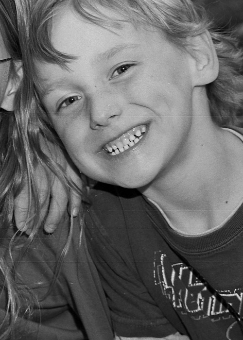

OK, I'm getting some scratches on the film with my Bronica 120 back. I cannot tell if they're on the front of the film or the back. Any suggestions on what to clean to get this resolved?

I've inspected the path (GS-1, 120 6x7), but cannot locate anything conspicuous. It is rather frustrating and I do not see them on some of the color frames I shot, only this roll of B&W (Delta 400 at ISO 320/Perceptol 1+1). Perhaps a bad roll of film, or something I did while loading the film on the reel?

Are those scratches across the film, rather than parallel with the film's edge? If so, I don't know how something in the camera would cause them.

Correct me if I am wrong, but in Shaggysk8's case, the scratches/lines run lengthwise on the film, while Tony-S's scratches/lines run across the film.

Tony-S's camera is a GS-1 which provides a 6x7 negative. With his 6x7 negatives, the short dimension (and the line) runs across the film.
Your camera is an ETRS, which provides a 6x4.5 negative. With your 6x4.5 negatives, the short dimension (and the line) runs along the film.

Yes, mine are across the film. I suspect when I advance the film there is debris on one of the rollers, or one of the rollers isn't rolling properly, or some such. It could have been specific to this roll as I don't see these lines in a couple of rolls of color film I shot a few weeks ago. I will shoot another roll this weekend and see if the problem persists (after a good cleaning, though).

It could be a sticky roller come to mention it. The roller is intermittently seizing. The film resting on the roller skips and stretches the emulsion, resulting a vertical scratch-looking defect. Make sense?
Whatever is causing it, it must be on the front of the film since the back is covered with paper. Strange, though. I've given it a thorough cleaning (I think) and will try to shoot and process a roll this weekend.

Well, the frustration continues. I'm not sure what to do next. I've cleaned the two rollers that should be the only ones that contact the front of the film and I'm still getting scratches. Could it be downstream from the camera, such as in development? I use a Nikor stainless steel tank and reel. I'd sure like to get this problem resolved and welcome any suggestions.

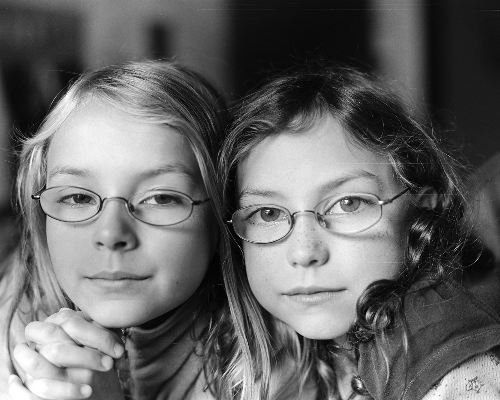

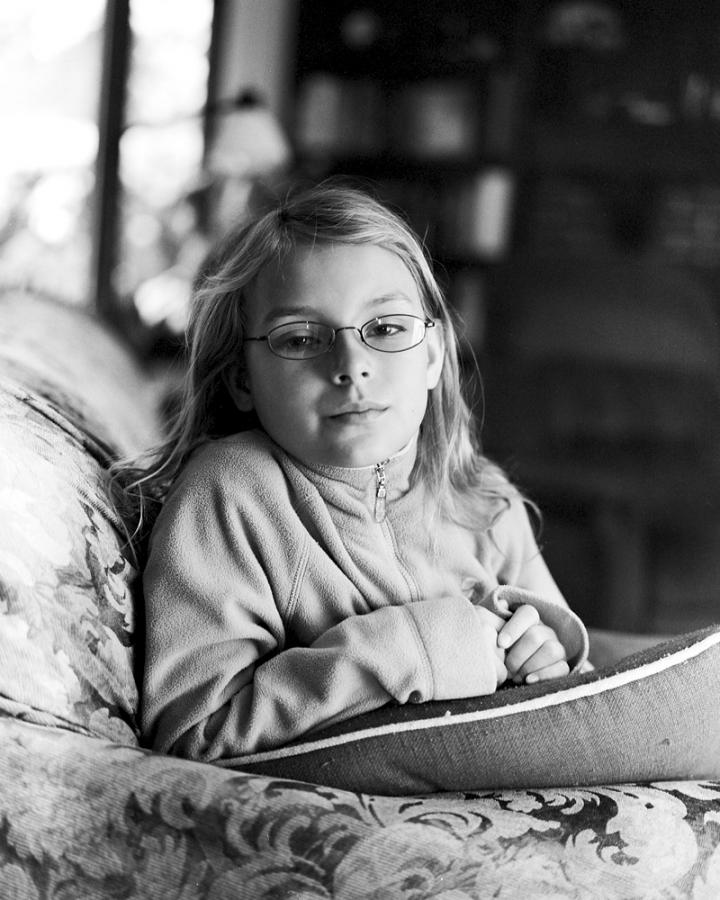

Ok, I think I've isolated the problem. Attached is another photo from that same roll of film, but it does not have scratches. Does this not imply that one (or both) of the rollers that contact the front of the film is only intermittently rolling? If it weren't rolling at all, then the scratches should be across the entire film length? If this is the case, then this should be fixable by lubricating the rollers?

My thinking exactly. Some dust or debris caught up internally and only occasionally seizing. If disassembly is an option I would get it thoroughly cleaned. Doesn't take much to get one roller to seize only occasionally.
I think that was it. A close inspection showed one roller had a fair amount of drag. I removed it, oiled the ends and reassembled it. It's rolling much better now and I've shot a roll of film. Hopefully, this will take care of it.

OK, I am totally confused now. I just checked one of my other rolls that has scratches on the film and it's exactly the same. Frames 1-7 have no scratches, but frams 8-10 do have scratches. On both sets, frame 8 has minimal scratching while frames 9 and 10 have substantial scratching (as shown in my first post). Does anyone have a clue as to what might be going on here? The film was one roll of Delta 100 and two rolls of HP5+ shot at ISO 320. All were processed in Percetol. Might this be from my stainless steel reel? I'm not sure how it could be, but at this point I have no idea what's going on.
Edit: I just checked the third roll (Delta 100) and it's the same. Frames 1-7 are clean, frame 8 has a bit of scratching, and frames 9 and 10 have heavy scratching.
