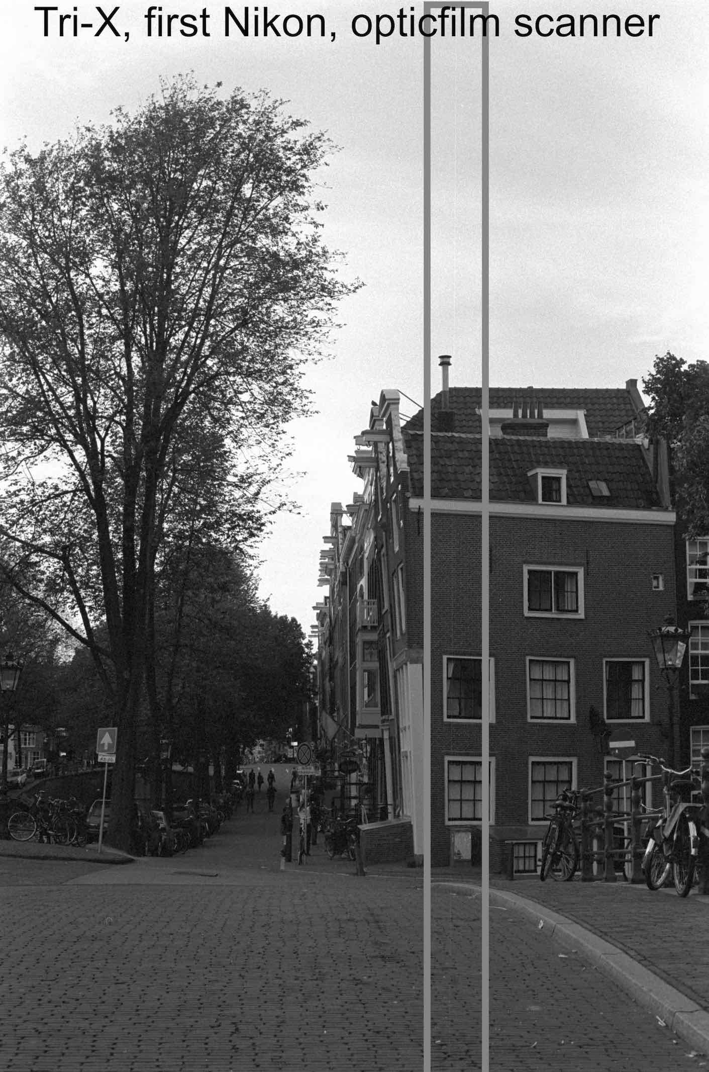

I have a problem with scratches on my negatives. I use a Nikon F90x (or N90x), shoot mostly in black and white and develop it myself. I don't bulk-load film, I use normal 35mm-rolls.

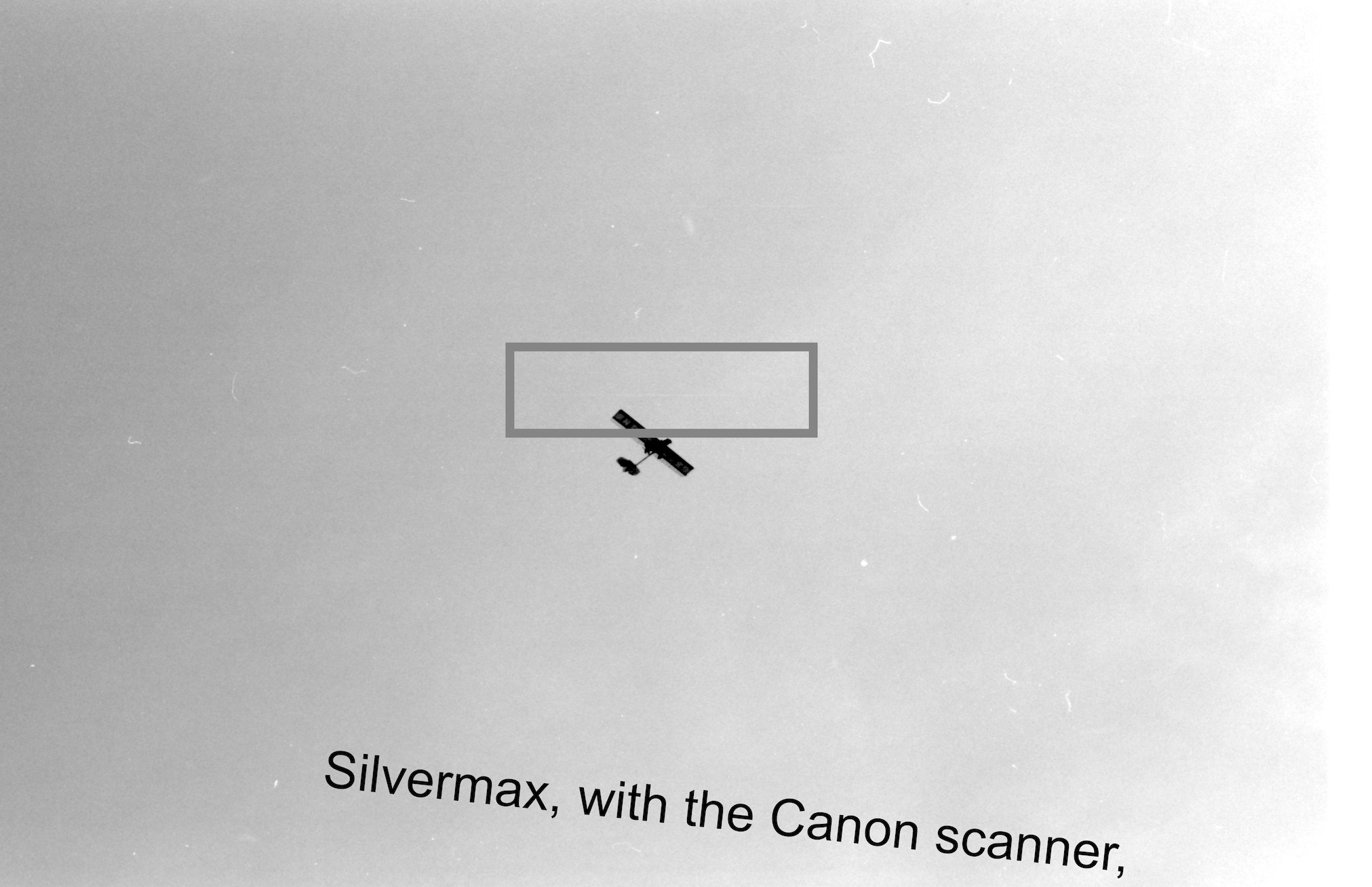

Since I don't have enough time for a lot of printing in the darkroom, I usually scan my negatives first. I upgraded from an Canon 9000F II to a Opticfilm 8200, and that's where the problem became visible. Nearly every film I get out of my Nikon (also true for color-film when developed by the lab) has horizontal scratches on it, not on the emulsion side, on the "glossy" side. I realized that my old scanner was just a little less sharp than the new one, and the extra sharpness revealed the scratches. (Two scans of the same image attached for comparison, please ignore the dust on the second one).
(This question is not about the scanning! It's about the camera / scratches)
I even bought a second F90x on ebay and while the scratches were in general less intense, they are still there. Depending on which film I use it gets better or worse. My absolute favourite film is Adox Silvermax, and that's the one that also gets the most scratches (the picture with the plane is on Silvermax). I also use Kentmere 400, which works pretty well without much scratching. The film feels thinner than Silvermax (or Tri-X) which might be the reason. I also had scratches on Tri-X. I checked my dad's old color negatives from 15 years ago (shot with the same Nikon) and there were some scratches as well.

(I put some boxes in the pictures for clarification)
