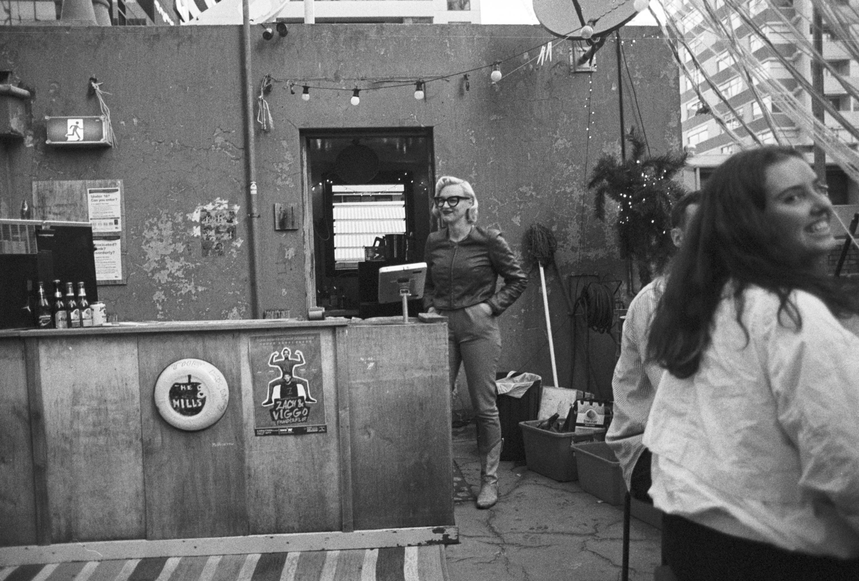

Here's an example shot. Hope you can see the line at the bottom.

The only line I can see and it is faint is one running under but slightly cutting through the bottom of the figures 4 and what looks like a drunken "s" or maybe a 2. Is that the line? I presume the 4 2' 17 is the date it was taken which imprints on the negative?

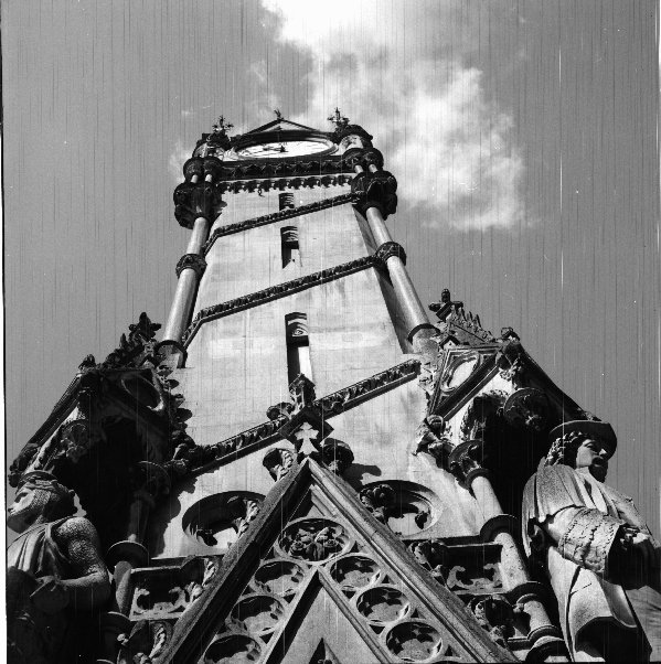

Scratches.....These are scratches.:smile:
This is what happens when you try crazy ideas with a Rolleicord :whistling:.............So embarrassing
