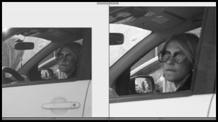

Hi all,
I'm getting my film developed at the lab and usually ask them for a low-res scan.
What I find intriguing is that their scan does not seem to have scratches but when I scan the negative at home (Plustek 8200i), I get a thin white, continuous horizontal line as if the negative had been scratched (see the eyes of the lady in the example). I've encountered the problem with film used in two different cameras, so I would expect that the camera is not the culprit. Also, because the lab scan is low-res, I don't expect that they would do retouching for that kind of problem. What do you think could cause the scratch? And how to avoid it?

It could be an artifact of the scanner. An optical enlargement can reveal if it is on the negative or just from the scanning process.
If you don't have an enlarger, you can rotate the negative 90 degrees and scan again. If the "scratch" goes in the other direction, it is the scanner.
There may be a speck of dust the size of the scratch in the path of the scanning light.

This is very important - in that way you can know for sure it is scratch on the negative, and not error from scanner. When you are sure it is scratch on the negative - then you can try to change the camera, change the film, and on the end develop yourself (or change lab). Just be sure to change one variable at the time.
Let's not overlook the obvious: maybe the lab scratched it after they scanned it. (Or you did.) By any chance are the negatives put into plastic sleeves that load in on the skinny dimension, i.e. the negatives slide into the sleeves across the length of 5 or 6 frames? I've never liked those.

Thanks all for the suggestions. I wanted to see if there was anything obvious before I start looking at parameters in a methodical way as darkosarik proposes.
I was thinking if the lab batch-scans the negs from an uncut roll and then cuts the roll, then this may be the stage when something screws up... Unless I do the screwing up. I tried rotating the negative holder 180 degrees (cannot do 90) in my scanner with one of the negatives and I still had the issue on the same side of the image so it does not seem to come from inside the scanner.

To get back to the original problem: Whether the scratches are visible or not in a scanned image depend a lot on the lightning system. Some scanners have a very harsh lightning system and show all micro scratches. Perhaps the (micro) scratches were also present in the first scan by the lab, but not visible.
Perhaps you will see the scratches with a condenser enlarger, but not with a diffuser enlarger. Perhaps you will see them only with a condenser enlarger with a real point light source.
Thanks Chris --- it's different scanners indeed. I am comforted so far by the fact that film shot with two different cameras had the issue, which means it's hopefully not the camera but more likely lab's process (or, but let's hope not, my scanner screwing the negatives). I will now process my film at home so hopefully the issue will disappear.
