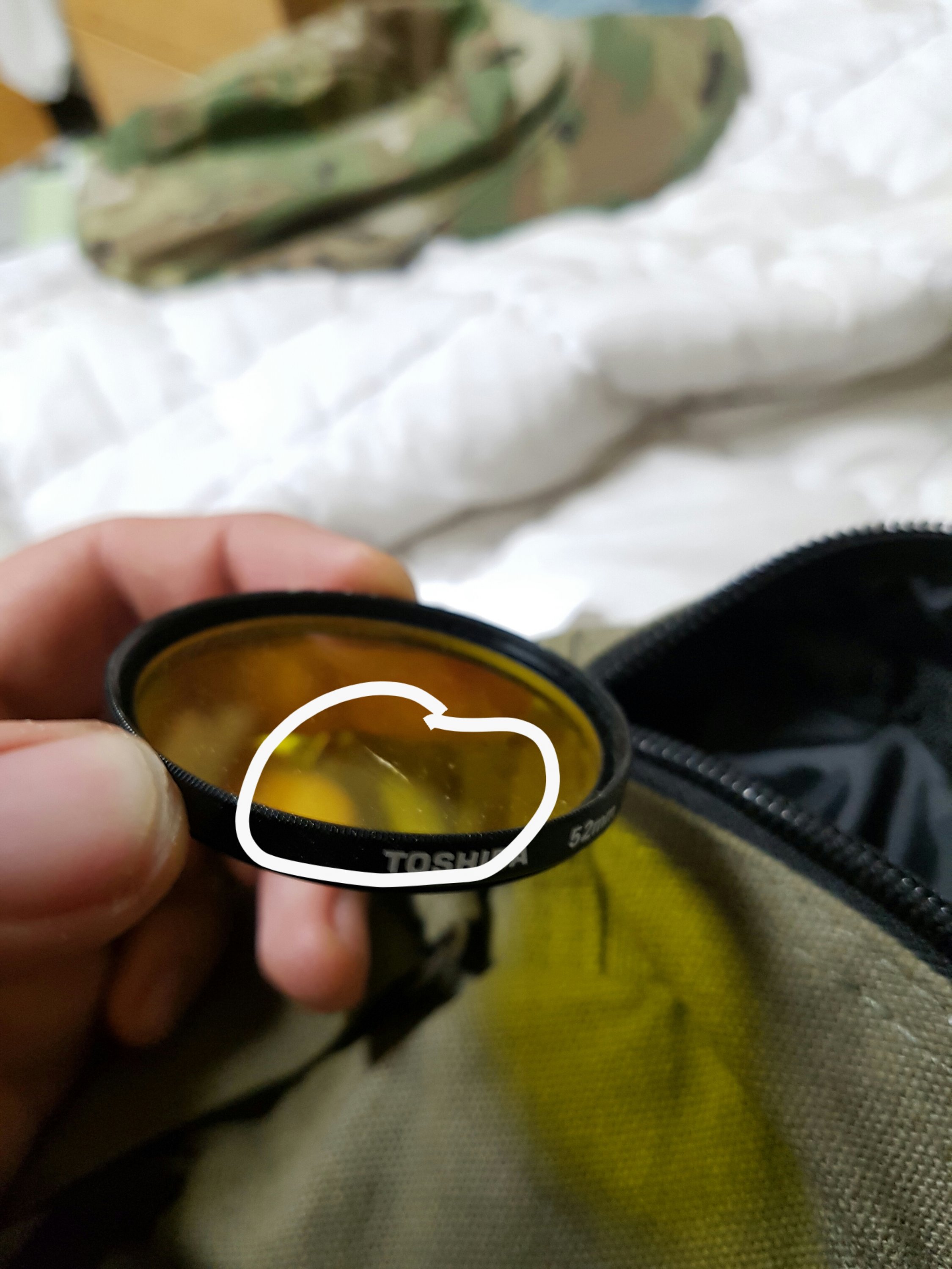

You would be unable to focus on it at all.
That's precisely my point.
You can't focus on a scratch, just like you can't focus on a toy. The scratch will not appear in the image.
There may be an aberation like flare that shows up as a result, generally only if you're pointed at the sun.

In a way a scratch on the front element of a lens would actually be preferable to a scratch on a filter. This is because a lens cannot image a defect on its surface. You're not going to see a line on any prints. As mentioned flare will increase. However a filter is separated optically from the lens. In other words the filter is not an element of the lens so a scratch may appear in any images. In this case painting it black etc may do more harm than good. This works for lenses but not for things in front of lenses. If you wear glasses then you know that any smudge or crud on the glass is visible to you.

But I can make a scratch on a filter completely disappear for approximately $20-30. I can't do that with a scratch on a front element.
And let's keep in mind the context of the thread - as defined by the OP - where he had a deep scratch on a filter that very likely would have otherwise been on the front element of his lens.

But because the scratch is on the FILTER which is not the surface of the lens but is mounted in front of it, the scratch will appear in the image as an obstruction which will be very blurry, but visible, and probably quite detrimental to the image. It won't be just flare, and it won't only appear if pointed at the sun.
I learned this at great expense when I was shooting with a pinhole on my 8x10 with a gel filter mounted in front of it. The filter had dust specks on it. It produced very annoying diffuse smudges which were really hard to identify since they were pretty big, and I wasn't expecting them to be. It took me some time to figure it out. Now, someone may say that since it's a pinhole, it's different, that everything seen by the film with a pinhole is equally (un)sharp, but that's not true. If the filter is closer to the hole than the hole is to the film, the image of the dust on the filter will be enlarged - and the filter was very close to the hole so there was quite a lot of enlargement.
This is also true if there's an obstruction on a filter in front of a lens. The image of the scratch will be very diffused, obscure, and much enlarged, but it will degrade the quality of the image, and the particular character of the degradation will vary with the size of the aperture.
Since we seem to disagree, perhaps the OP would shoot something with the filter on and let us know what it looks like for our edification.

Paint the scratch over and any problem (if actually of visible effect in the photograph at all) will vanish.
Used to do this with front glass, too. Got a scratch or divot, just fill it with black paint, the filter is so close to the front of the lens that it will not show at all, the unpainted scratch on the other hand scatters light and causes flare. Good tip.
Until you get your new filter, use a lens hood to minimize non-image light hitting the scratch and after you get your new filter, use your hood to add some physical protection to your filters.
Back to the OP, Army35mm..
He's using a yellow filter for B&W work, so this isn't a question of using a filter or not.
Army35mm, I'd recommend a hood rather than a case. Also, that scratch looks deep and nasty to me, so personally I'd replace that filter.
That said, when I buy a new lens, I do put a UV or Skylight filter over it. Partly for effect, but mostly because a hood alone can't protect the front element from debris tossed up by the wind, passing cars, or whatever.

Woah, I go away for a bit and everything turns into a shit storm, lol. Okay, so a couple facts I'm putting out here. Reason I'm using Yellow filter is for b/w photography. I ALWAYS use a uv file if I'm not using any other filter. I've got about 3-4 I've smashed up already;that could easily have been my lenses... I suppose if purity of the lens is issue, I get it. But I'd rather not bust my lenses up. My nikon takes a beating every time I'm out (hopefully less now since I got a peak design capture mount)
Thanks for the tips, I'm going to d/c my use of this filter.
