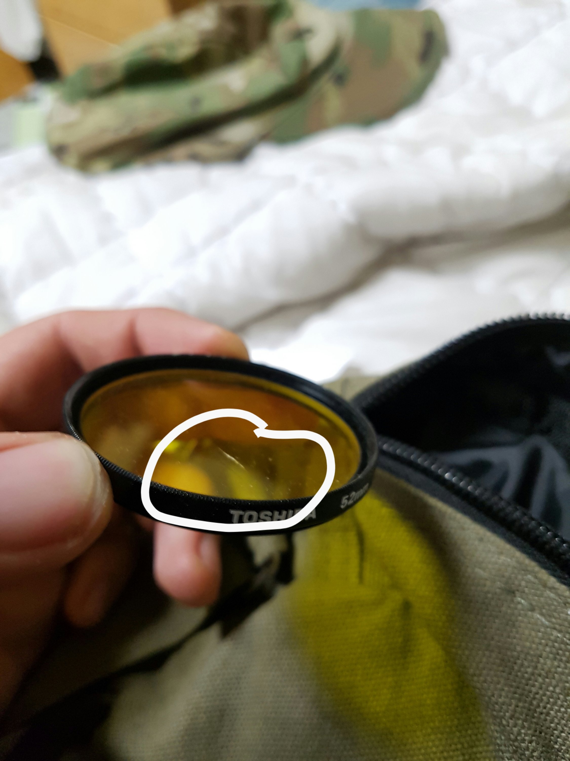

How bad will a scratch show up on my end product? I'm shooting a 50mm 1.4 with a Nikon FE.
I had been exploring some abandonments in Seoul, I knocked my brand new y2 filter along the corner of a brick wall while climbing a balcony, and ended up shooting 3 rolls of kentmere 400 before I realized it had a pretty deep scratch on the filter, about 15mm long.
It's impossible to really see, but I'm still using the stock K focusing screen, so it's hard to see anything anyways.
What do ya'll think? And Is there any place to bulk order cheap filters? I feel like I'll probably burn through a lot of them with what I'm doing.

It will add flare, so in conditions where flare is a problem, it will accentuate that problem.
Mostly though, it will reduce the re-sale value for the filter.

Paint the scratch over and any problem (if actually of visible effect in the photograph at all) will vanish.

Hood?? If so, probably no noticeable effect.

Back in the early days of photograph scratches, nicks, or dings in the glass were painted with black paint or India ink or similar that was available. Paint only the scratch not the surrounding undamaged surface.
Scratches on the rear are more likely to show up in the photo than ones in the front unless the scratches in the front are severe.

I would use a very fine point black Sharpie.

Throw that filter away! I wish I still had a very well written article from the "Shutterbug" magazine in the 1980's. It confirmed what I thought all along. Using filters unless for special effects or color correction can be detrimental to image quality. They introduce flair and other unwanted aberrations. The best lens protector is a metal shade. Of course in your case you probably wanted to darken the sky for more dramatic effects. Nikon lenses have very good coatings (the newer ones), if you want to get the most from your lenses buy top of the line filters and if you scratch one, throw it away unless it's a diffuser.

From the picture of the damaged filter, I would guess that you might notice the scratch in a final image taken with a 50mm if you were shooting at f16 or 22, focused close, shooting subject matter conducive to showing up flare or loss of resolution, and looking specifically for signs of the flaw under magnification. It would also be more obvious if you used it on a wide angle lens. At least that has been my experience with such things.
So I don't think you need to lose sleep over the rolls you've already shot, but you might take a couple frames at the most extreme settings you're likely to use (small aperture, etc) just to be sure it's not an issue.

My guess is that painted or not it will produce a visible smudge which will become more prominent the farther down you stop. The trick of painting the scratch is great, but that would be for a scratch on the lens itself. A lens gets no focus at all on it's own surface. You may be right about the rear being worse. But the filter is different. Being in front of the lens, it will show.
