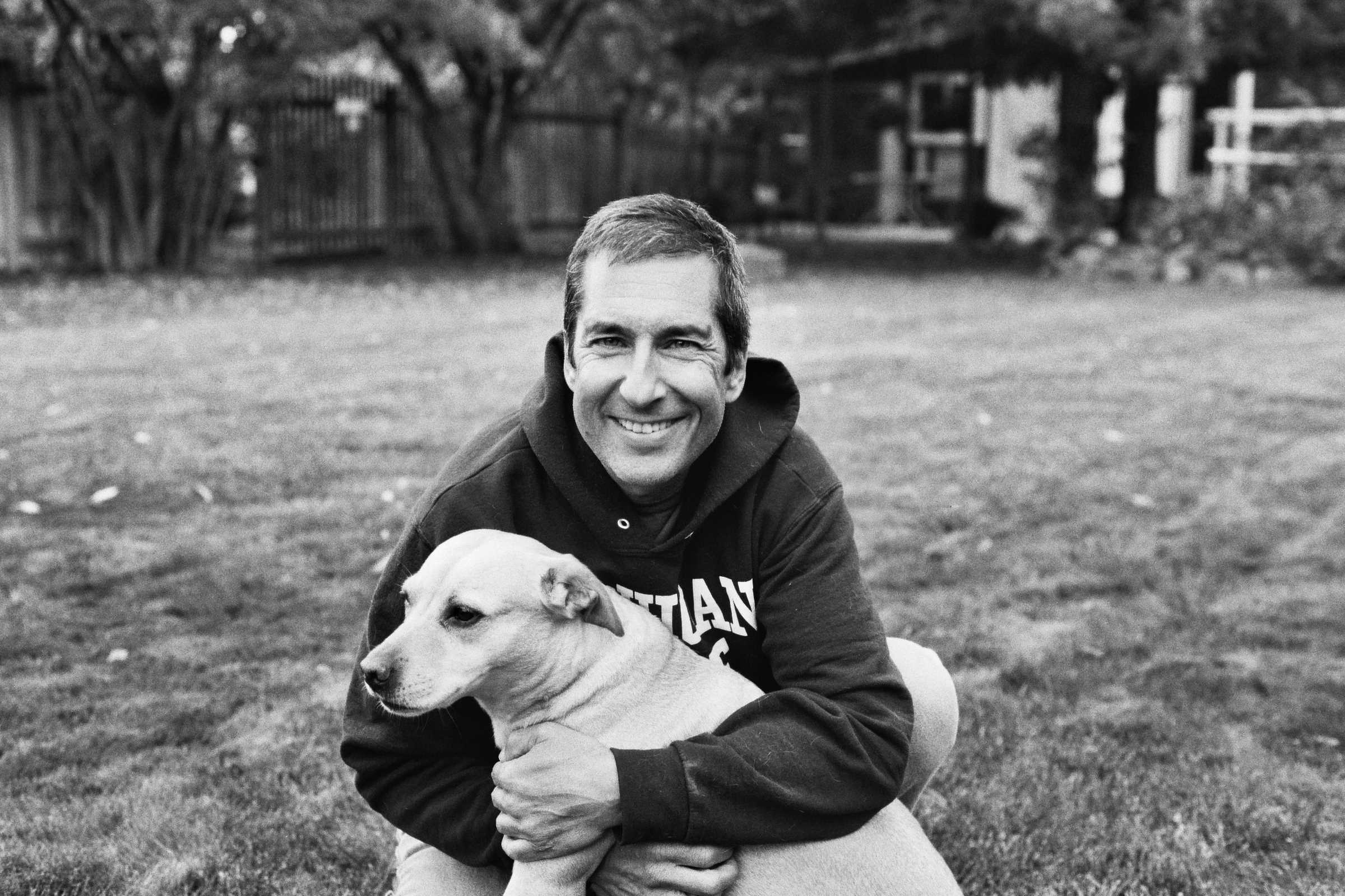

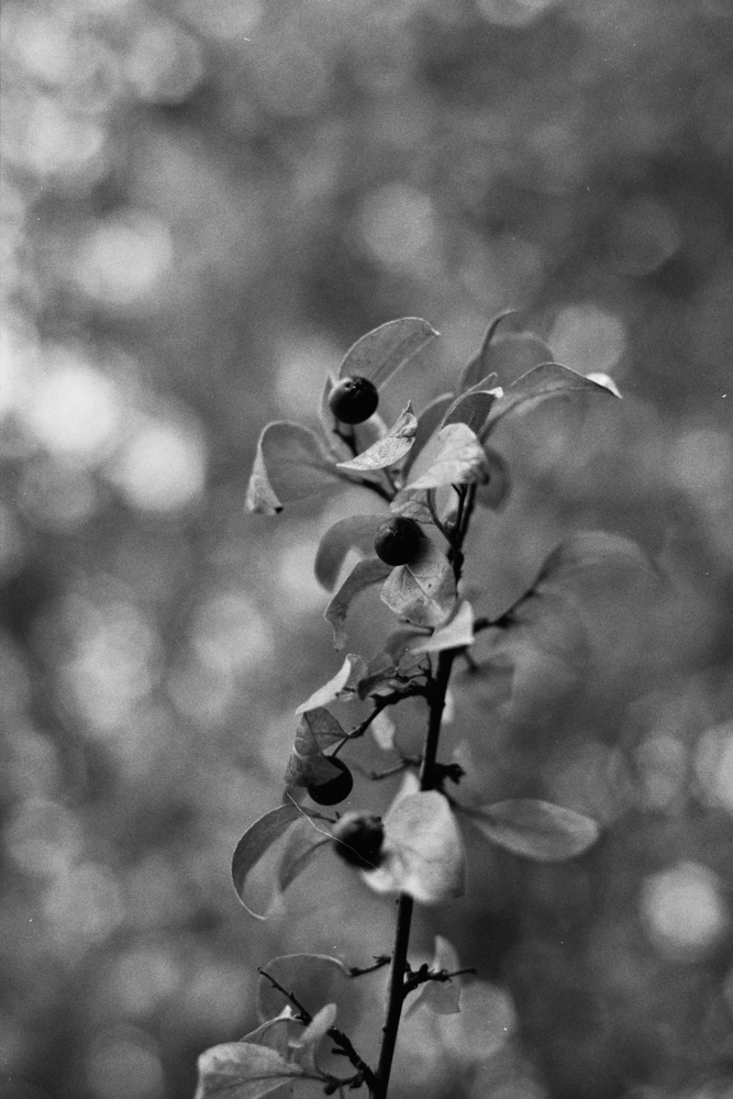

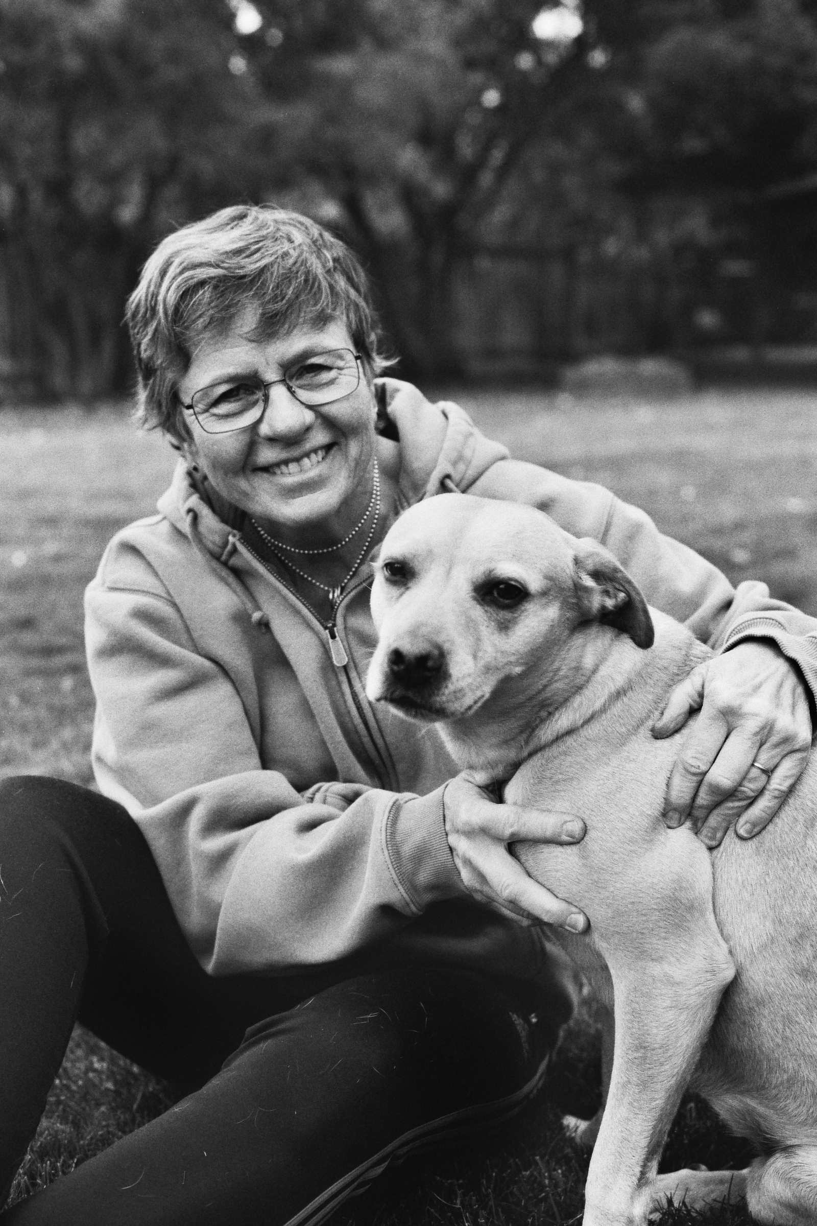

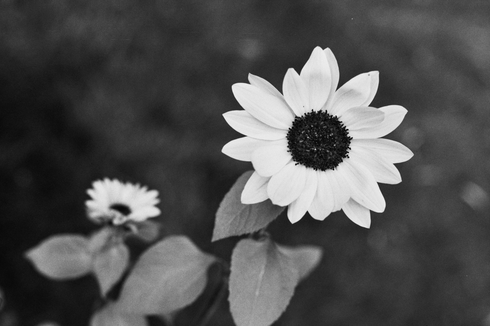

Hello, I just shot my first roll of film in 25 years...from a Nikon FE. Black and White, Arista EDU Ultra 200 ISO. I had it developed and scanned locally and several of the shots have either horizontal scratches, small "hairs" or hair-like dust, or other dust spots on them. I'm attaching a couple of samples. I just got the camera on eBay and I am just wondering if there is a problem with the camera, the developing, the scanning, the photographer (certainly possible!), or what.
The first has a small s-shaped hair on the bottom left corner.
The second has horizontal scrapes near the top.
The third has little dust spots everywhere.
The fourth has what looks like a watermark in the upper right and a horizontal scrape about 2/3 of the way down.
Any thoughts? Thanks.
The horizontal lines across the negative can come from:
  • dirt on the film transport in the camera
  • damaged film rollers or film pressure plates in the camera
  • dirt of the 35mm cassette
  • dirt from the bulk loader door [not a contender in this case]
  • dirt or burr on the processing equipment
I vote for a dirty camera. That should be easy to check. The 'watermark' is from the processing of the film...might come out in a wash.
The scratches are not on all the images, which is a good sign. Perhaps a little dirt/grit that got pulled across with the film, rather than a damaged pressure plate or rollers.
Scanning black and white film reveals more dust and dirt than you would think possible!
With most colour film, the labs can use aggressive, IR based technology that hides dust and imperfections (and often a fair bit of sharpness). That technology isn't available for black and white.
Some labs are better at handling film then others (leading to less dust and dirt) but there would still be some from even the best labs.
You need to learn how to use the clone tool in your software, or deal with a lab that offers that service as well.

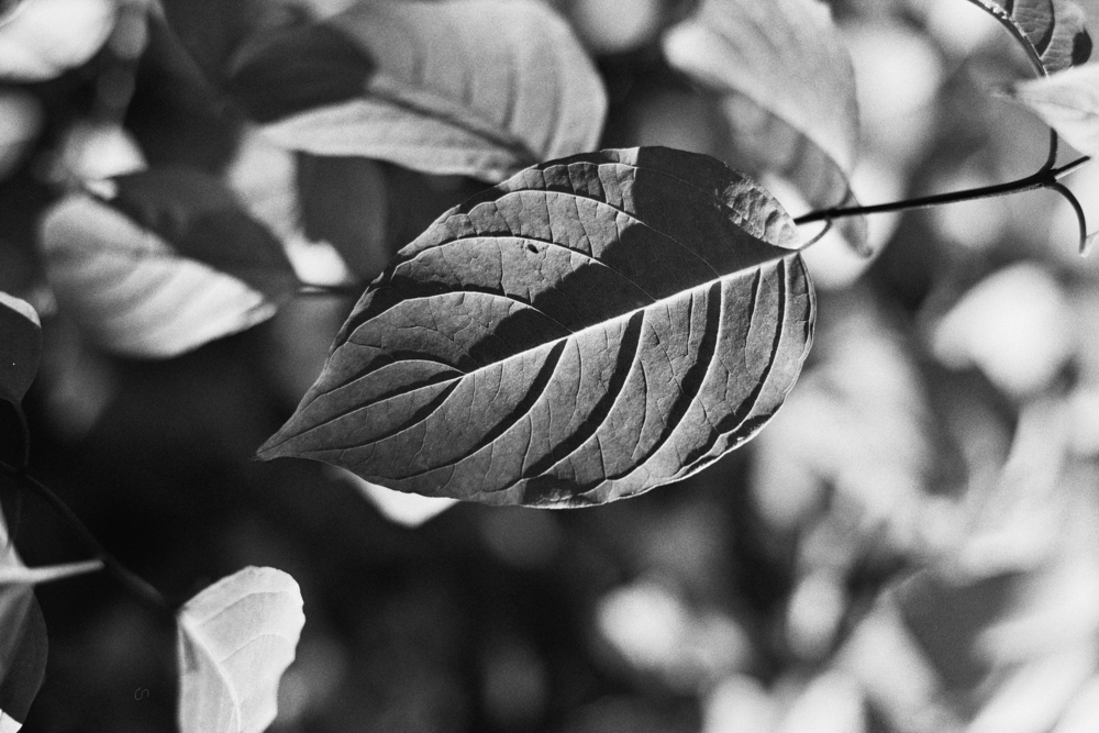

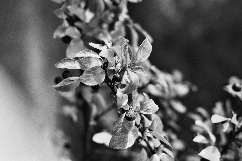

Here's my favorite pics from the first roll. The certainly look more 3-d and less flat than my usual digital images, for some reason I could never explain.
