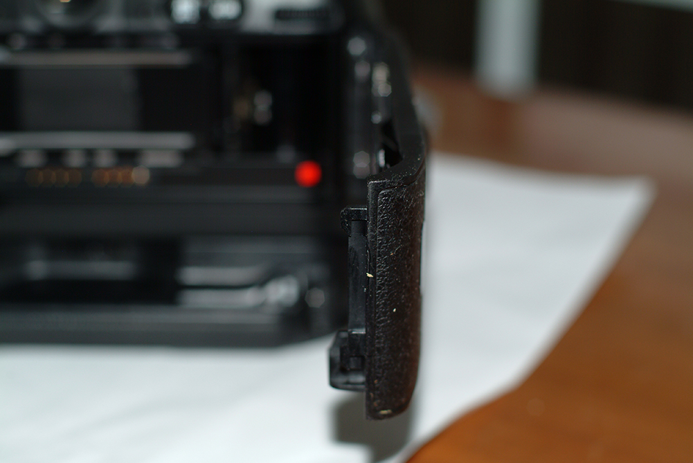

So, when the latch breaks, where does this occur? On the door itself, where the prongs are?
The two small hooks on the back's edge break off completely or get partly fractured.
I read somewhere (don't remember where now...) that nikon was offering a repair at some point (yes, repair, not replacement with another back). It would be possible to file away the two hooks and then machine metallic replacements that you will glue or drill on yourself. It could be an interesting modification if you are inclined to invest time on it.

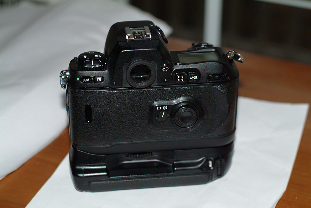

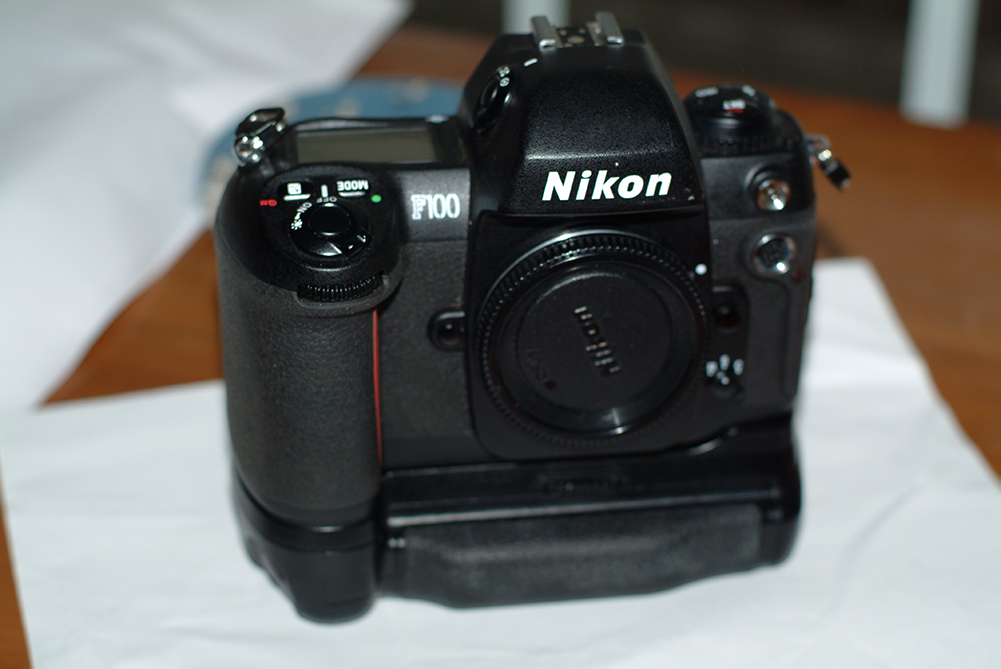

So, the F100 arrived in excellent condition, with a slightly sticky back. Sorry the latch photo is blurred. No signs of cracks. :D
