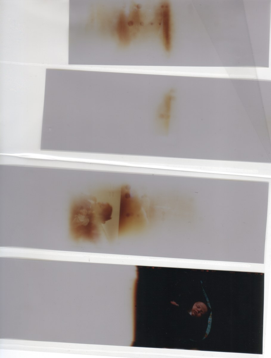

Hey Peeps!!
Help! I'm not sure what the hell I've done and I'm hoping you guys can help me.
Correct me if I'm wrong, but a film accidentally exposed to light would fog it, and in a severe case, make the whole film a fairly solid black? Well, check out the attached, which is a flatbed scan of my "exposures". As you can see, one has been "correctly exposed", 2 or 3 have very slight images that are barely visible of my 3 year old daughter and the rest look like they've not been exposed to light at all...either in the camera or out of it?
Has my slight unrolling of the film caused this or have I not used my Blad properly? I made sure the film was wound on for each shot and that the small screen had a white colour in it to avoid any double exposing.
Ideas please? I need to leanr what I am doing wrong!!

Oh, hang on...I've just realised - this is Fuji Provia 400X transparancy film, not negative film. So a solid white exposure on this is the equivalent of a solid black on a negative? Yes?
So the solid white shots are totally fogged and the few that came out with some degree of image are the one's that were perhaps sufficiently unfogged to produce some kind of partial image, allbeit unusable? Am I right?
You're totally correct. Light has really got into the roll quite badly. (And, in the top strip, you can, I think, see where the light has reflected on the numbers on the adjacent film backing paper). The sharp boundary on the lower strip between the clear base and the usable image seems to be where the centre of the roll was tightly rolled (was this one of the first images on the film, hence nearest the centre of the spool?).

That is some funny-looking fogging, with the first frame fine right up to the edges of the film, then a sharp cutoff from one good frame to the rest of the roll almost completely exposed.
Loose-roll fogging looks more like irregular blotching starting at the sides, and generally decreasing in severity towards the centre of the roll. I'd say that in addition to some damage from having a loose roll, all but one of the pictures were considerably overexposed to begin with, and you do say it's a new camera and you were shooting "just to get used to using my blad and light meter".

edp - I was thinking that myself. The film becoming a bit loose is one thing, but to see entire frames look like they've been unwound and held up to the window is another.
I'm worried it's something more serious with the camera or with me and how I've operated it so maybe it was getting exposed to light when just sat idle. I'm not sure? Maybe I need to just have another go and see what happens.
