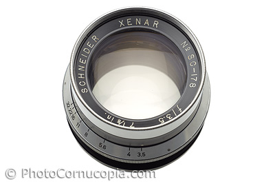

I bought a Schneider xenar 18cm f3,5 20 years ago, and i haven't used it before. It is in very good condition. They seem sought after because i saw a similar lens on ebay got more than 50 bids. It is very solid and heavey and the aperture has around 16? blades. According to the Serial no, it's from 1936.
Are this lenses just collectable or are they still good for lets say portrait? Also i dont have the retainer ring, any ideas on how to attach it to a lens board?
It's a very usable lens, see Ken Lee's website and his Tessar gallery, the Xenar is Schneiders equivalent. While a great Focal length for portaraits it would be fine for general use.
I assume it's in a Compound #3 shutter, they usually came with a mounting flange rather than a retaining ring, you may be able to find a flange on ebay.

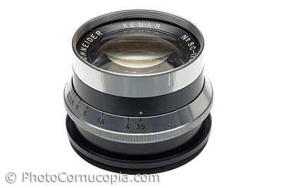

Here is a picture (not so good) :
i have blured the last serial no (every one else is doing so).
