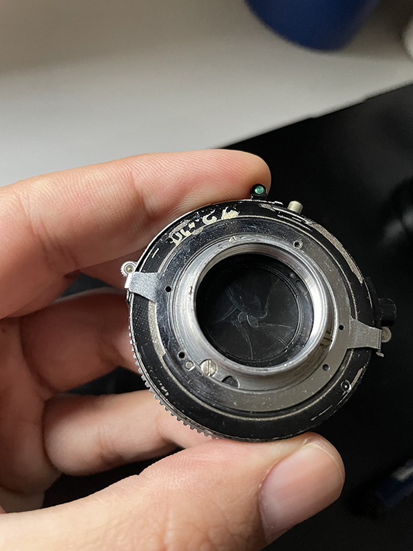

Hello Guys, I have a question, and the learning curve for large format lenses is too steep for me.
I bought this lens for usd$120; I plan to make a DIY 6x17 camera. Well, the problem is that the lens didn't have a retaining ring.
Looking at the image, I understand that the diameter for the copal, in my case, is M25 (25mm), or do I measure in the wrong diameter?
To capitalize:
Do I need an M25 retaining ring?
Like this one?
Is that diameter the correct one to measure the copal?
Thank you all!
Sebastian

This one is actually a Compur #00 shutter and you need a #00 ring. The M25 ring you linked from B&H is the correct size. There are other places to get one that might have it in stock or be less expensive (ebay, customphototools.com, etc).
Standard retaining ring sizes for Compur shutters are:
size mount thread
#00 M25.0-0.5
#0 M32.5-0.5
#1 M39-0.75
#3 M62-0.75
Copal 0,1,3, are the same as Compur 0,1,3. There are some exceptions like a "Copal 3S" that you don't need to worry about right now.

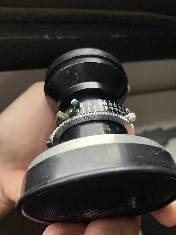

Hello Guys, quick question, the lens has three letters, X, M & V as you can see in the first picture. What is their function? for V position I can't move the lever to that position.
Thanks in advance!
MattKing
Apr 24, 2005
55,500
Delta, BC Canada
X and M are two different settings for flash synchronization - X for electronic flash, M for a particular type of flashbulb synchronization.
I believe V is flash synchronization used in conjunction with a self timer.
