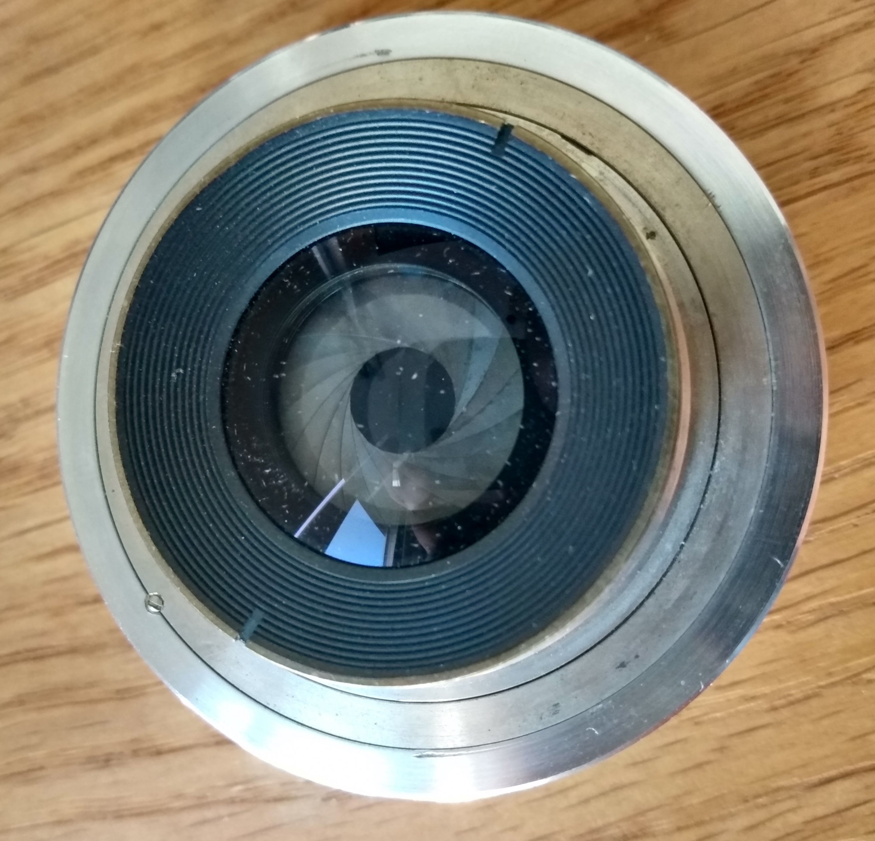

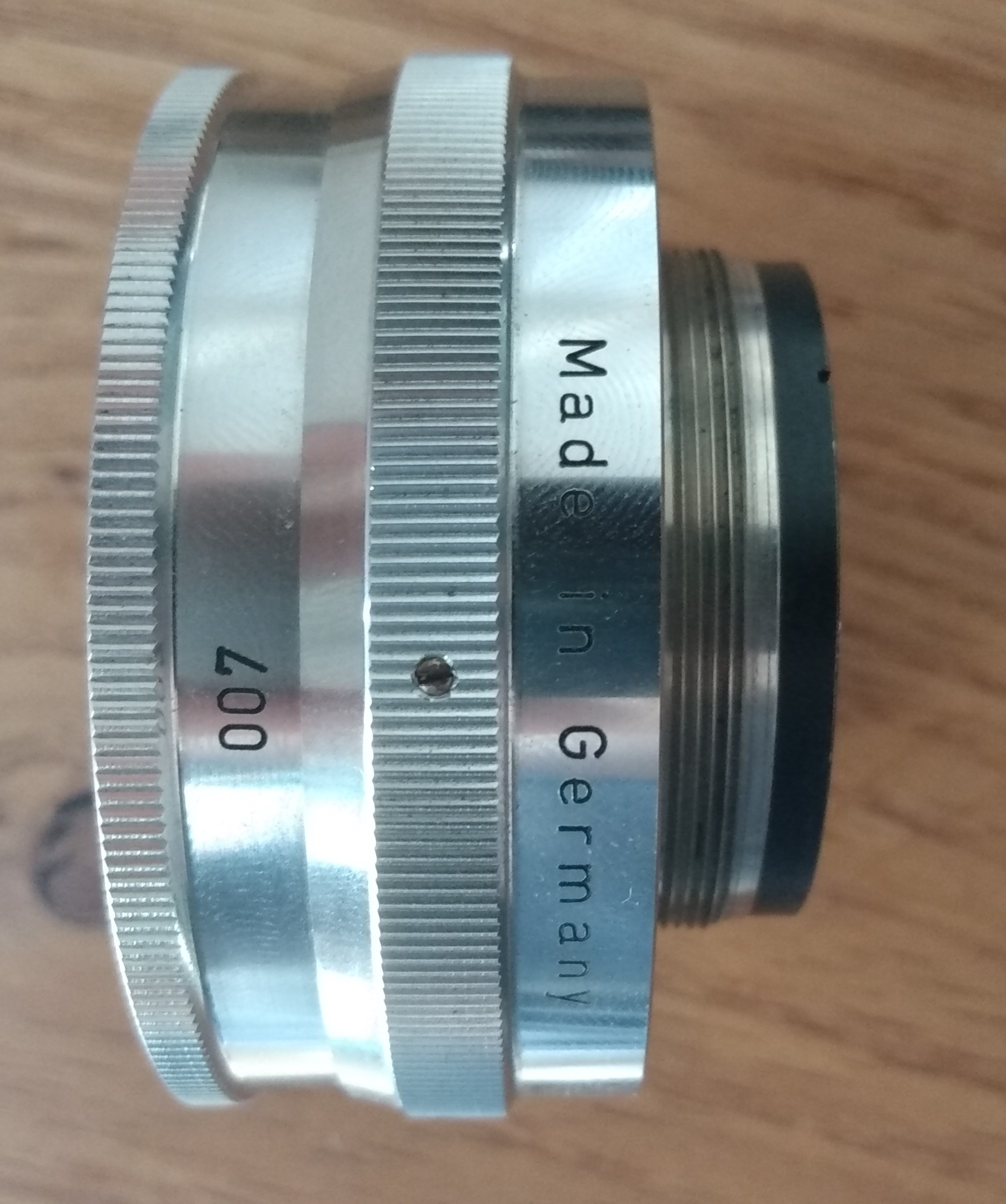

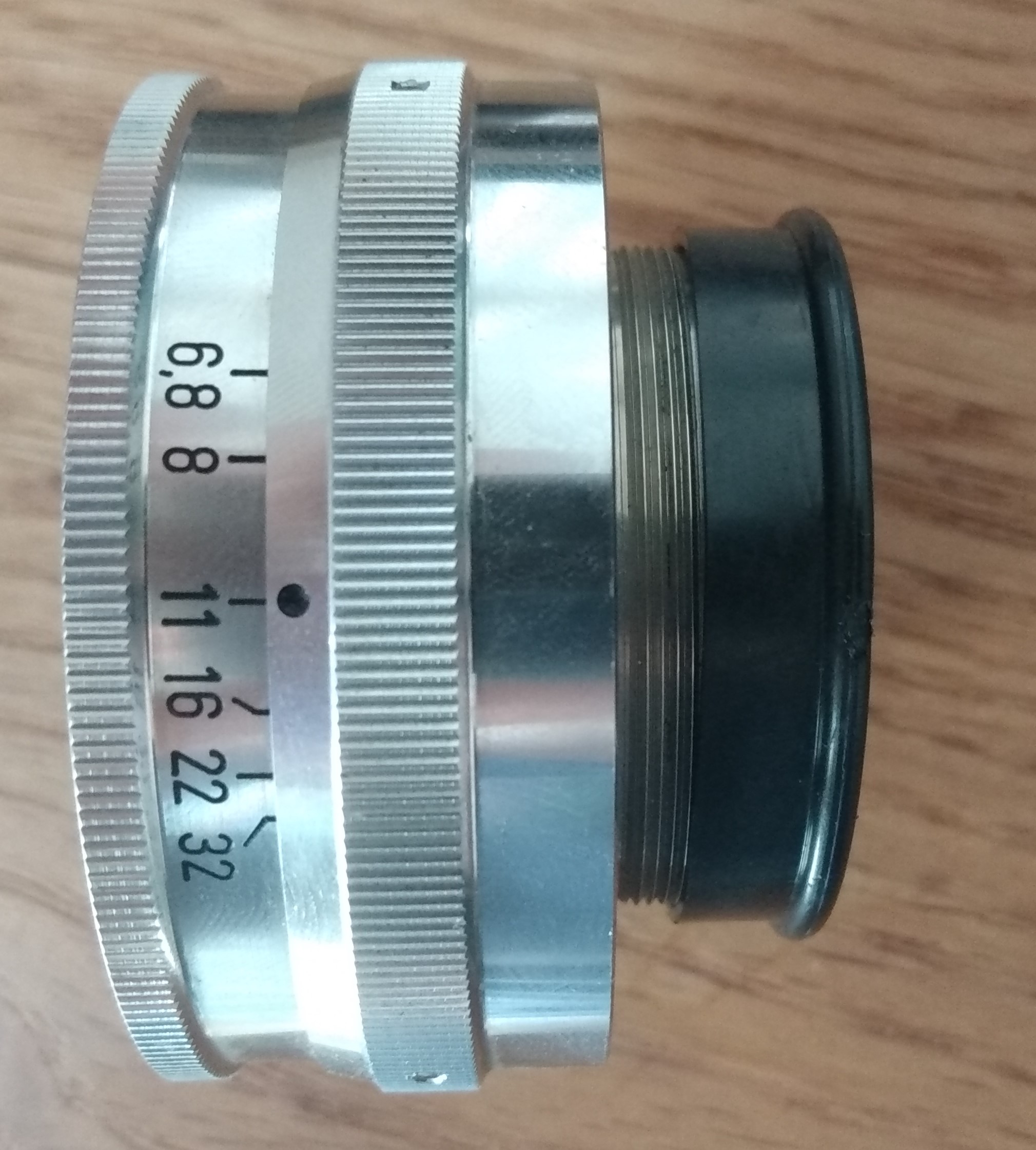

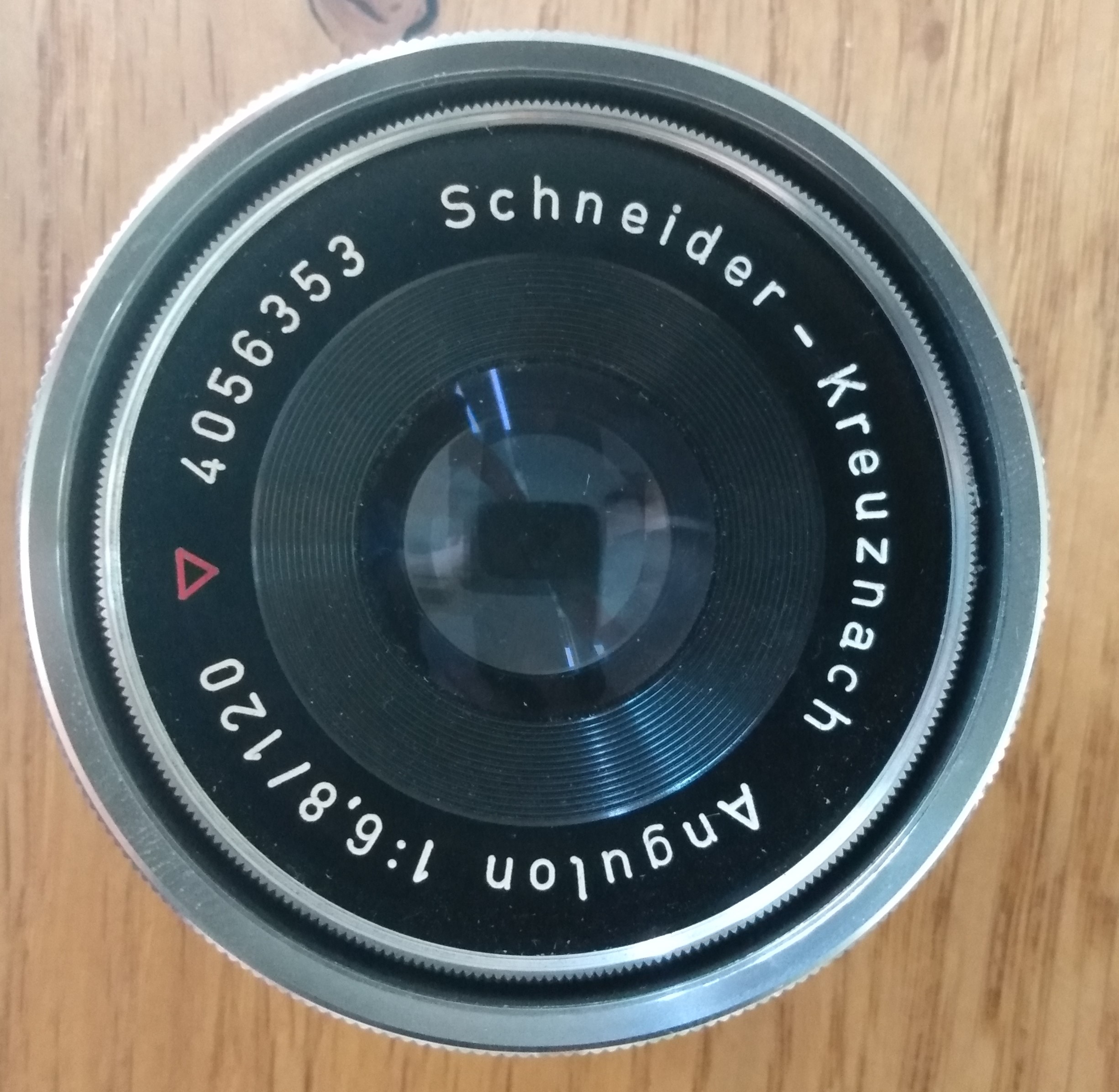

I recently got hold of a Schneider Kreuznach 120mm f/6.8 Angulon. The lens does not sit in a shutter, but rather some type of hosing with aperture control. I have never come across something like this, but I also must admit that I have very little experience with LF lenses. Could someone shine some light on what exactly this is, and how I can safely remove the lens from the housing to install it in a shutter?

It's just mounted in barrel. I'd send it to a machinist like SKG to mount it in barrel as it is probably not a direct fit to a modern shutter.

The optical blocks should unscrew and go straight into a Copal/ Compur #1 shutter. The mount threads are the same as a Compur/ Copal #1. It's a standard factory barrel mount, same as contemporary Componons etc. If you're using a Sinar or Packard shutter, the barrel mount is fine.

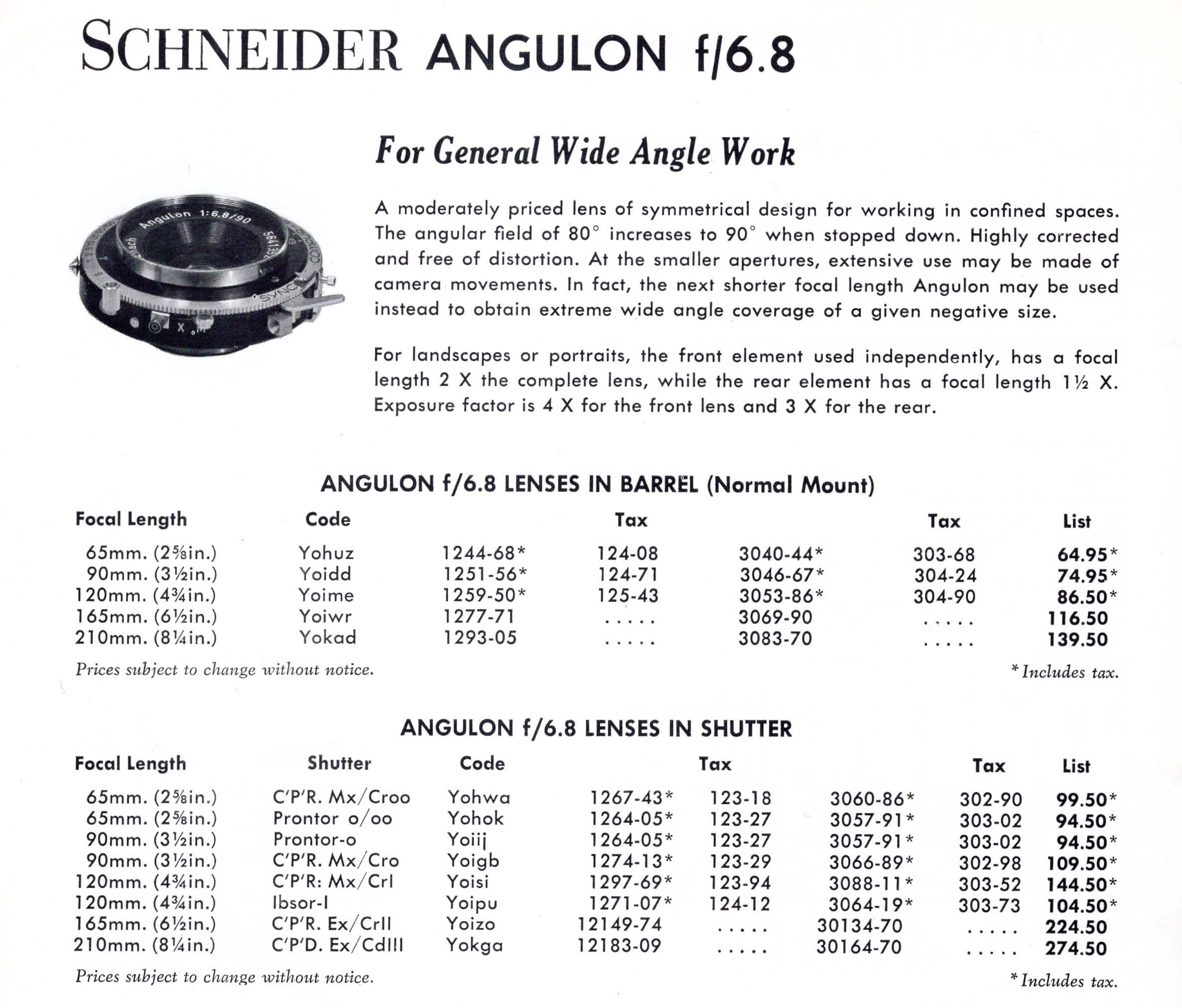

They were sold like that as well as in shutters, mine is in an Ibsor shutter (with flash sync), it's a WA lens for a 7x5/13x18 camera. It may well be the shortest FL you could use on a 5x4 SLR like a Mentor.
As Lachlan says it'll fit any European or Japanese #1 shutter, Prontor, Ibsor, Compur, Seiko, Copal etc. It dates from 1954 there were cameras with Focal plane shutters, or optional Focal plane shutters that could be fitted, not sure if Linhof made one but MPP did for their MicroTechnical 5x4 cameras, and I have a couple for wood and brass cameras.

I tried to unscrew the optics, without any luck. The rear element is removable, but beyond that I can't seem to get any further.

Why I send mine to SKG. He recently mounted a 305 G-Claron that I could not get the front cell off onto a Compur 2 shutter and made the aperture scale for the shutter.
Not sure the German translation but in English they call it a 'barrel.'

This lens is a Dagor design, the f6.8 aperture is a quick give-away. I have Angulons (all of them in barrel and shutter) from the 65mm to the 210mm. Quite sharp in the center and many like how it rolls off at the edges. I really enjoy using my Angulons, they are generally underrated. In barrel mount they can be rather inexpensive.

@kahlheins : I trust Dan Fromm for his knowledge, but my first thought was that your lens is a enlarger lens, or a process lens.
I have a Componon 135 (I think) of exactly the same type.
Thanks for the kind words.
The OP's Angulon is a taking lens, not an enlarging lens. As was pointed out in post #13 above -- thanks for posting it, ic -- Schneider offered jes' plain Angulons in barrel as well as in shutter.
