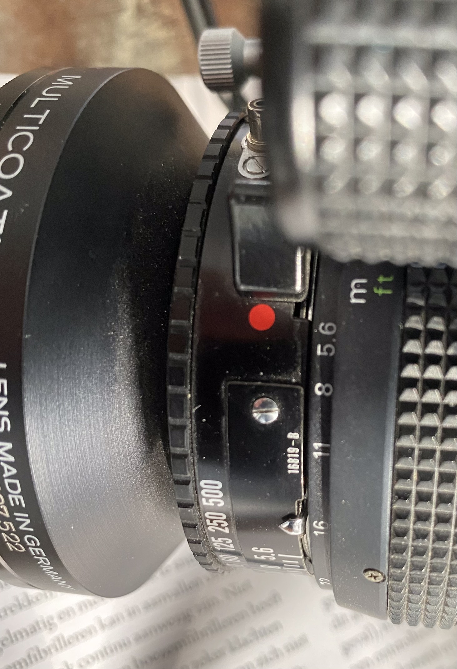

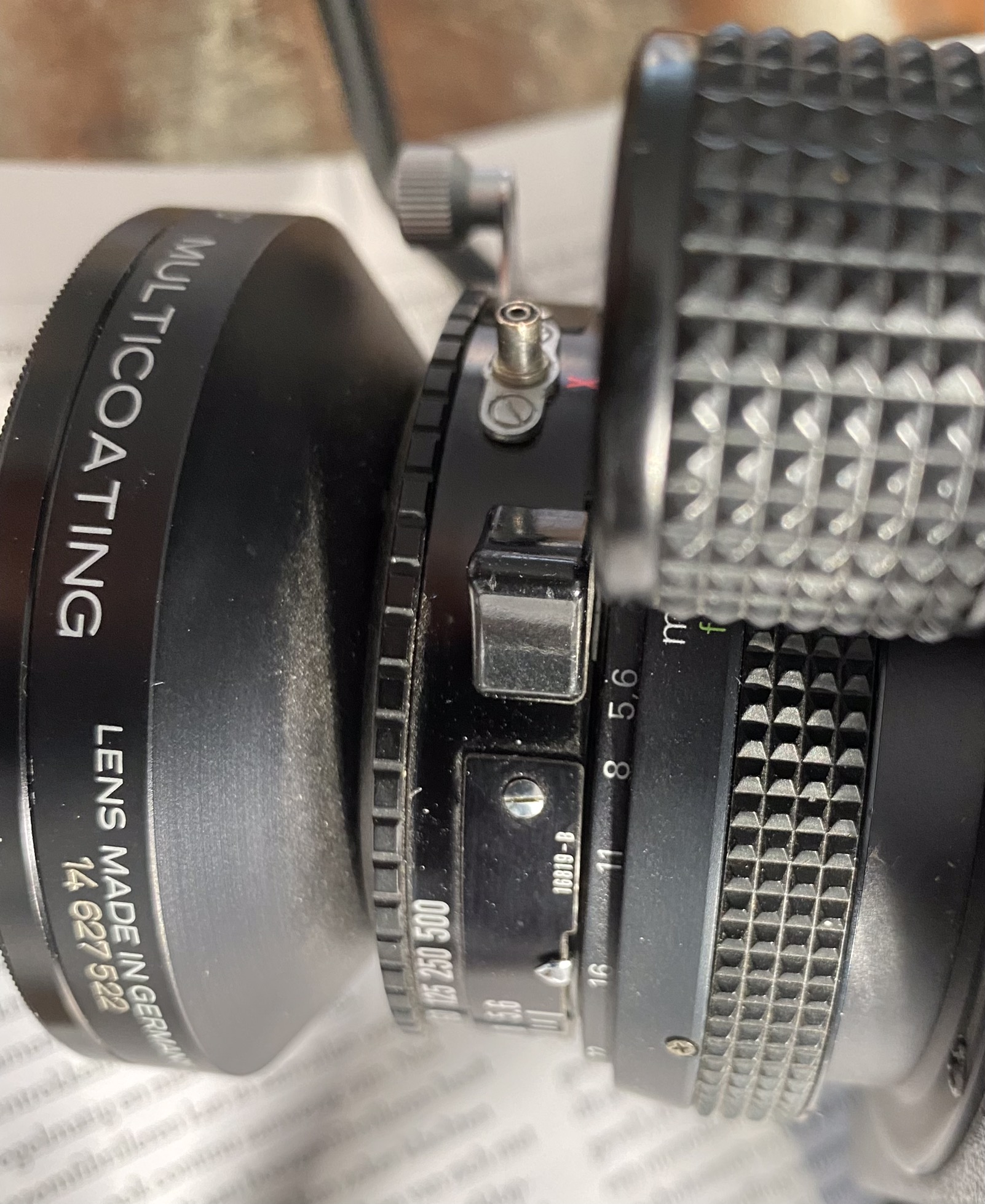

I got myself a Cambo Wide 58 with this lens. Received the camera yesterday and tested everything. Everything fine, all times sound ok.
Today I had another look and now, no matter what time I set, it always uses T and only closes when I tighten the shutter again. What do I do wrong and what is the function of the black knob (thought it was fot setting T, but don’t know now.
The triangular button is to open the shutter for focusing, previewing, etc. When the red dot is seen, it means the shutter is open. As long as the shutter is open, it can be cocked, but not released. If you are able to release the shutter, it means there is something wrong.
To confirm, move the button to close the shutter - the red dot should not be seen. Cock the shutter and release it to see if it opens for the duration you set on the speed dial. Check each speed multiple times.

All times work fine, the black knob for opening and closing works fine, but as soon as you set the time scale to B or T and open the shutter, you can’t go back to the other times. It takes a lot of fiddling with settings (can’t find out what exactly does the job) to get back to normal functioning. So I guess it needs servicing in the near future, but it works for now.
Are you changing the shutter settings AFTER you've cocked the shutter?
I don't wish to sound difficult, but I suppose you know how to operate the lens in the b & t positions?
A lever or levers are sticking when you use B or T. Exercising the shutter may get them to free up.
What shutter, Synchro Compur or Copal?
It’s Copal 0 and I exercised the shutter a lot at all times. According to the seller, the camera/lens has not been used for at least 8 years, so I suppose some cleaning might help anyway. I send it out for servicing in januari and use it carefully until that time.

Well, what I do know about ie a Hasselblad, that the first thing you do after taking a picture, is transporting the film and cocking the shutter. After that you can take another picture, change exposure, change lenses, change backs etc. This does not harm the Compur shutter at all. Same with the Rolleiflex tlr. I’ve been doing that for the last 50 years and it’s still in great shape. With LF it’s a bit different, because you use T to look through the lens, but as it is the same type of shutter, changing time after cocking the shutter should not be a problem, but as mentioned above, changing to T with a cocked shitter might cause the problem I had.
Hasselblad and Mamiya RB/RZ shutters are deigned to be cocked for storage/lens change. The Synchro Compur shutters used in Rolleiflex/Rolleicord TLR's from the 1950's onward cocking mechanism does not put pressure on the speed adjustment or the delay timer. Rollei says to set the 1/500 before cocking the shutter.
The shutters used in these cameras are a modified version of a standard shutter. All shutters from a given manufacturer are a variation on a theme. Different sizes are scaled up/down copies of the standard shutter.
Your Copal should be good to change speeds from 1 second to 1/500 cocked but the shutter should be released before using B or T. Try to confirm

You don't use the T setting for focusing, that's what that nifty lever (with the red dot) is for. That's a fancy modern shutter.
Thanks all for your input.
So changing settings while the shutter is cocked, is ok for most mf lenses, but not for large format. And use the little black lever for opening the shutter only when the shutter is released (this might be what I did wrong). Everything is working fine now, made some test shots yesterday. Still think having the shutter checked and cleaned after not being used for so long is not a bad idea.
