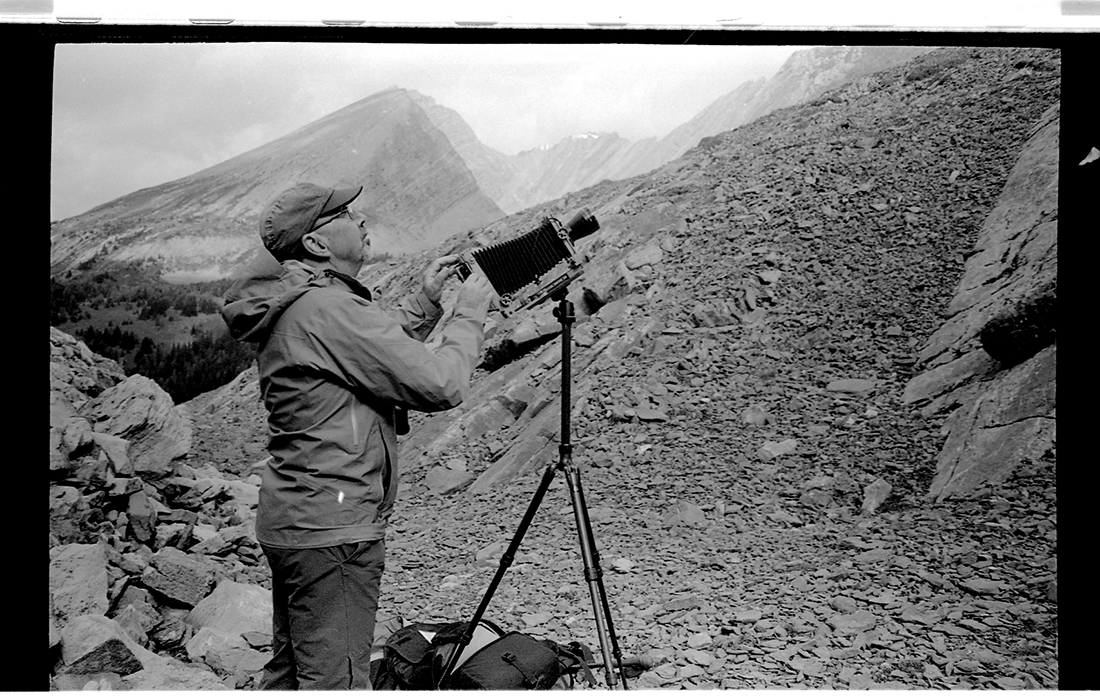

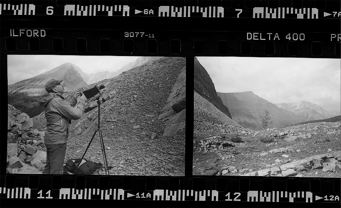

Here are two scan I just made of some 35mm Delta 400 negs. One is the sheet of negs in plastic sleeve that are laid on the glass. The second is a scan of just one neg in a the Epson film holder. Both are sharp as far as I'm considered. I didn't fuss with either one, no sharpening only levels. The camera used was a Olympus AX probably set at f8.
