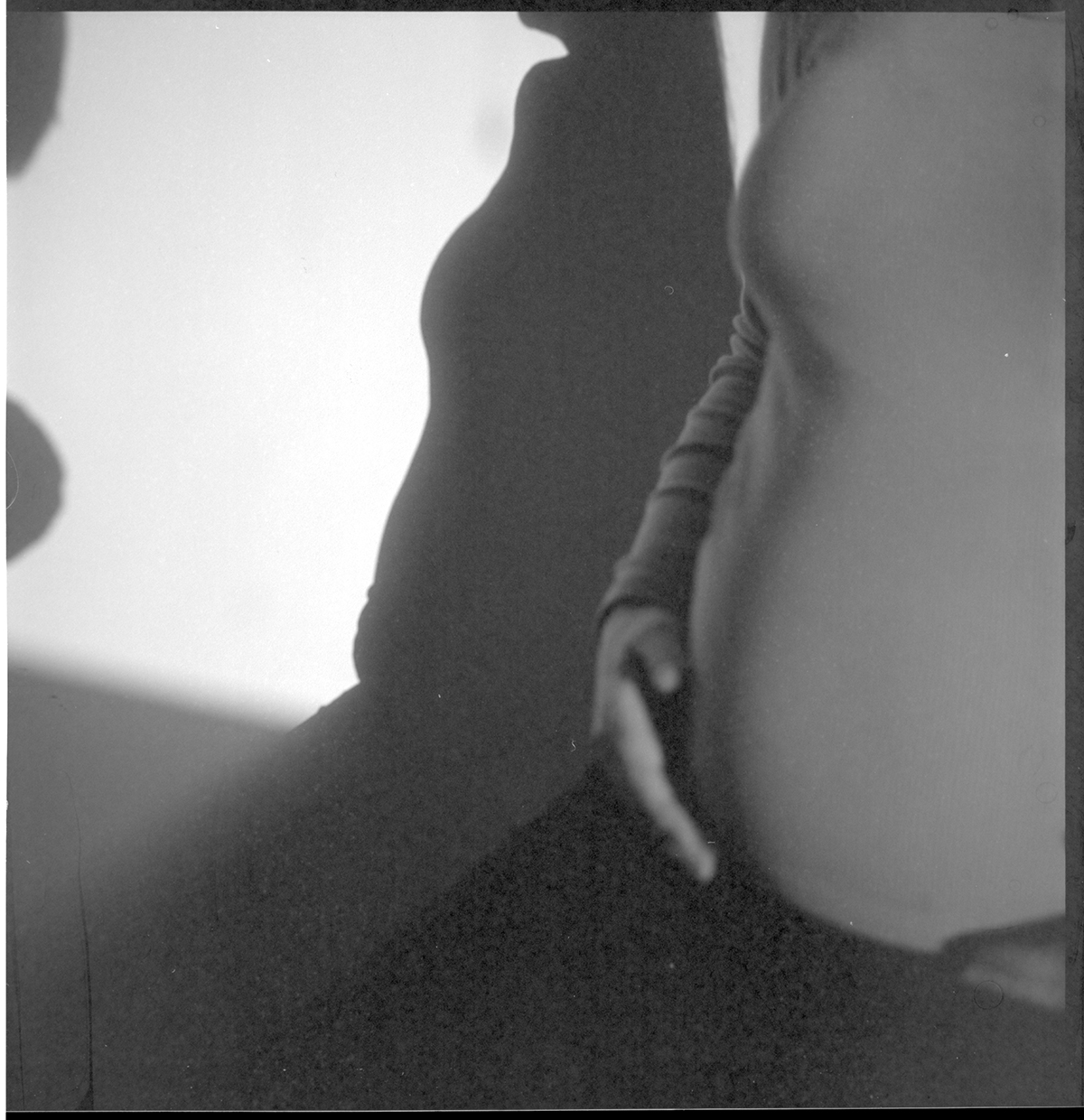

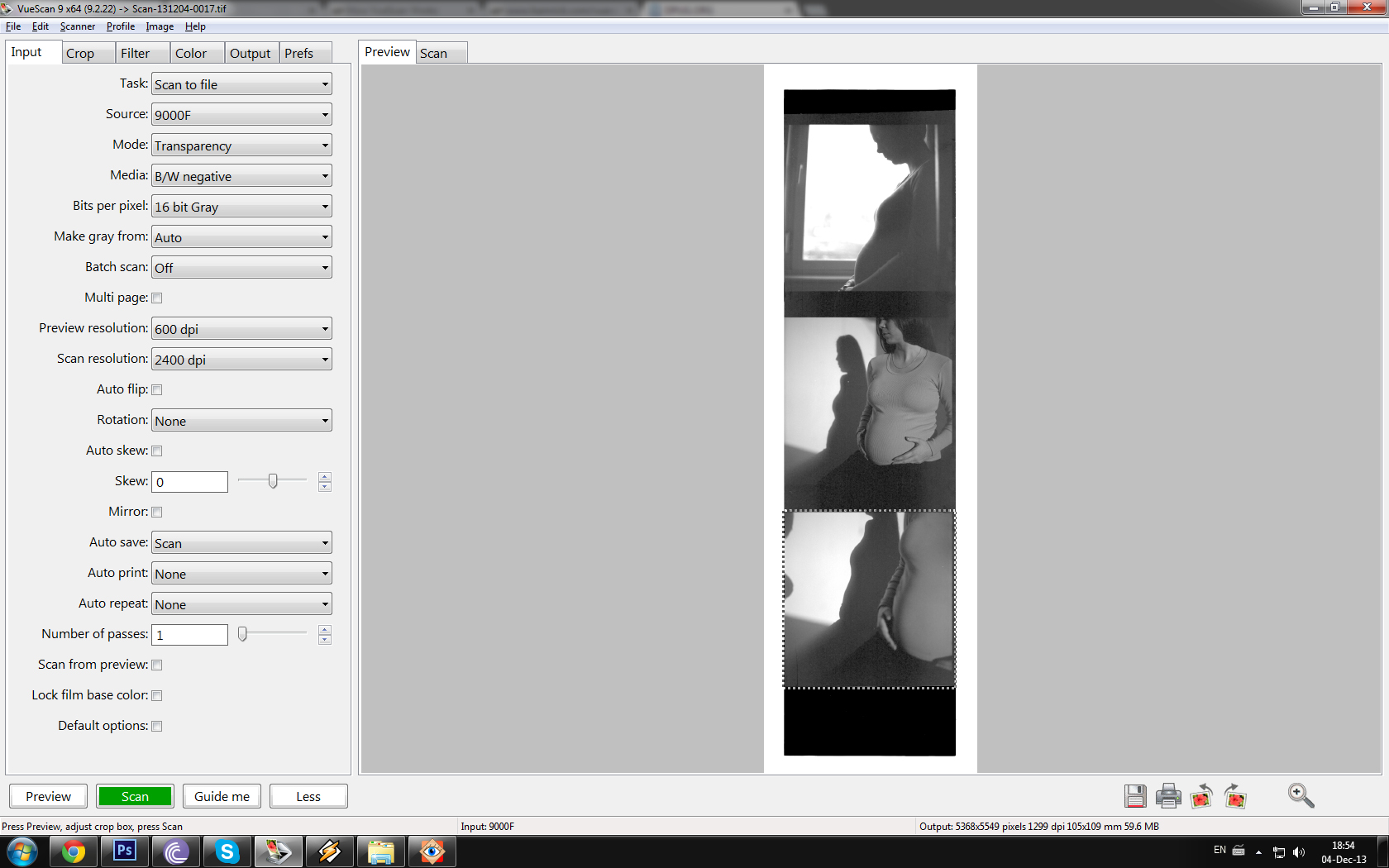

I am using VueScan and Canon CanoScan 9000f and alongside all my troubles with scanning I have this shadow problem on every scan that has deep shadows, they all look like this. A lot of time is needed for this to be corrected in PS so I need to know what is it that I am doing wrong so I can get as clear scan as possible. I'm attaching a screenshot of my VueScan settings and the unedited scan.
Thank you in advance for the help.
Boris

It looks like you are underexposing your negatives. There doesn't appear to be any density difference between the shadow areas and the film borders (assuming the black area on the right of the detail scan is film border). If you set the black point based on the film border it will hide the noise in the shadows, while also mostly obscuring the minimal details you have there.

OK, so I tried that one a moment ago, it seems that VueScan has a mind of its own and does not work in team with mine. :smile:
Scanned one frame with blacks set to 0% and the next one to maximum of 11% and literally with no changes...
Thanks for the help.

You need to set the white and black points and possibly modify the tonal curve. Look at Image->Graph b/w
and Image->Graph curve.

Also you can go to the color tab and use manual then tweak the black point slider so that the areas you want black appear black. White point works the same way for white. If you have the graph b/w showing you will see the pointer movement on the tone curve histogram corresponding to your selection.

While you can certainly make the settings in Vuescan, I prefer to do all the adjustments in Photoshop. It's a lot easier to use a levels or curves layer to adjust the black and white points. Simply being able to visualize the clipping with the option key as you adjust the levels is very powerful. It saves needing to rescan because something got clipped. But if you've mastered the Vuescan interface it can certainly be done there as well. Neither necessarily gives better results.

Looking at the pattern on the negative strip (first image) I'm inclined to suspect a negative processing issue.
Have you looked carefully at the negative on a light table with a loupe?
